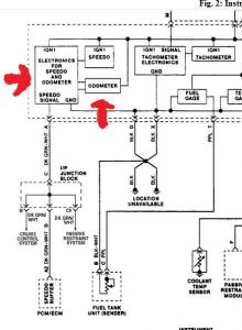

I have not been able to get my odometer to work in my car. I have done quite alot of work to keep this car running as it is my "toy" and don't drive it too often. A while back the odometer stopped working and I checked all the fuses with a tester and they all work. I have even replaced the instrument cluster and everything works except the odometer, oh and the tripometer also. What could it be? Also, i'm installing an aftermarket radio that has a gps in it, so it requires me to connect a wire to a "car speed signal input". Where could I find such a wire. A friend told me most cars have a sensor for that by the transmission. Is that true? Thank you

The VSS sends it's signal to the PCM (computer) which sends a signal to the speedometer and odometer stepper motor ..
SPEEDOMETER
The speedometer indicates vehicle speed. The PCM controls the speedometer. A high-to-low edge of square wave signal is received by speedometer drive integrated circuit and produces pulses that are sent to speedometer drive coil. The integrated circuit also counts input pulses to drive odometer stepper motor.
Hope this helps

Oh ok I see what your saying. But if the sensor was bad wouldn't it affect the speedometer as well? My my speedometer and rpm work fine. Its just my odometer and tripometer. Thank you for your patience and help.

When you say you replaced the instrument cluster .. was it NEW .. or used or recon ?
If the speedometer is working and it is showing correct speed etc. then I would say the VSS is working correctly and the stepper motor in the cluster is the fault !!

Yeah, they were used. I ve actually replaced it twice with two used clusters, and everytime everything works except the odometer and tripometer. Weird huh? Ok, i'll try another cluster. Could just be really bad luck with used clusters. Thank you for your help. I appreciate it.

I does seem you are being very unlucky !! .. I have checked the TSB's (tech service bulletns) and there are none regarding the cluster or odometer failing ? and there are none regarding the VSS .. so it seems it must be the cluster .. I do not have any test procedures just for the odometer, my manual states to test the speedo or replace the cluster only ...

I am having the same problem. Changed the cluster once already and still, It didn't work. Also, my cruise control, speedometer, and RPM gauges work fine. Read on another site that there is a gear in the Odometer that is known to fail in these. Not sure how true it is. My mechanic is stumped too, though he has not checked the wires to the Odometer.

If you have a pre 1995 saturn the odometer gears break and need to be replaced the grease used when the cluster was built damaged the gear causing them to fail. Your on the the right track though the odometergears. Com has the gears and the instructions on how to change them. They say to replace the small and large one the large one is the one that always breaks.I repaired my sisters odometer on here 1993 I only replaced the large gear and its been over a year and still works great.
