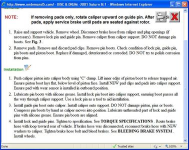

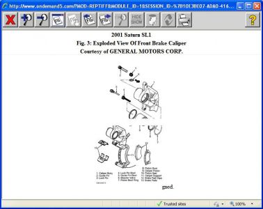

i would like to know how to remove a caliper off of the car above.
Saturday, July 10th, 2010 AT 10:04 PM
SATURNTECH9
MECHANIC
30,869 POSTS
There you go.
