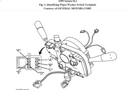

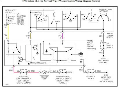

Used a test light, grounded to Battery,
Yellow-Power
Black- ground
Purple- Intermittent
pink and brown??
switch on to high or low, only the yellow showed power, unable to get test light to turn on??
But on intermittent,touchuing purple the light woudl glow and pulsethe wipers would be running, the wipers thne would stop for the rest part of the cycle, if I touched the purple with the test light grounded the cycle ( no power being added) would start instantly then run as supposed to to. Maybe stop maybe not stop as supposed to.
If the I did this with swtich on low, the wipers would jump up to Hi speed.
Doe shtis help any??

I meant to answer this last night, but was working on a few donor posts that I am required to answer first. Okay, the pink and brown have to do with the washer system. Lets go after the symptom of the wiper not turn off when the switch is in the off position. Solve one symptom at a time....probably will all be related.
https://images.2carpros.com/forum/automotive_pictures/30961_saturn_1.jpg

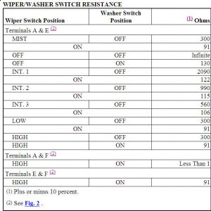

This starts off with continuity checks....not sure why the brown wire is mentioned in this, but so be it. The switch is tested after the continuity checks as follows.
https://images.2carpros.com/forum/automotive_pictures/30961_saturn1_1.jpg
https://images.2carpros.com/forum/automotive_pictures/30961_saturn2_1.jpg

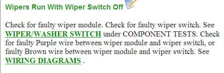

IF the switch tests good that leaves the motor...actually microprocessor that is part of the motor.
https://images.2carpros.com/forum/automotive_pictures/30961_saturn3_1.jpg
