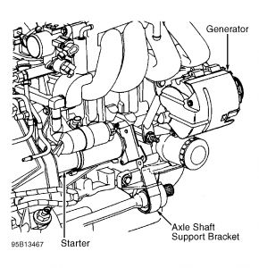

I posted earlier today about my 1999 Saturn not starting. I believe I have found the problem. After several hours of searching the internet and trying out different things my neighbor suggested tapping on the starter. I did not think it was the starter because we have not had any trouble starting it. The starter is very hard to get to but I was able to tap on it lightly with a long file that I have. Lo and behold it started right up. I was able to start it up 4 times in a row.
Has anyone ever changed a starter in a 1999 Saturn SL? It looks like it is very hard to do. Any tips would be appreciated

STARTER -1999 Saturn SL2 Page 1 of 1 STARTER Removal & Installation Disconnect negative battery cable. Raise and support vehicle. Disconnect starter electrical connectors and lay wires aside. Remove starter-to-engine block bolts. Pull starter rearward, toward left side of vehicle and remove starter. See Fig. 1 . To install, reverse removal procedure. Tighten starter-to-engine block bolts to 27 ft. lbs. (37 N.m). Fig. 1: Locating Starter Courtesy of GENERAL MOTORS CORP. 10/21/2008
