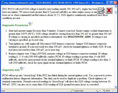

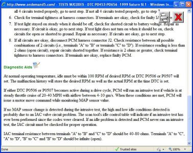

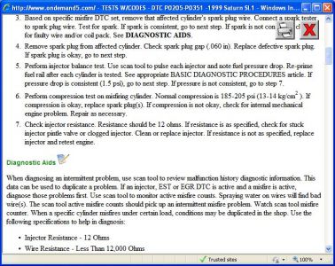

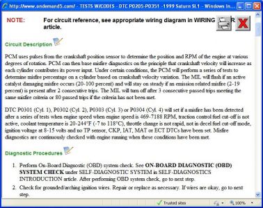

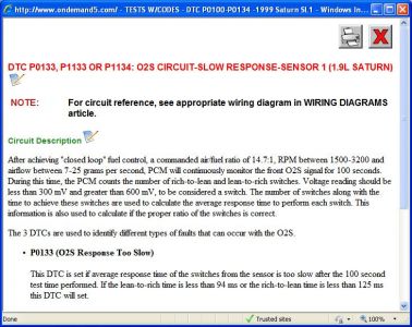

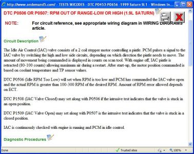

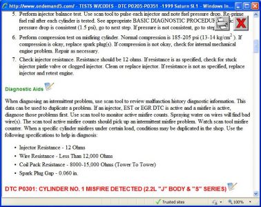

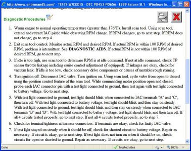

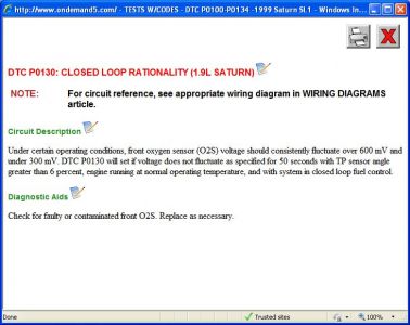

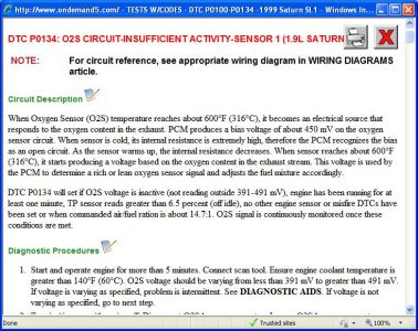

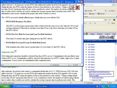

Still no change. The codes areP1133 (switch ratio from rich to lean and lean to rich was below determined number), P0301 (misfire cylinder #1), P0134 (Oxygen sensor defective, engine misfire), P0130 (same as P0134), andP0507 (IAC, throttle body, vacuum leak), high idle. The small hose that goes from the intake manifold to the pcv valve on my SL1 single cam is straight. Could that be the wrong hose? Thanks!

having a straight hose to your pcv is fine as long as the hose is in good shape.its looking more like a vaccuum leak with the codes u have i would start by fixing the high idle and clear the codes and see which if any come back.since u have a code p0301 cylinder 1 missifire i would spray carb around the intake gasket of the number 1 intake tube where the intake meets the head.that would be located right by the power steering pump.also try tapping lightly on your idle air control valve its right on your throttle looks like a little motor and see if ur idle comes down.also on the p0301 trouble tree the spark plug gap is listed at .060" gap is really .040".let me know what u find.
