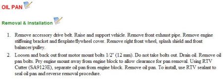

Pls help me tell me the procedures on how to replace my saturn car's oil pan

Hello
Below are instructions..
