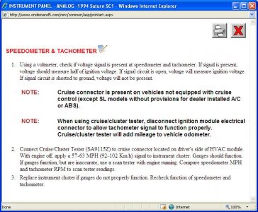

https://www.2carpros.com/forum/automotive_pictures/416332_1994_SC1_speedo_test_1.jpg
It's beginning to look like you have a bad speedometer.Try what i posted and emailed you by checking that A terminal at about 60 mph for voltage it should read half of battery voltage.You don't have the cruise cluster tester so you will have to improvise by spinning the tire's at about 60 mph with the tire's safely off the ground.They are selling one of those cruise cluster tester's on ebay though.

I measured the voltage while the wheels where spinning at what I think would be around 60. It said to be about 7
Wednesday, October 6th, 2010 AT 5:11 PM
SATURNTECH9
  • 30,869 POSTS
It's looking like the speedometer the trouble tree say's half of battery voltage and 7 volt's is about half when the car is at 60 mph. But you said it got to only 30 mph when you jumped it from the seat belt relay. Try jump it from the ecm to speedometer instead of it going thru the fuse box that way you will know your problem is from the ecm to or thru the fuse box.
