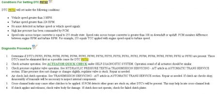

I have a 1998 Saturn SL2 with a automatic transmission, 4 cyl engine and 123,000 miles. The service engine light came on and it shows a code of
P0732 gear 2 ratio. Could I please receive info on troubleshooting. For example what troubleshooting task can I do and what part or parts are the most probable cause. Thanks

Most likely u need tranny rebuilt No 2nd gear that’s what I have on this code U can also find it @ mitcell1.com Good luck
https://images.2carpros.com/forum/automotive_pictures/99387_732_1.jpg
