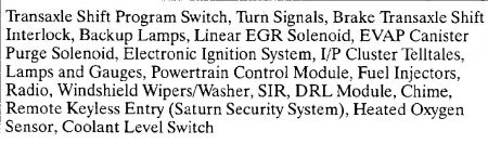

My saturn died the other day. Jumped it and it started right back up. Died again when I got home. Hooked a voltimeter up and am having issues. Battery post registers @ 3 volts. Disconnect the IP BATT (30a) fuse and it reads fine at 12 volts. What is this fuse too and how can I find the drain?

Here is the list of circuits:
https://images.2carpros.com/forum/automotive_pictures/30961_sat_1.jpg
Your going to have to isolate to find the problem. You'll need wiring diagrams most likley.

Start pulling fuses for the individual circuits servicewriter listed and see what gives.
Good hunting and let us know. :)
