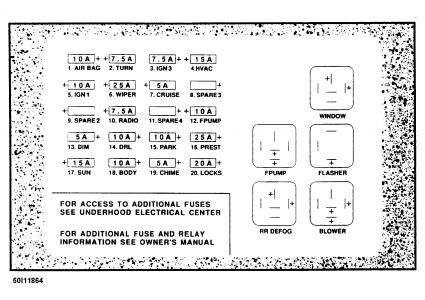

Hi there,
Check fuse number six first (25 Amp)
Mark (mhpautos)
https://www.2carpros.com/forum/automotive_pictures/61395_fuse_2.jpg

PIPPY
  • 18 POSTS
Where is the diagram for fuses located the one showed me is not under hood maybe driver side dashboard? Let me know exactly and is it easy to access.
