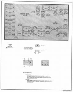

Background: Bought car not running. Past owner says that car would die when put into reverse. After third time into reverse car would no longer start.... Present known info: I have codes po601 and u2105. All fuses have been checked with a test light and ign. On. Fuel pump will not run unless relay is removed and a jumper wire installed. Crank and cam sensors have been checked and are ok. Car will start if someone cranks engine while another sprays carb. Cleaner into intake tube. Code 1780 showed up after that short run period. Pass lock seems to be ok because you can shift into gears after ign. On and releasing brake lock. Purchased a used ECM but would not help no start situation....A donation is acceptable upon receipt of a viable answer. Last answer given was much to general and really didn't help. Thanks

"""" Fuel pump will not run unless relay is removed and a jumper wire installed."""" 45psi while doing this... No psi when ign. Is on. No injector pulse while cranking. Only temporarily installed used ECM, the original is now back on. No I did not flash the used one.

You need to check and test the engine control fuse no.3, Main relay and fuel pump relay control circuit of the computer

Not sure which fuse you say is #3, but as I said been through all fuses visually and by test light, and all checked out

I've switched the fuel pump relay and the wiper relay with no results. . .Will check the main relay this weekend on Saturday.

I see that the main fuse box is not marked like the diagram, so yes, control fuse #3 is fine. I switched the main ign. Relay with the identical relay next to it with still no results... Didn't have a whole lot of time to commit to it this weekend so hoping that this week allows more time.

Going thru the circuitry if the relay is okay and fuel pump is okay when wired direct from battery-the computer fuel pump relay control is defective

Is that in the ECM or BCM?
Tuesday, September 28th, 2010 AT 10:17 PM
  • 75,992 POSTS
Its in the ECM
