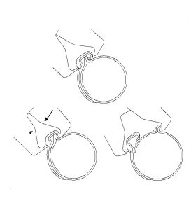

Geting to plugs a little difficult need to remove intake runners need clamp pliers see diagram
Plug Bosch FLR9LTE
Gap .040
Torque 18 ft.lbs.
