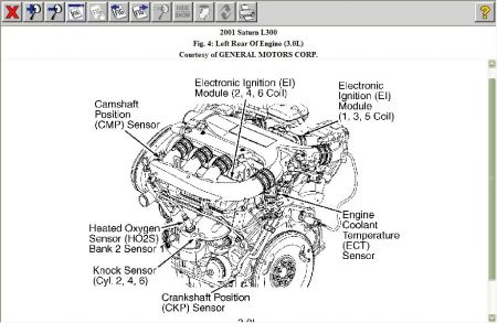

My vehicle dies while driving and doesnt start back up immedietley but after sitting for 15 minutes or so it starts again.A friend of mine said the exact same thing happened to him and it was the ignition control module.Ive taken it to 2 shops and they cant fiigure out what it is.I tried to find this part online to no avail.I have found ignition coils but no modules for a V6 engine. Is the ignition module a part on this vehicle or should the coil do it?Im on a tight buget and cant afford another diagnostic!Please help!Thanks

Sounds like you're having spark problems-check the cam and crankshaft sensors-see below
https://images.2carpros.com/forum/automotive_pictures/12900_camcranksensors_1.jpg
