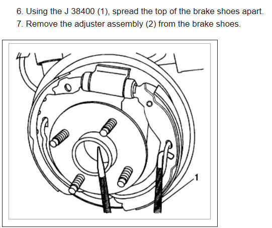

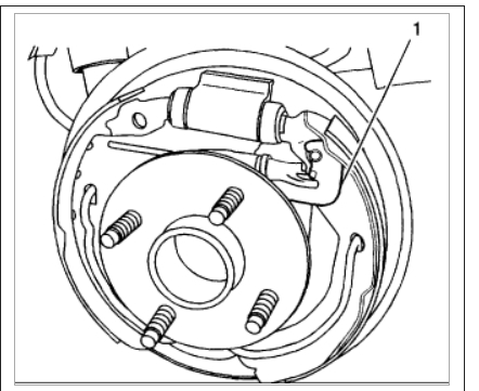

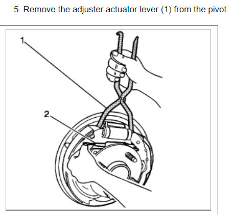

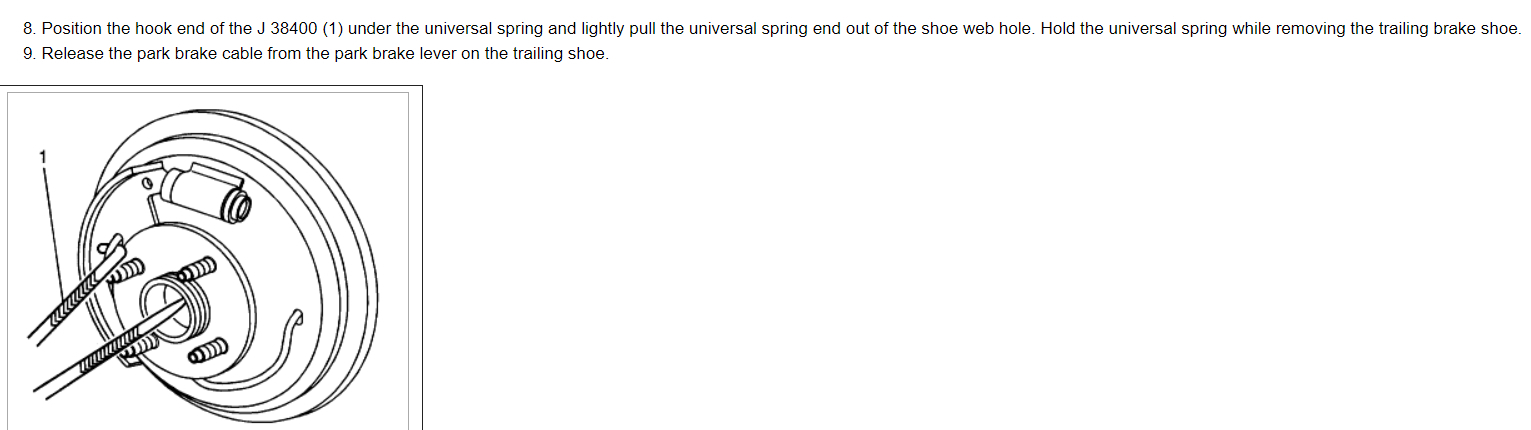

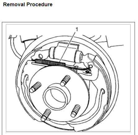

How do I get the e brake cable back in the brake shoe?
Wednesday, September 22nd, 2010 AT 8:18 PM
KEN L
  • MASTER CERTIFIED MECHANIC
  • 55,297 POSTS
Here are some guides to help us get the brake shoes back together which have a video of the job being done. Make sure the dented arm is not being jammed by the adjuster wheel.
