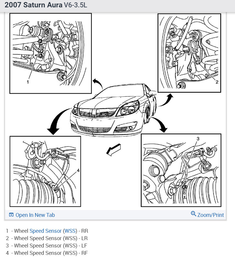

upon entering freeway on ramp, traction control system warning light came on. Temporary knocking sound. Light is still on, manual says it is related to brake system control?
Jul 10, 2010 at 8:20 AM
MMPRINCE4000
  • 8,548 POSTS
9 times out of 10 the problem is a wheel speed sensor that has gone out here is a video to show you how to get the codes so you can see which one the problem is.
https://youtu.be/rTtAnsOlZU4
if you want to test the sensors by hand this guide will work.
https://www.2carpros.com/articles/abs-wheel-speed-sensor-test
Check out the diagrams (Below). Please let us know what you find. We are interested to see what it is.

Thanks for this post I had this problem and had to replace the right front wheel speed sensor cost me $76.00 all fixed. I love this site.

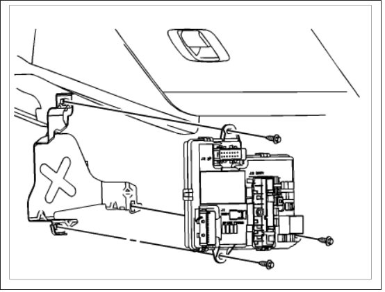

Car hesitates when driving, service traction light comes on and doors are unlocking and locking rapidly. Never know when it is going to happen. Supposed to take it to a repair shop when it does it again and to leave it running so that they can run a diagnostic on it. It only happens when they are closed, so far I have taken very good care of my car since I bought it brand new. Had the 100,000 mile service at around 95,000 miles.I don't want to go through what everyone else has gone through with multiple trips and lengthy stays in the shop to no solution. I work full time and take care of my mother who is entering the late stages of ALS. She depends on my and I really need my car. Please help.

This sounds like you have a BCM that is out and needs to be replaced. Here is the location of the unit you will need to have the unit programmed tot he car by a shop.

Yep that was it, costs me $550.00 though. This site rocks! I will tell a freind
