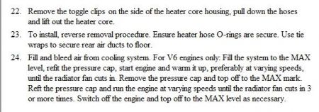

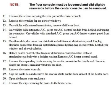

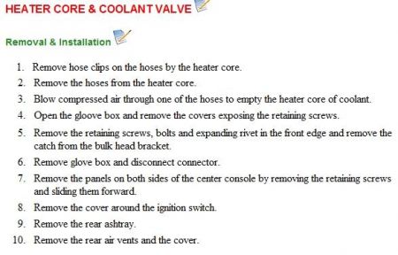

Diagrams on heater coil replacement or repair
