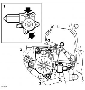

Driver side window was stuck half way up and when you would push the button to raise or lower the window you would hear a grinding sound.
I was able to get the door panel apart, and found the problem, the wires that are used to raise and lower the window had come off of the pulley.
I was able to get the window back up, but can't seem to get the pulley re-strung correctly to allow the window to function. I can't a manual anywhere on how this should be done correctly.

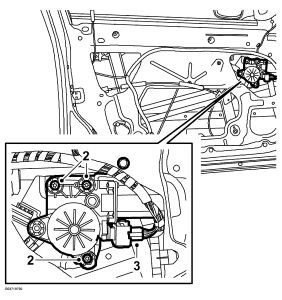

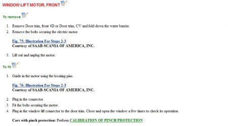

Hi there,
I have not a lot to offer as yet, here is what i have come across, i will keep looking and i hope that i came find something better for you.
Mark (mhpautos)

HATALLAM
Hi Mark,
Thanks for this information. I can get the motor out OK. However the wires that lift the window that I'm having problems with. Is there a diagram that shows how they attach to the window and how they are to be strung on the pulley that the motor connects to?
