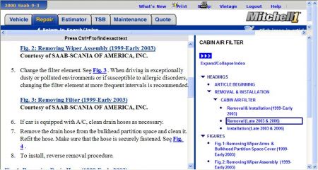

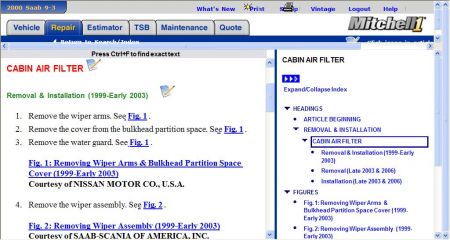

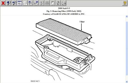

Good afternoon, simple question I hope. Could you tell me the location of the cabin air filter for this make/model of car? Thanks in advance!

Here you go hope it cools a lot better
https://www.2carpros.com/forum/automotive_pictures/12900_cabin_filter_2.jpg
https://www.2carpros.com/forum/automotive_pictures/12900_cf1_7.jpg
https://www.2carpros.com/forum/automotive_pictures/12900_cf2_8.jpg
