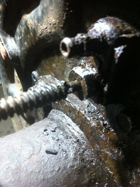

I was changing a leaking driver side rear brake cylinder and I am not able to get the flare nut out of the cylinder. It is rusted out an I tried allot of penetrating fluid an heat. Using vice grips an a line wrench. What do you suggest? Change that part of the line?Thanks.

This will actually be pretty easy, but I am not going to tell you how I would handle this until you promise me you will wash off all the penetrating oil with brake parts cleaner. Using that is the number one way this can turn into a real expensive repair that could exceed the value of the truck.
If any hint of petroleum product makes it into the brake fluid, the entire hydraulic system will become contaminated, and that will soften and destroy all the rubber parts that contact the brake fluid. The only proper repair for that is to remove every part that contains rubber that contacts the brake fluid, flush and dry the steel lines, then install all new rubber parts. That includes wheel cylinders, calipers, master cylinder, three or four rubber flex hoses, combination valve assembly, bladder seal under the reservoir cap, and if used, the height-sensing proportioning valve. Those are usually found on pickup trucks and minivans. If you have anti-lock brakes, the four-wheel hydraulic controller must be replaced. If you have rear-wheel ABS, the dump valve assembly must be replaced. If any rubber part is overlooked, the contamination will leach out of it and recontaminate the new brake fluid.
Most brake system specialists will not even allow things like power steering fluid, engine oil, transmission fluid, or axle grease near their jobs. We even wash our hands before handling the seals for caliper and wheel cylinder rebuild kits to prevent getting fingerprint grease on them.
Now that you have been properly warned, do not even waste your valuable time trying to solve the nut problem. Even if you do get it loose in the wheel cylinder, it will be rusted to the line, and the line will twist off. Do you really want to reinstall that nut? Cut the line right next to the wheel cylinder only if that is necessary to get the wheel cylinder off. Cut the line on its other end where it most likely is attached to the brass block at the end of the rubber flex hose. That will be on top of or next to the rear axle's center section. Cut that line real close, because the next step is to pound on a six-point socket. Line nuts are very soft. They will deform easily to allow the socket to be driven on. If all you have is a 12-point socket, stop right there and find a 6-point. No sense making more frustration for yourself. Even if the truck is real rusty, this nut will come loose very easily because it is screwed into brass.
Replace the entire line, along with the new wheel cylinder. Pre-manufactured lines are very inexpensive. Get one that is only slightly longer than it has to be, then put some gentle bends in it to take up the extra length. Avoid bending in a high spot where air can be trapped.

Thank you for including the photos. I overlooked them the first time. You can see the line right next to the nut is badly rusted and is going to break. There is absolutely no way the nut will ever spin on that line again without leaking. The only thing you could hope to do is get the nut loose, then rotate the wheel cylinder to unscrew it from the nut. Most of the time you have to twist the cylinder as you rotate it, and that too will crack the rusty line. Just throw on the new line and wheel cylinder, then buzz off into the sunset.
For one more comment of great value, pop off one of the dust boots from the old wheel cylinder, then let one of the pistons and lip seals spring out. Look on the inside of the lip seal and you will see the diameter is molded on to it. Read that and verify the new wheel cylinder you bought is the same diameter. The diameter is carefully selected at the factory to provide balanced braking, front-to-rear, for the truck's weight and weight distribution during braking. Common diameters are 13/16", 7/8", and 15/16". Be sure you are installing the same size that you removed.

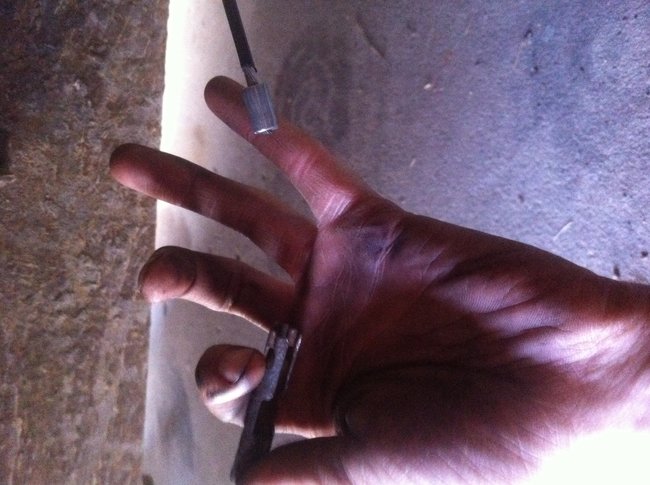

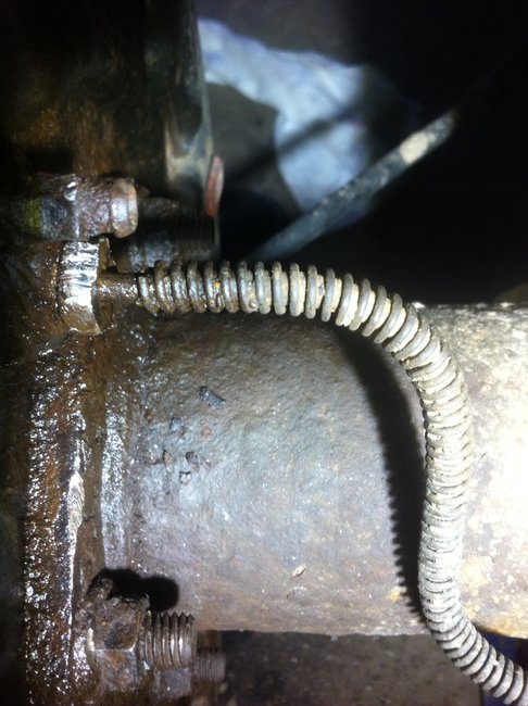

I got the brake line issue fixed now I am on the parking brake issue. So I ran the cable but on the drivers side were they connect the cable is a little short but the auto store says it's the right one. Not sure how it could be. Unless I am doing something wrong?Here is a pic.I tried pulling it an it goes no further.

CARADIODOC
  • 34,491 POSTS
What solved the leaking line?
I believe the connector is on the cable that goes to the front main cable. Sometimes there's a hook hanging from the frame or cross member to hold the cable, and there are multiple holes in the frame. Check if there is a different hole that hook can be moved to.
If you replaced the rear cable(s), be sure the casings are snapped into their fully-seated positions.
The most common thing I run into when the cable is too short is the parking brake pedal dropped down and is in the partially-applied position. Have a helper pull the release handle, then tug on the cable. I bet that will get you the few extra inches you need.

ITISME201411
  • 33 POSTS
Well I tried having someone pull the release handle an I tugged but the cable didn't move. Do you think I should replace that?Possibly bad?
Wednesday, April 14th, 2021 AT 1:50 PM
CARADIODOC
  • 34,491 POSTS
Have your helper hold the release handle up, then pump the parking brake pedal up and down while you pull back on the cable. You should observe the cable going in and out easily. If it does not, it is rusted in the applied position. Do not try to fix it or lubricate for that as it WILL act up again at the most inopportune time. The only proper repair for a rusted cable is to replace it.
