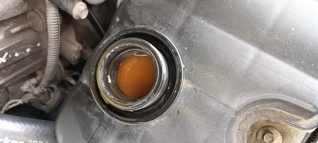

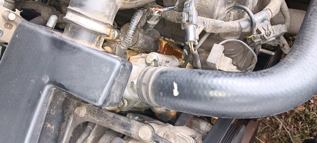

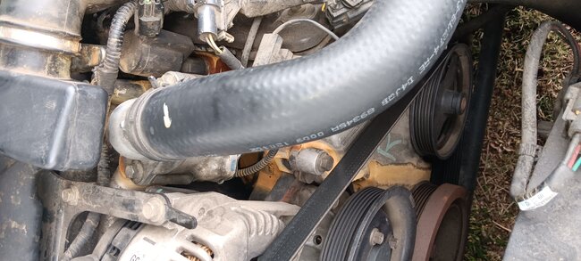

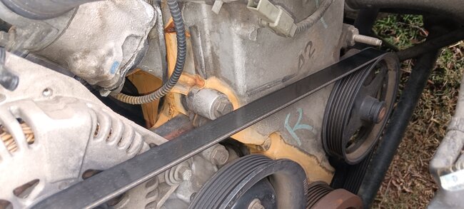

Rust stains on block around thermostat housing?
2003 LINCOLN TOWN CAR
85,000 MILES • 4.6L • V8 • 2WD • AUTOMATIC
CFRUSH1
Water leak troubleshooting pictures attached.
Can I fix it myself?
Mar 12, 2025 at 3:38 PM
  • 54,503 POSTS
Yep, this is a gasket or the cross over from the thermostat housing. The intake will need to be loosened and propped up slightly.

Hi Ken,
What do you mean that the intake needs to be propped up slightly?
Do I use gasket maker or buy one?
I will see if I can fix it myself, should be fun.

It appears that the crossover is part of the intake on my Town Car.
Do I just replace the new intake or can this one be fixed?
Mar 18, 2025 at 3:08 AM
  • 54,503 POSTS
I would get a new intake, I would check amazon, here is one for $125.00:

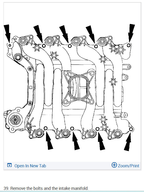

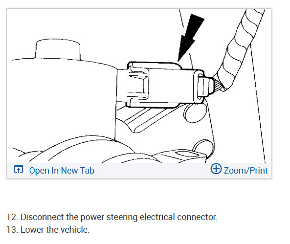

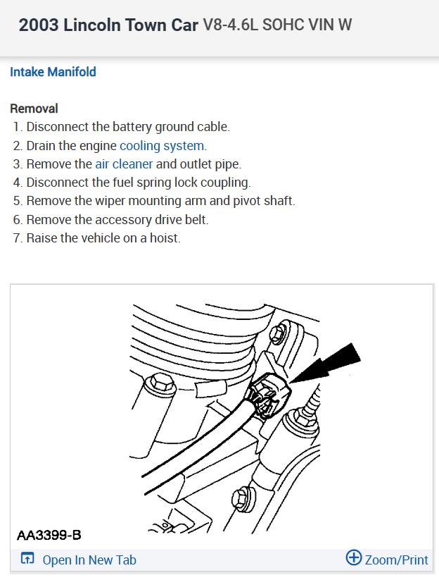

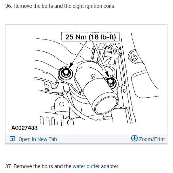

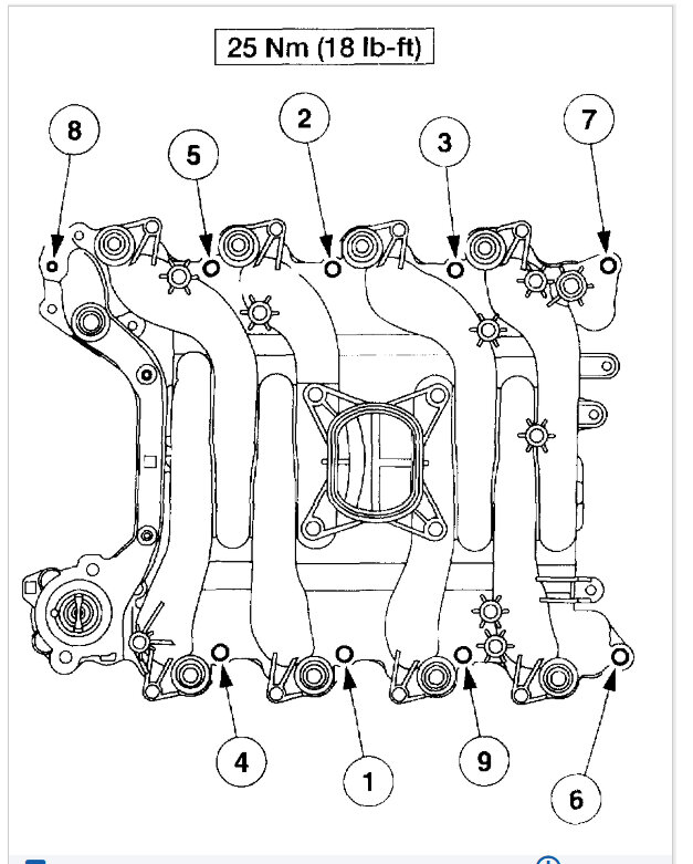

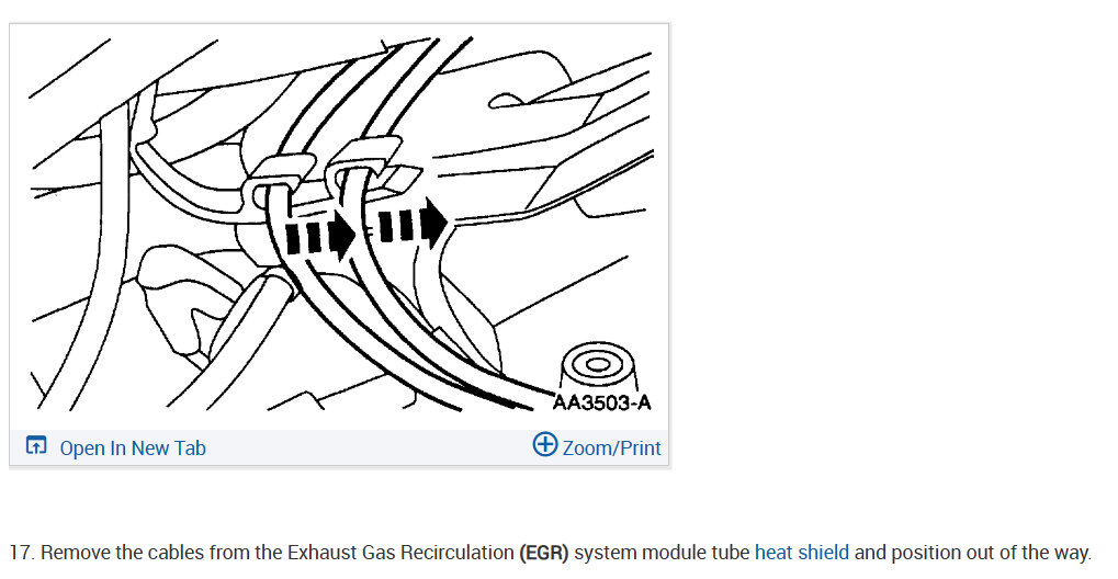

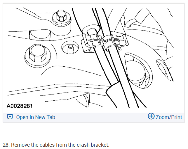

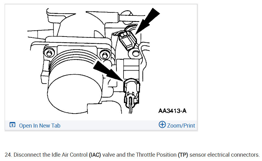

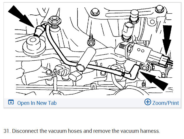

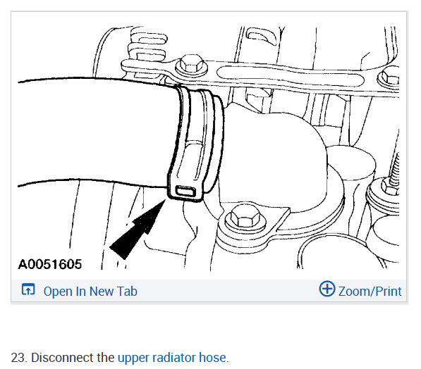

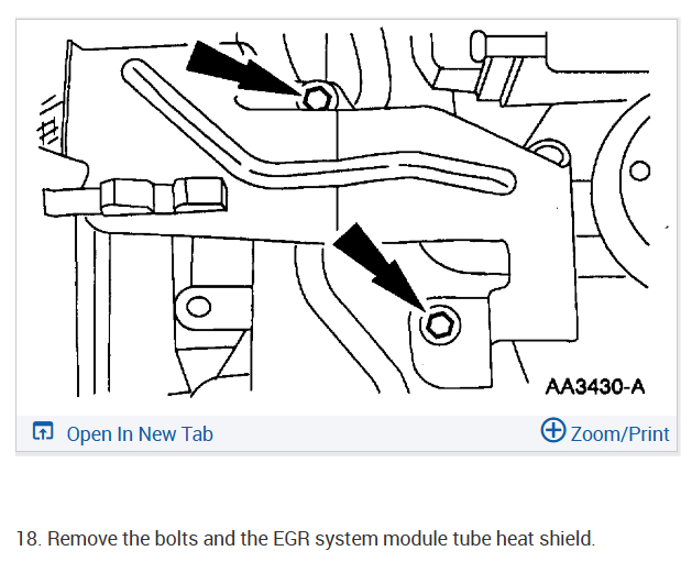

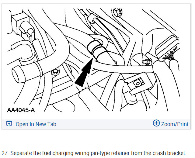

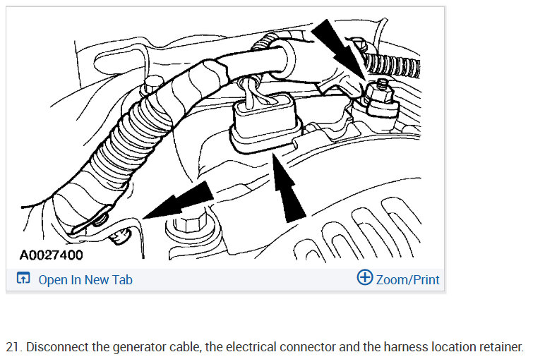

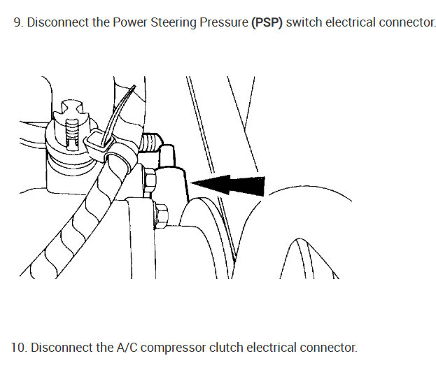

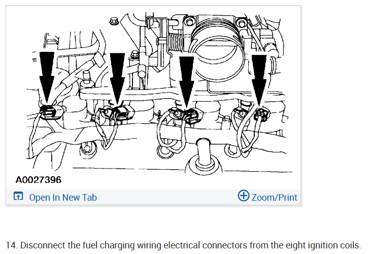

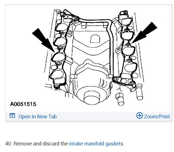

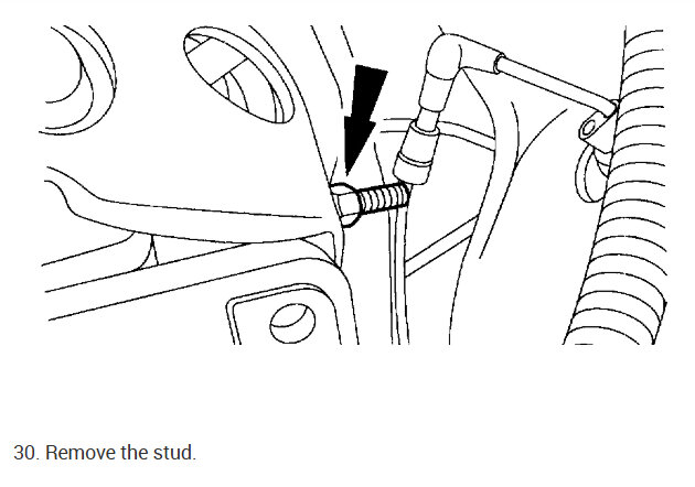

  • 54,503 POSTS

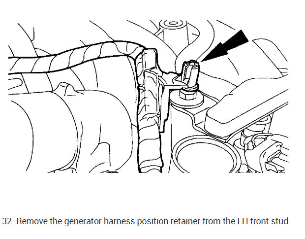

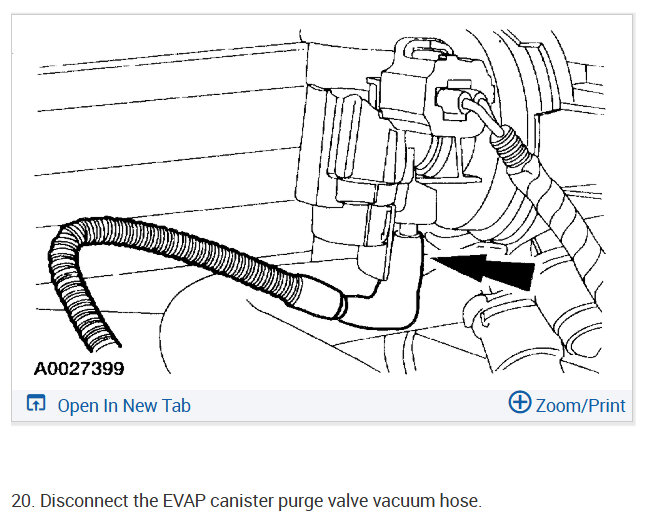

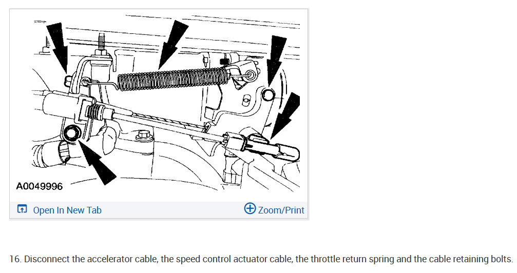

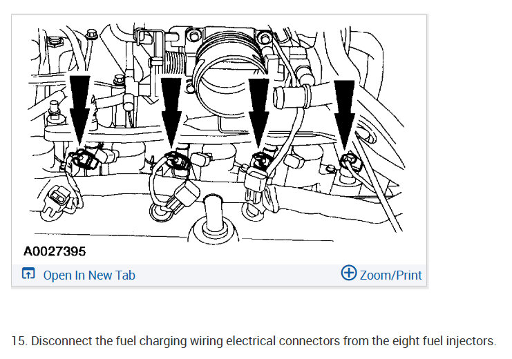

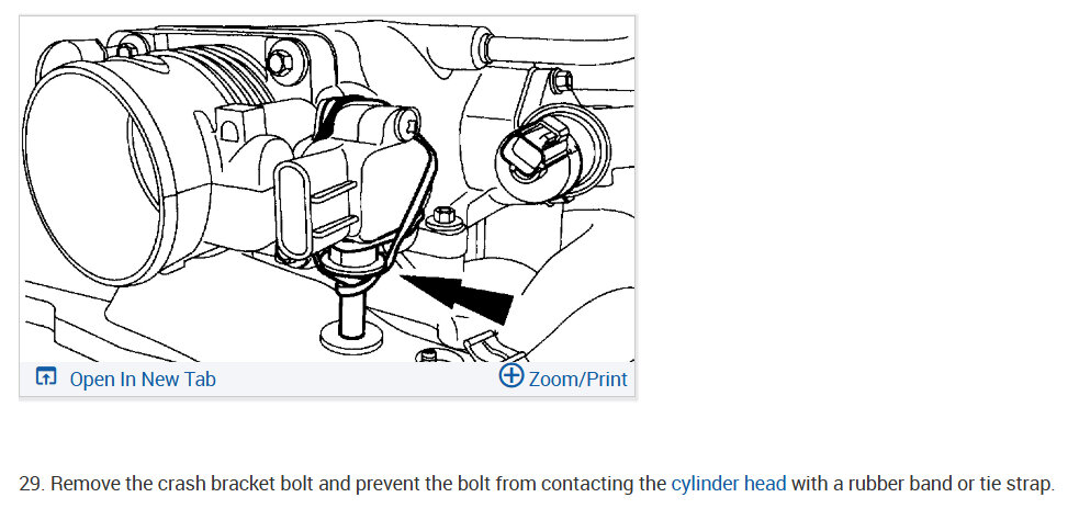

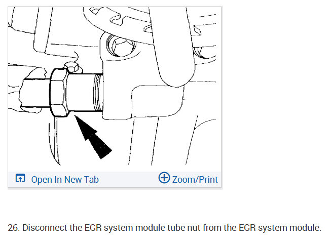

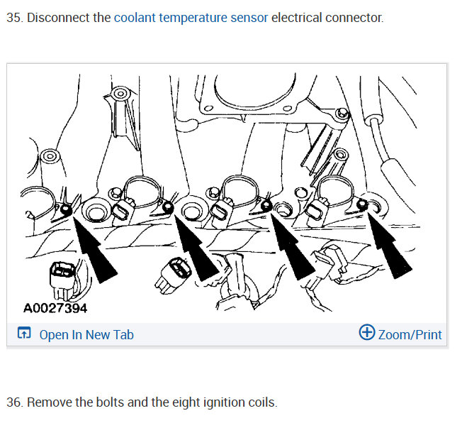

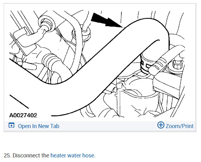

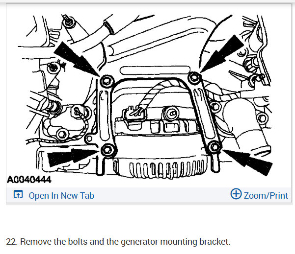

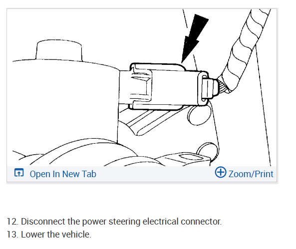

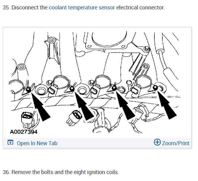

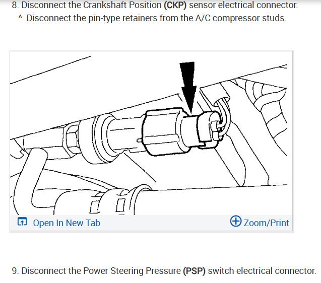

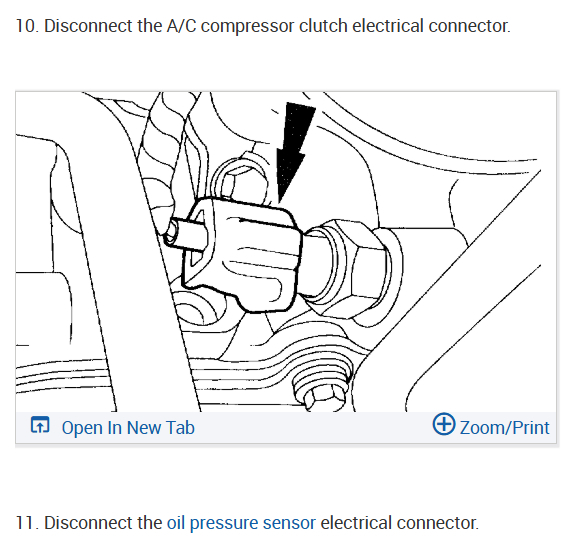

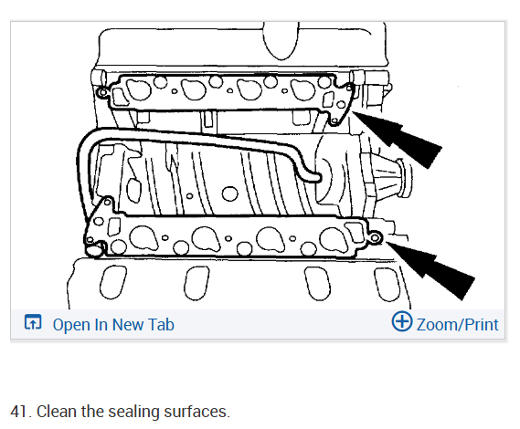

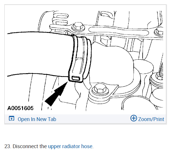

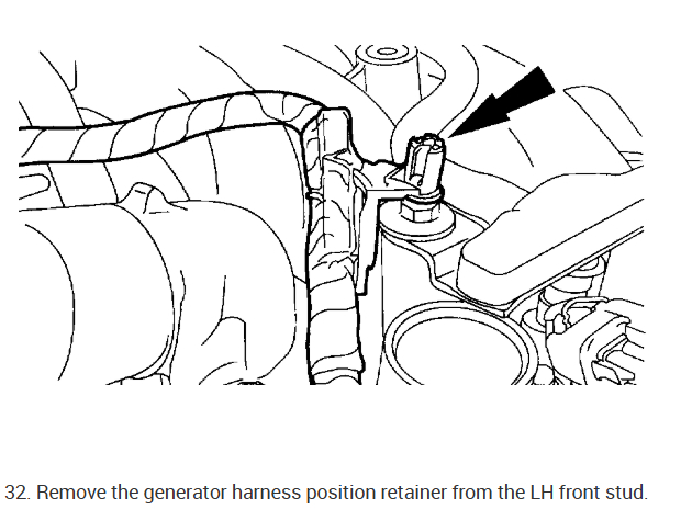

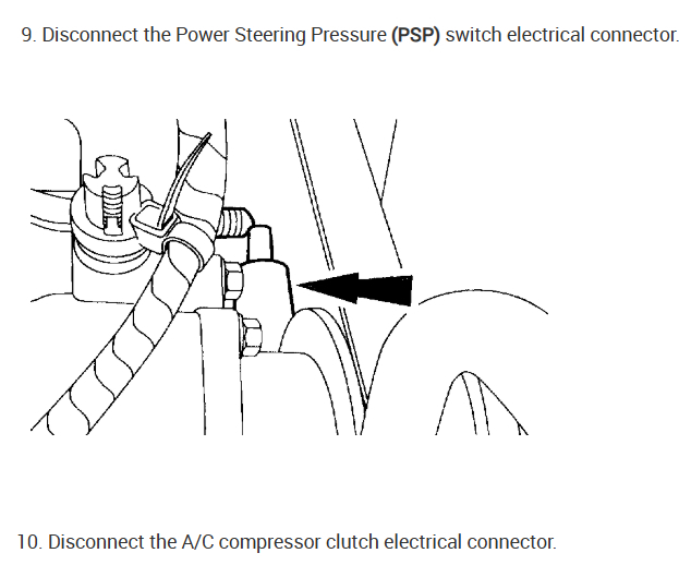

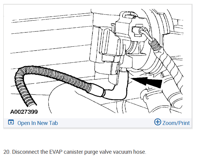

Sure here is how to change out the intake manifold and the torque specs and sequence as well. Check out the images (below). Let us know if you need anything else.

Hello Ken,
I removed the thermostat housing and there was "no thermostat or O-ring" installed.
Surprise.
I will install new ones with a little gasket maker and see if that works B4 replacing the intake manifold.

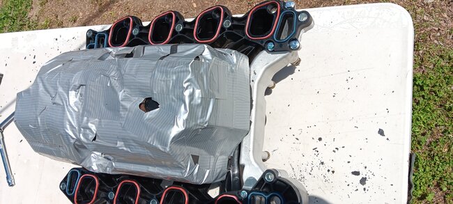

Do I need to reuse the foam cover on the bottom?
It is kind of falling apart.
Apr 2, 2025 at 7:25 AM
  • 54,503 POSTS
Can you upload an image so I can see what you are talking about?
Apr 2, 2025 at 10:58 AM
CFRUSH1
  • 73 POSTS

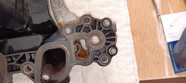

I guess this is called a heat barrier and noise suppressor.
I taped it up so I will use it.
I guess the part is discontinued.
Also, image of part that failed (plastic channel broke off) and leaked.
Apr 2, 2025 at 12:41 PM
  • 54,503 POSTS
Yep, that is a heat soak barrier, it should be good the way you repaired it. Also, thanks for uploading the coolant leak problem, once you get the engine back together the problem should be fixed. Let us know if you need anything else, we are here to help.
