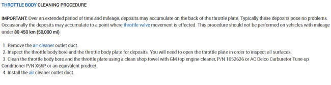

I drove my car yesterday and it operated normally. This morning, when I started my car, the RPMs fluctuated from 300 to 3,000. I waited a couple minutes to see if it would stop and it did not. I put the car in reverse, but the fluctuations remained. For some context, in the past I have noticed the RPMs fluctuating a bit when driving on the highway, but only by a few hundred RPMs. This is the first time the fluctuation has been so drastic. What might be causing this?

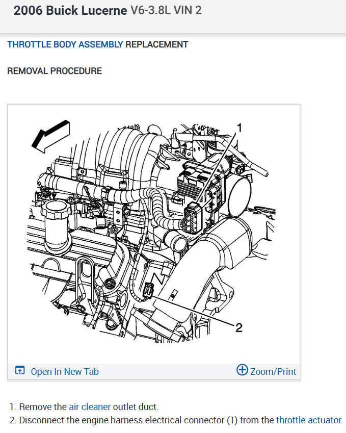

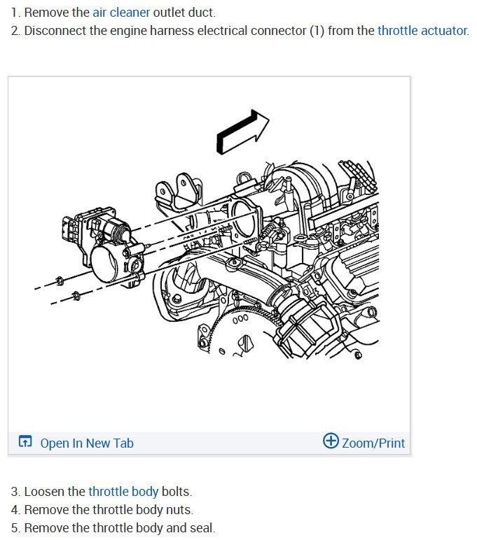

If no leaks are found let's service, the throttle bore. This guide will show you how with instructions for your car in the images below:

Yep, both a vacuum leak and a dirty throttle body will cause this issue.

I'm sorry for the late reply. I always forget to respond once the problem is solved. I wasn't able to clean the throttle body as thoroughly as I'd like without taking apart more than I was willing to. So, I cleaned the throttle body as well as I could while installed. I haven't had trouble since! Thank you!
