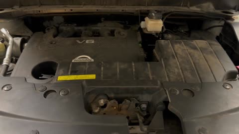

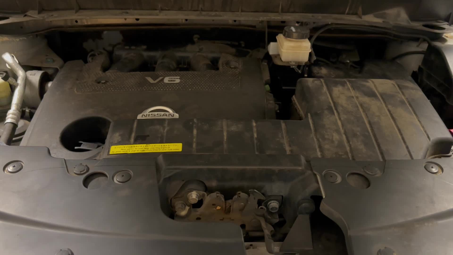

I recently took it in for an oil change while on a trip. The mechanic told me my head gasket was starting to leak (nothing too bad or urgent. Just something to take care of sooner rather than later). I went to my local dealership a couple days later for a gasket head replacement, new valve covers, and a brake flush. The service advisor messaged me asking for my permission to install a new air flow meter since the old one cracked from age. I agreed. The service was supposed to take half a day, but ended up lasting all day. When I picked up my car and started driving home, I realized my AC was dead (blowing hot air). I returned to the dealership ASAP and asked them to get it working. A few minutes later, the service advisor returned from talking to the mechanic. He said my AC compressor coincidentally "crapped out" during the seven hours they had my car. The AC never had a single problem in 14.5 years and my compressor just died a sudden death with no warning? Autopsy report: "AC comp with clutch; replace AC compressor with clutch (add evacuate and recharge); has power and ground at clutch. It is not engaging." Before authorizing the replacement, I asked if they had checked the refrigerant. They said the clutch was malfunctioning despite receiving the correct electrical signal. I authorized the replacement. There's a lot more I won't go into here, but bear in mind that the dealership had my vehicle for over a week while playing games with me. I had to address the owner to get any action from the GM. This, sadly, is just the first part of my saga.
I picked up my Murano yesterday and was thrilled that she was back in action and her AC was blowing cold. I live 5-10 mins from the dealership and went straight home. Today I drove to a destination five minutes from my house. At first everything seemed okay. Then I parked for about 20 minutes and restarted the car. It was then that I noticed a very rough idle. While driving to the dealership my engine seemed to be making more effort than usual to accelerate in the range of 40-50 MPH. Then, when I arrived and went to park, it made a very loud grinding metallic sound when I turned my steering wheel. No check engine lights were illuminated. I asked the service manager to sit in the front passenger seat so he could hear and experience the same things my daughter and I did. He acknowledged the rough idle and the metallic grinding sound.
I read about potential causes of rough idling and understand that the new air flow meter and AC compressor (or installation errors thereof) could be to blame. I'm hoping there's a simple answer and solution. However, I cannot comprehend how the grinding sound possibly could be related. All my tires are in great shape; two were installed just a year ago and the others aren't a whole lot older. I have them rotated routinely, so surely someone would have informed me that there was a problem with my suspension. I know cars get old and parts wear out, but not at the exact same time! I would really appreciate your insights as I prepare for another day of dealing with the dealership. I am over $2K in the hole with a car I cannot drive. It is my only vehicle and I cannot afford to replace it. Thanks in advance for your help.

So, by head gasket I think you mean valve cover gasket, correct? It seems like they are causing issues at the dealership, I would lift the hood and inspect the ignition coils and the work they did in general. This can be why it is running rough, next I would upload a short video of the noise you are hearing so I can see what it is. Next, I would run the codes to see which ones are stored.
It seems pretty coincidental the AC when out at the same time they did the valve covers, I would take it to another shop for inspection. The dealerships can be rough. I can help you through this one step at a time. Please upload pictures or videos in your response.

Hi Ken. Thanks for your reply! The parts are 13264-JP01A and 13264-JP01B. I heard back from the service manager today. He told me that he had to reposition two bushings that were removed for the AC compressor installation. Apparently, they didn't slide in all the way up to the shoulder. The misalignment caused metal-to-metal contact of the pieces that were bolted together. He explained that this contact caused normal engine vibrations to transmit to the rest of the car.
Since picking up my vehicle this evening, I have noticed a couple of strange things. As the AC cycles, there's a transient and unusual sound in the cabin that wasn't there before. I cannot find the words to describe it other than "mild whistling/squeaking and spinning." When I open my hood and stand there with the AC on, the compressor seems to cycle about every 20 seconds. What's odd is that every second or third cycle, the engine seems to go faster and get much louder.
