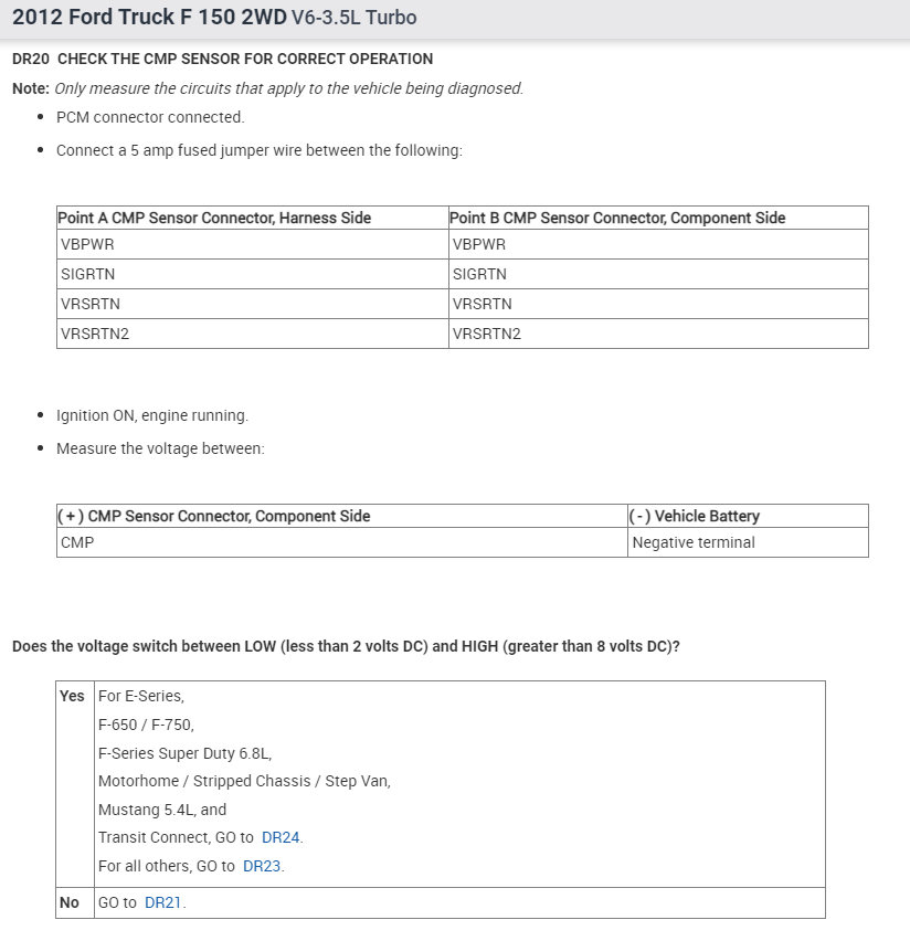

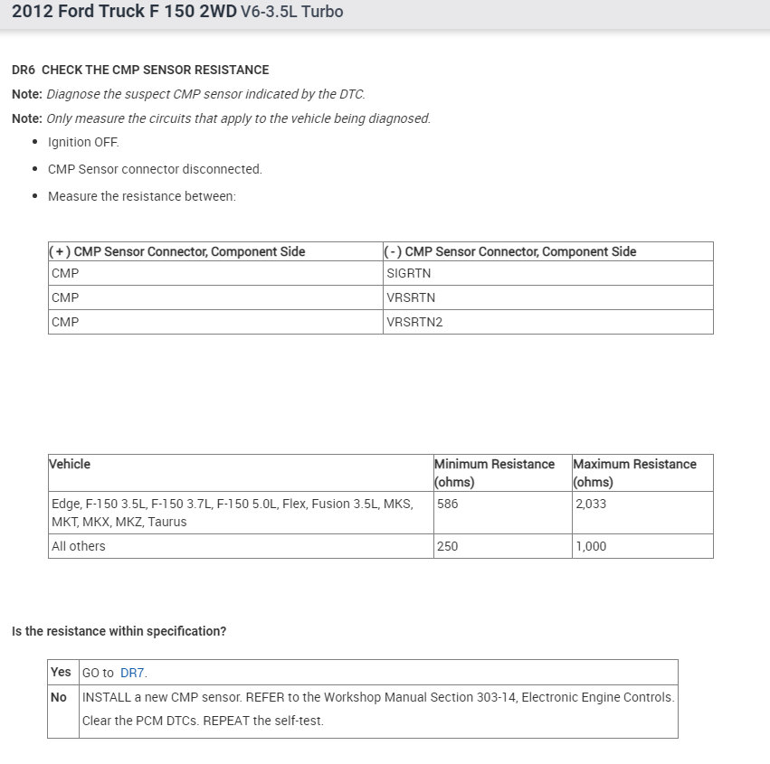

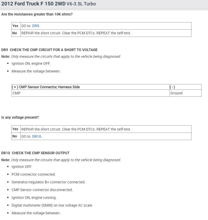

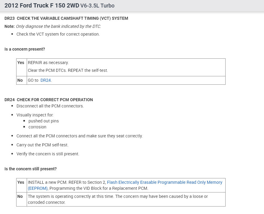

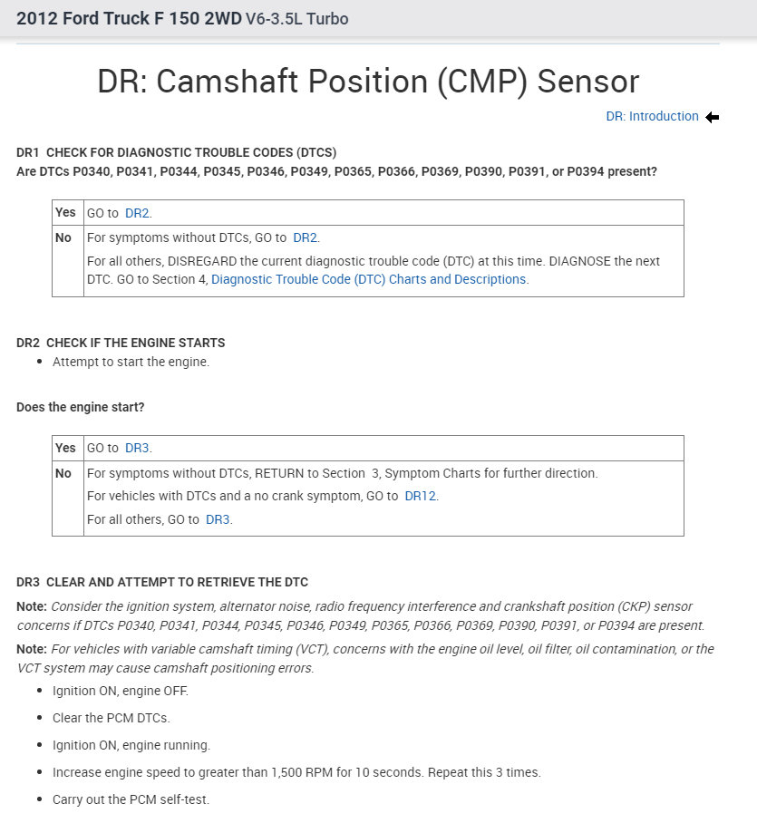

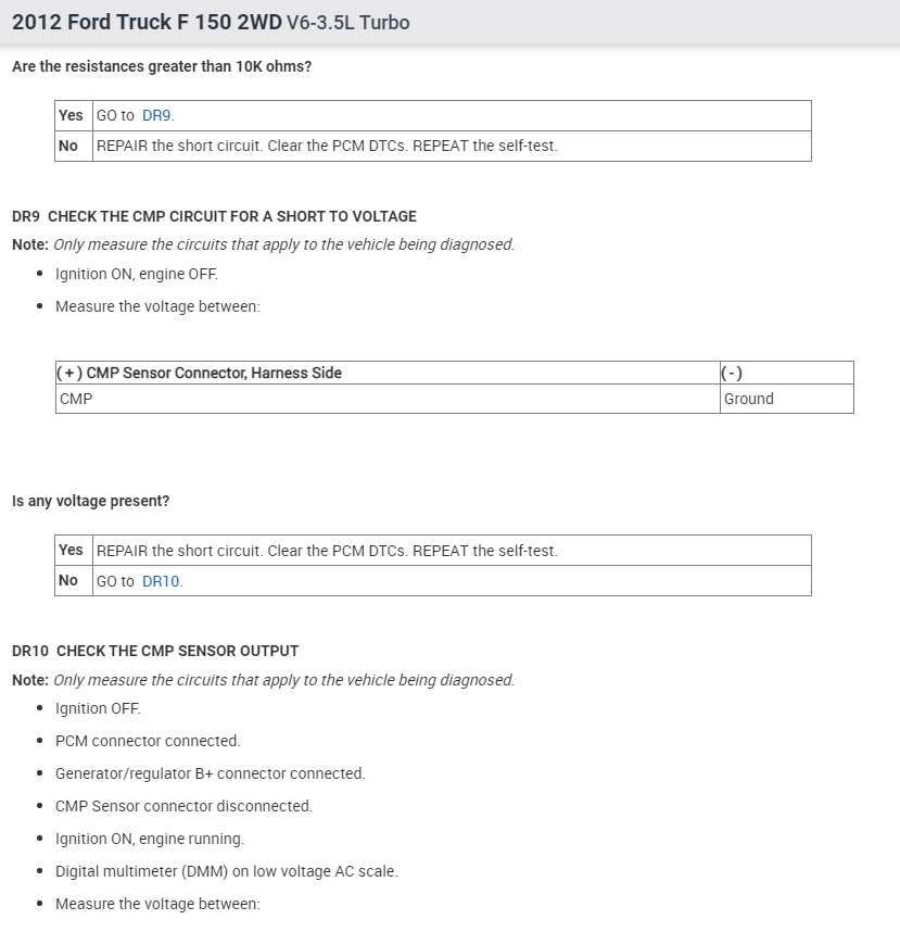

Went to pass a car and the engine immediately started to run rough and had no power. Engine light came on. Checked codes with ODB scanner. Received P0365, P0369 and several cylinder misfire error codes. Have changed the camshaft B bank 1 sensor. (ohmed both the old and new part and got the same reading) Replaced all spark plugs. Engine still running rough with no power when putting it in drive. Cleared codes and still getting the P0365 and P0369 error codes. Engine and PCM changed 12/20.

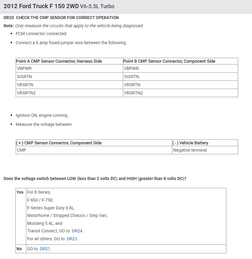

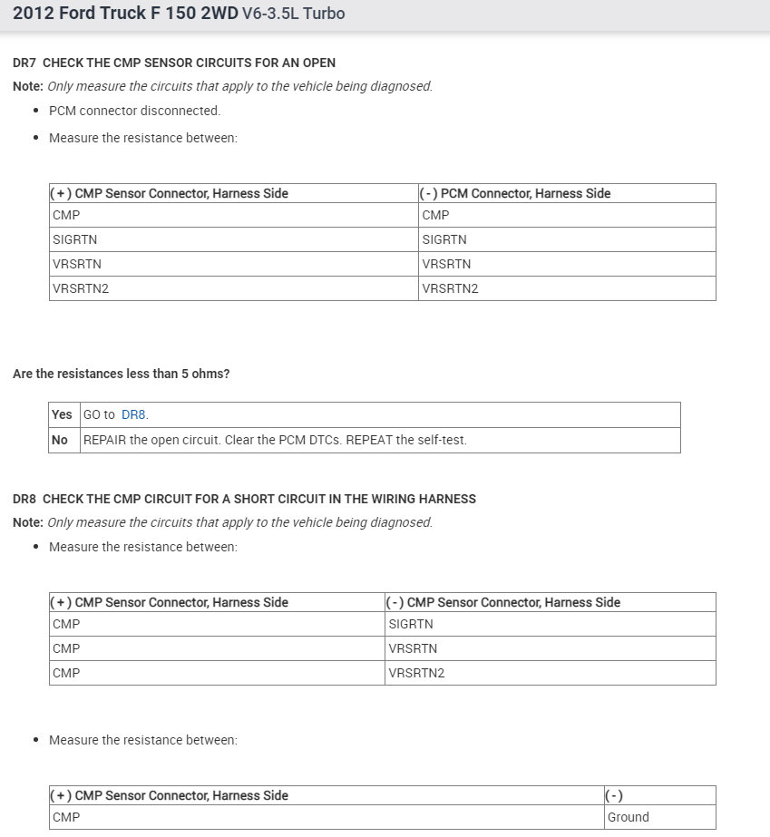

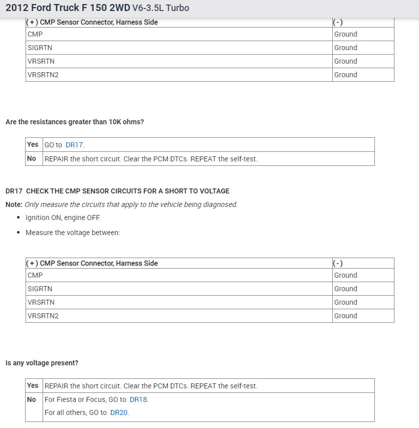

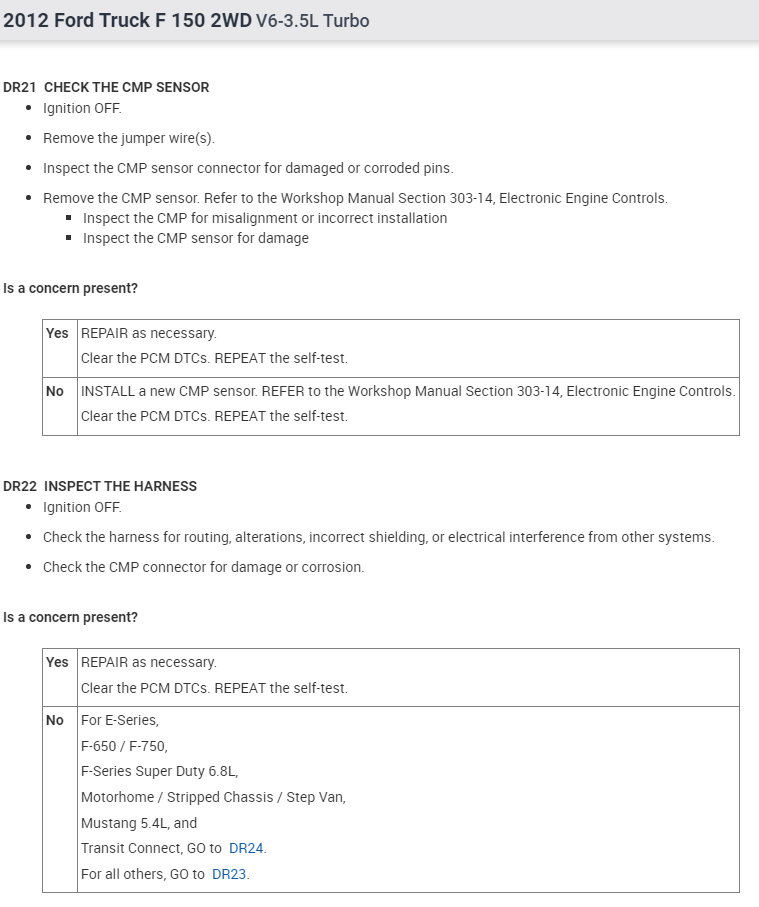

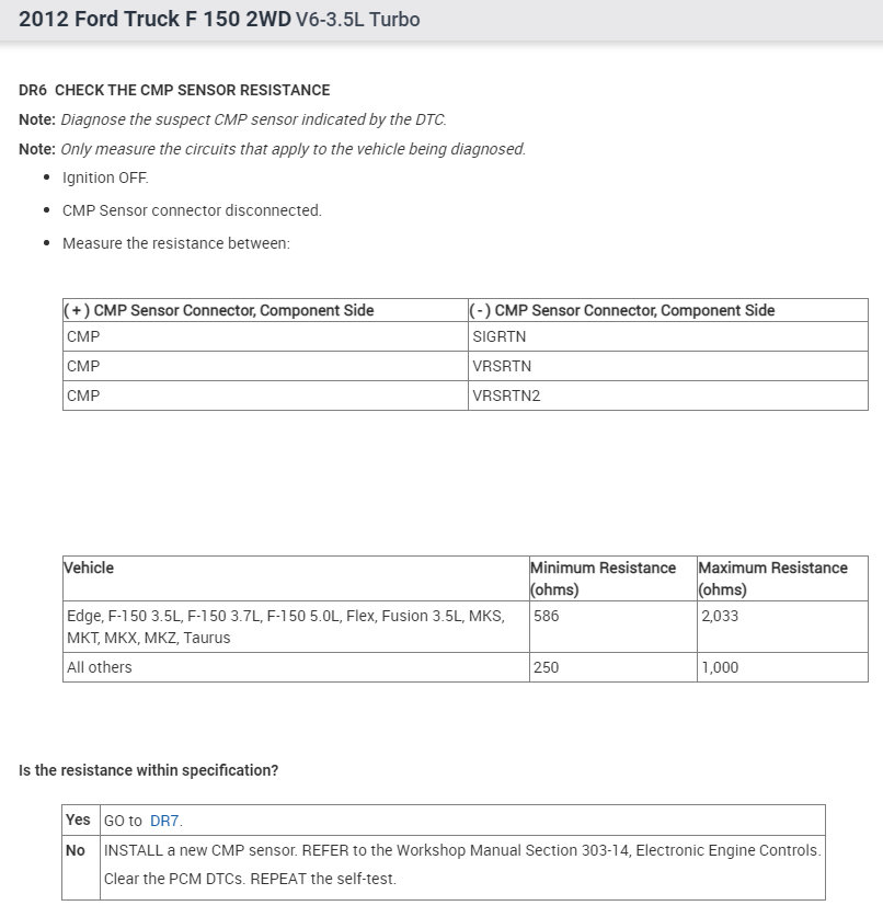

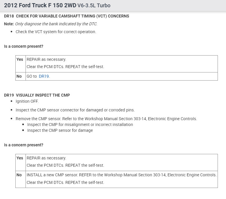

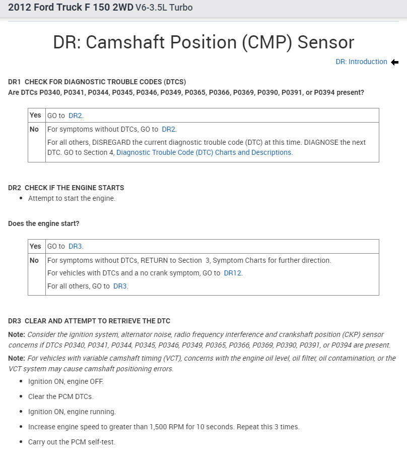

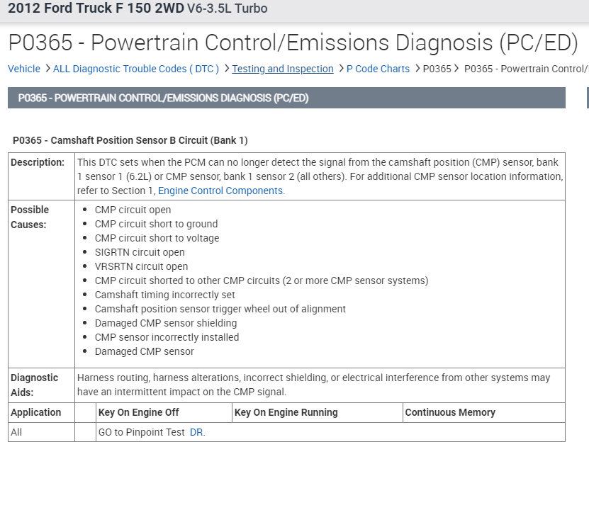

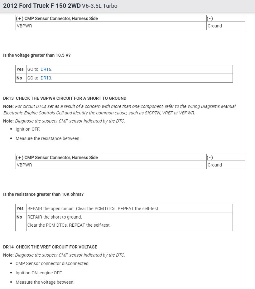

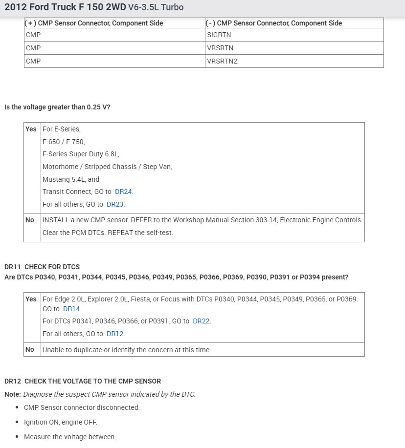

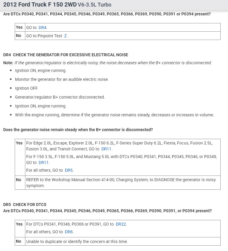

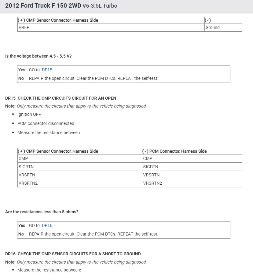

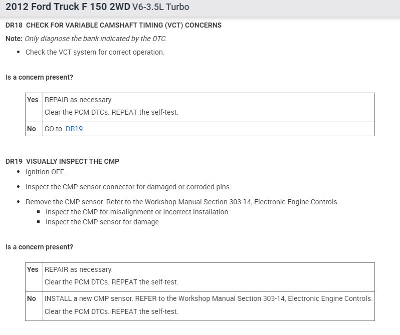

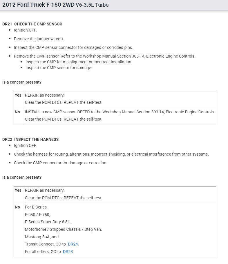

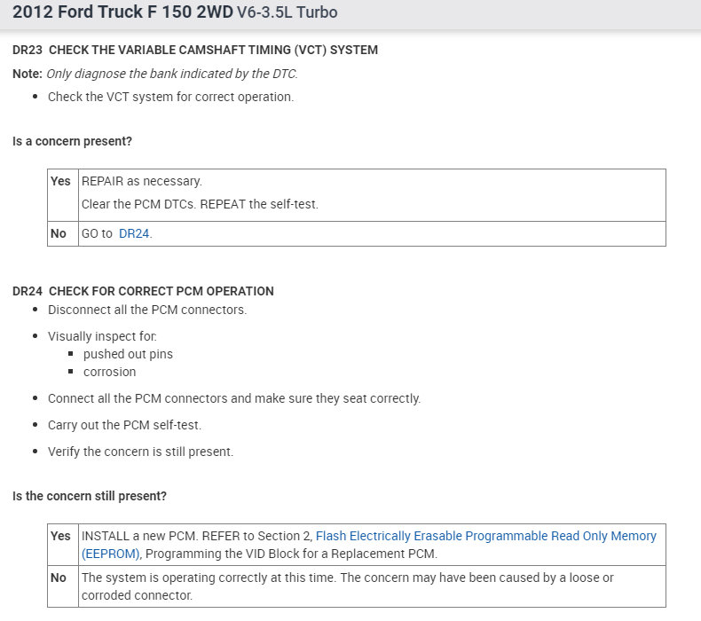

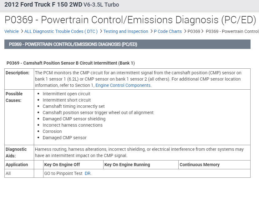

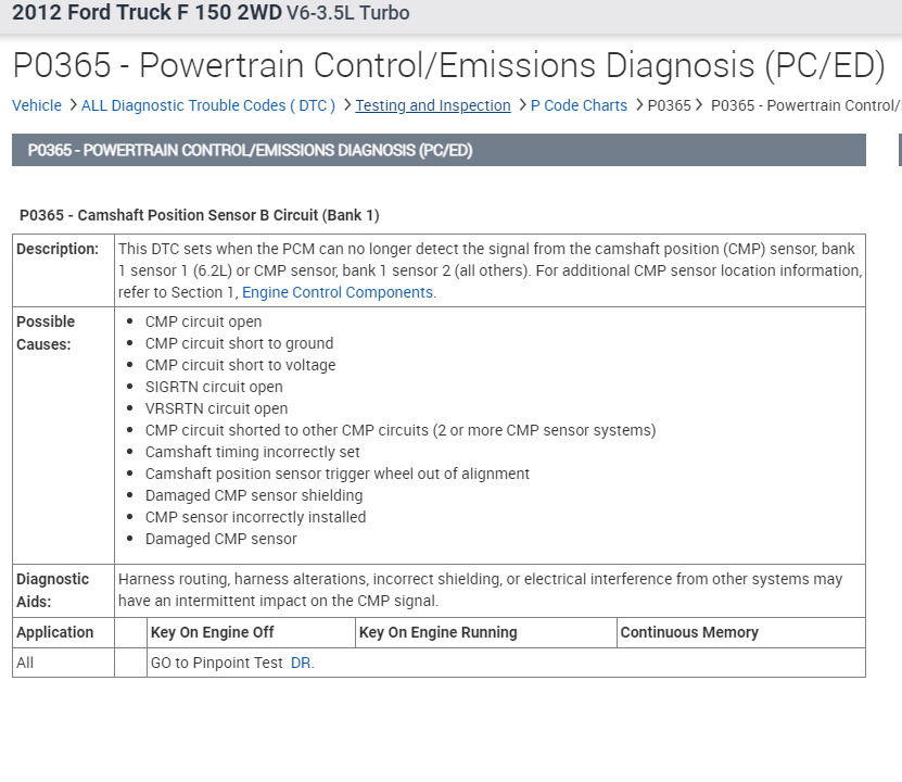

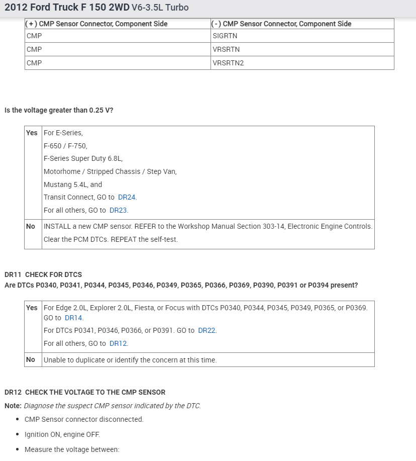

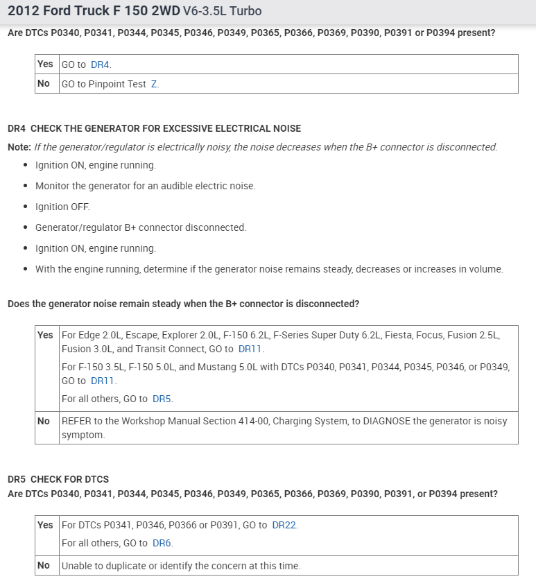

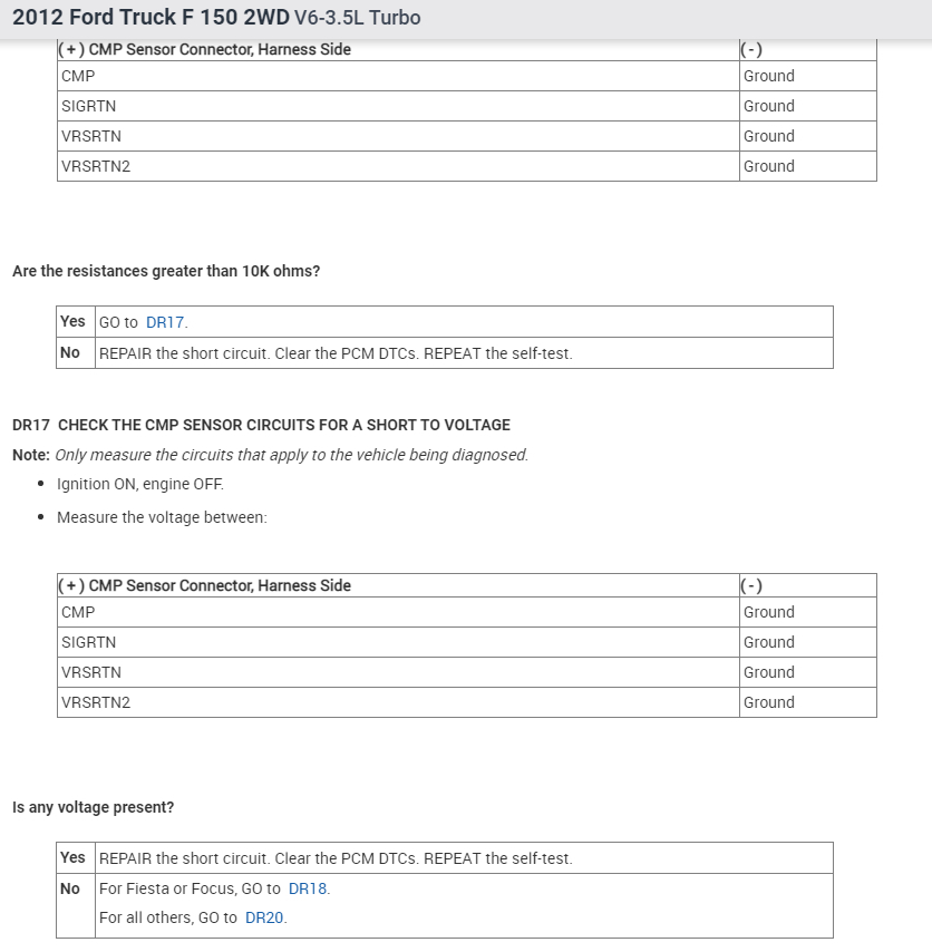

The codes,
P0365 - Camshaft Position Sensor B Circuit (Bank 1)
P0369 - Camshaft Position Sensor B Circuit Intermittent (Bank 1)

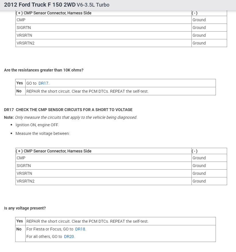

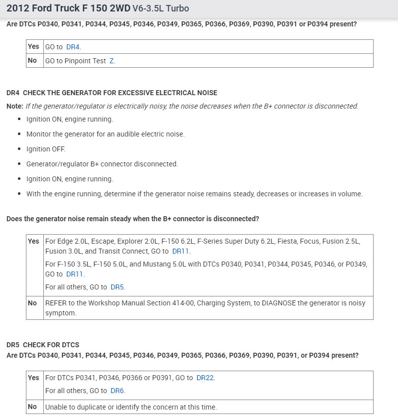

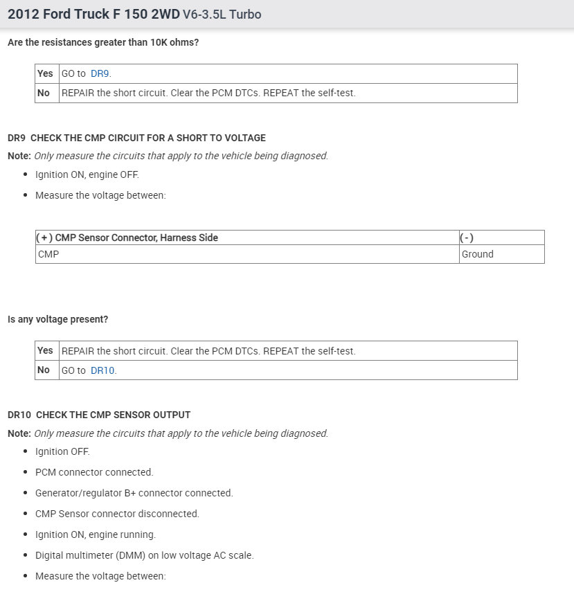

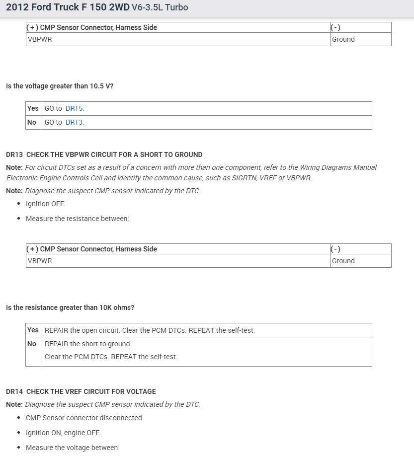

This can be triggered due to circuit being short to ground or open circuit or not getting proper voltage.

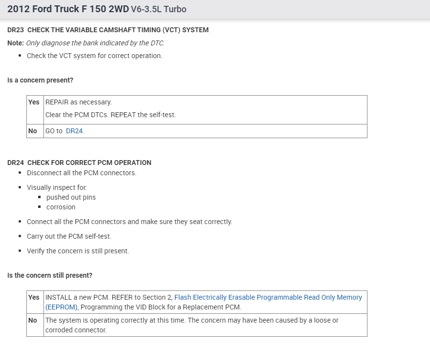

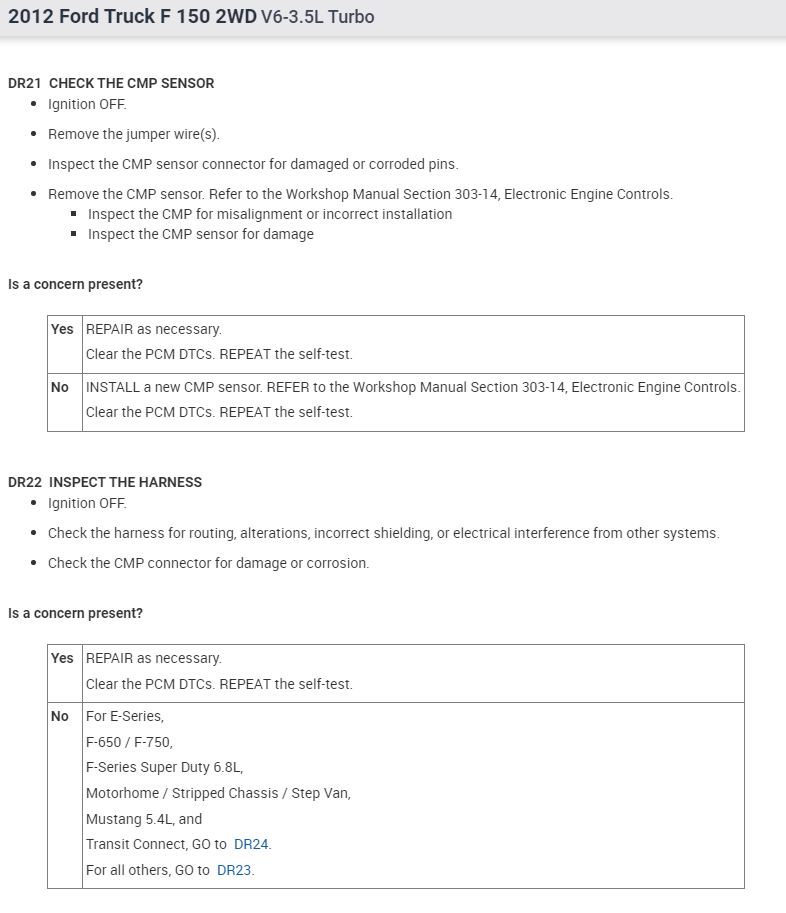

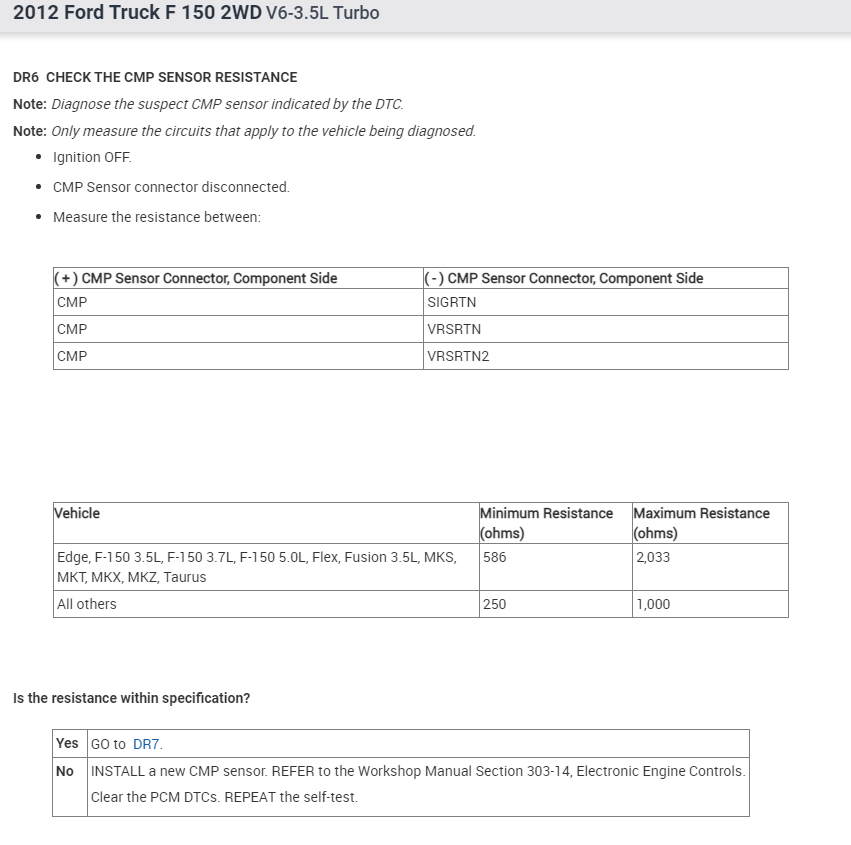

I have attached the troubleshooting guide for these codes below. Follow those steps, as it can help you determine the issue.
Let me know of any questions.
