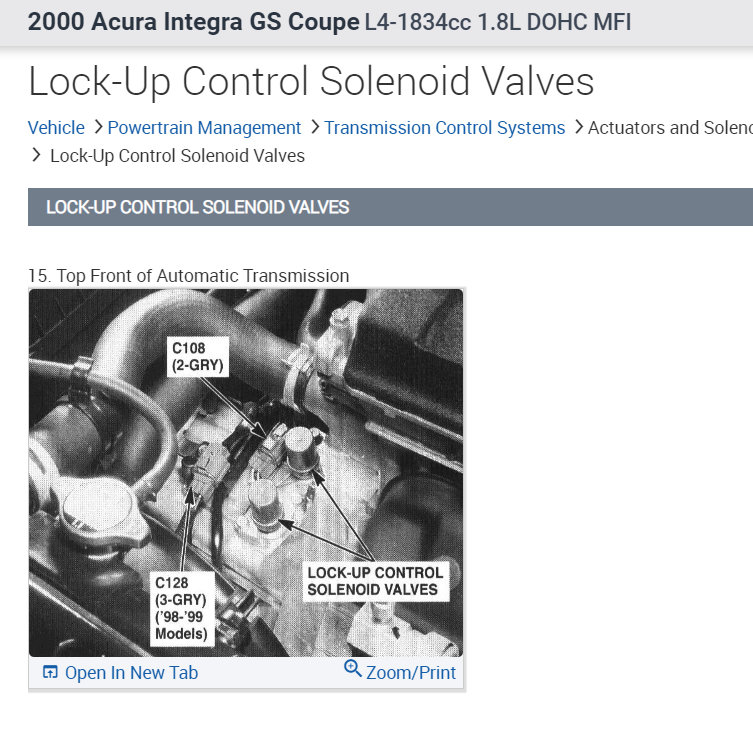

I've been having an idle issue with my car where it fluctuates between 800 and 600 RPMs when at a stop sign or when I'm reversing etc. It has been doing this for a while and I have changed the PCV and ICV and nothing really has changed. There aren't any codes being thrown either so I'm kind of stumped. Any ideas you might have as to what's causing this?
Jul 10, 2022 at 8:50 PM
  • 54,144 POSTS

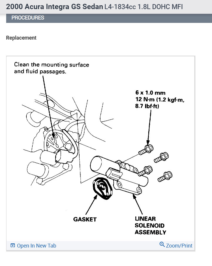

I have seen the linear control solenoid cause this issue, is this the one you changed out? Check the diagrams below. Check out the diagrams (below). Please report back.

No, I haven't changed that out, would it cause idle to just jump up and down from 900ish RPMs down to like 600? Sometimes when I stop at a red light it feels like it's shutting off and sometimes it's stable.
Jul 11, 2022 at 3:51 PM
  • 54,144 POSTS
Yes, that is what this part controls, let us know what happens.

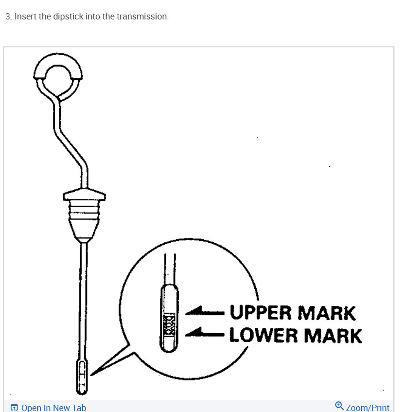

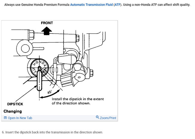

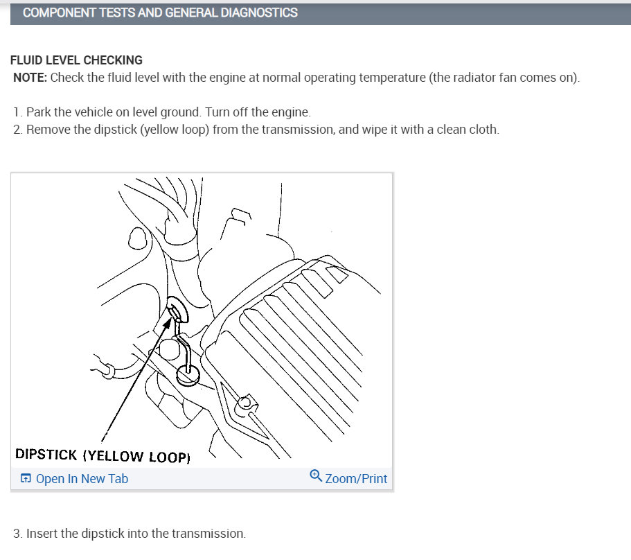

I could be the transmission itself engaging and disengaging, have you checked the transmission fluid level or condition? If not, it could need a transmission service. here is a generic guide to help with specific instructions for your car in the diagrams below:
A/T Fluid
Type .................... Honda Premium Formula ATF
Capacities
A/T Fluid
Change .................... 2.7L (2.9 Qt)
Total .................... 5.9L (6.2 Qt)

Yep that can do it, or you have a bad torque converter. Can you try the engine idle problem in neutral and see if anything changes? Here is the converter clutch solenoid location in the diagrams below.
