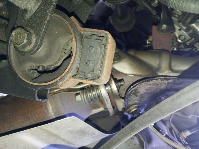

Car seems to have a rough idle and during drive seems to have a minor grinding feel to it. I changed spark plugs with no help and decided to check the engine mounts and found the rear transmission mount looking irregular. Could this be the problem looking at the attached picture

Yep, you found the problem that engine torque mount is shot and you need a new one, this will make the engine seem rough and make a grinding noise and the engine exhaust will touch the underside of the car. Replace the part and let me know what happens. Thanks for the image it helps. Ken

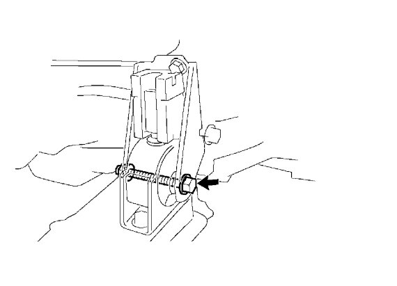

I know that back mount is bolted to the chassis underneath. So do you just support the transmission with a jack and disconnect the bolts/nuts after taking the air intake out of the way and have the car on jack stands. I don't want anything falling on me from underneath.
Maybe disconnect the left mount to add in lifting pressure if the back once. Is it possible to do it without a lift?

So, the engine is supported by three mounts, front engine, rear transaxle and the torque mount which supports the engine lightly but is there mostly to control the engine roll when in drive or reverse, so I would raise the car on ramps and then support the engine with a jack and block of wood to remove the torque mount, is you run into issues upload a short video or image so I can walk you through the repair. Check out the images (below). Ken
