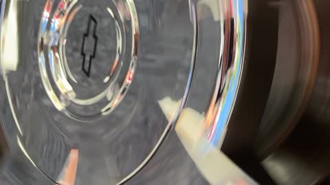

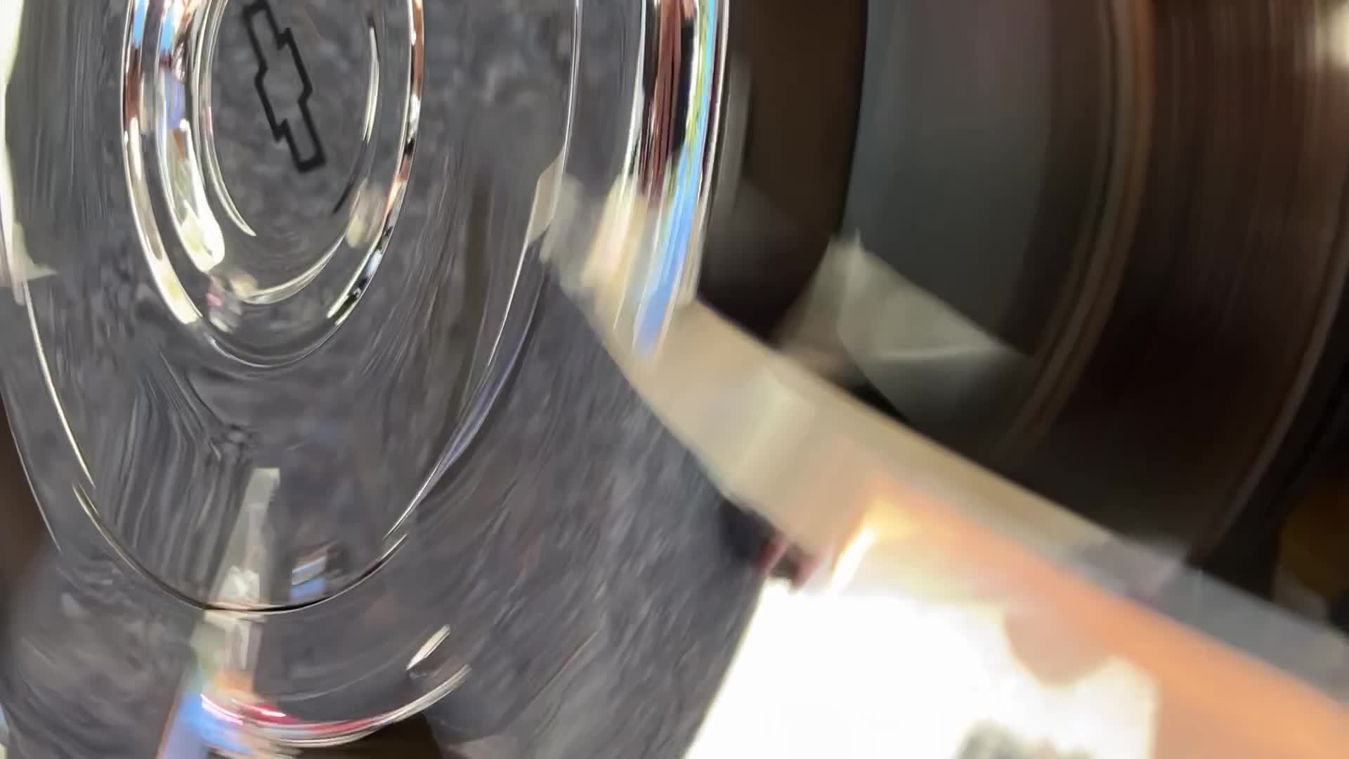

Hi Joe, I’m back again with the same issue the rotational noise, just went on a 4 hour round trip and now I’m hearing the same squeaking noise that starts at 5mph but when I go a little faster I hear this chirping. I jacked the truck up, put it in neutral and spun the wheel and it’s making these scraping a grinding noises, any idea what it can be? Thank you.

I hear something that sounds like something is vibrating. Is that what you are referring to? I hear it best in the first video.

Hi, yes the grinding noise and the intermittent scraping maybe could be a warped rotor but the grinding is my concern.
