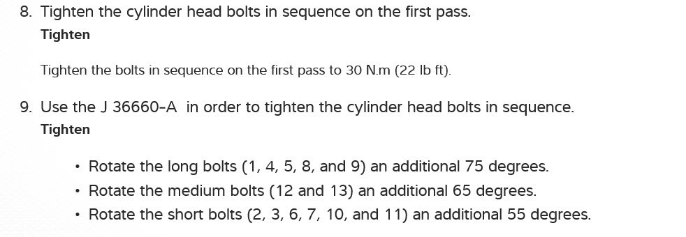

Cylinder one will not hold compression so I started taking it apart and I am down to the head and the valve cover is off. I do not know if the roller rockers have to come off before the head and if so do they have to be in a certain position? Also how do you adjust them when reinstalling?

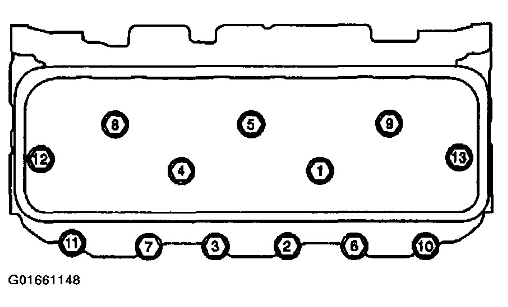

What are the head bolts torque specs and sequences
Apr 26, 2016 at 1:42 PM
HMAC300
  • CAR REPAIR CONTRIBUTOR
  • 48,601 POSTS
see pics also use Loctite pipe sealant on threads of head bolts NOT TEFLON TAPE
