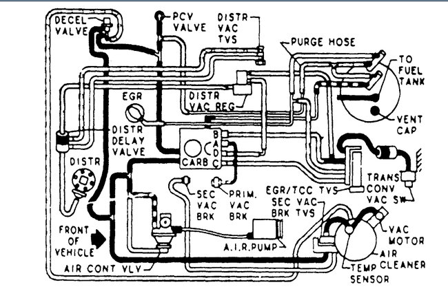

After having carburetor rebuilt I need to install but do not know where the hoses go to

Rochester Varajet ll carburetor vacuum ports. please help i had carburetor rebuilt don't know where all hoses connect to.

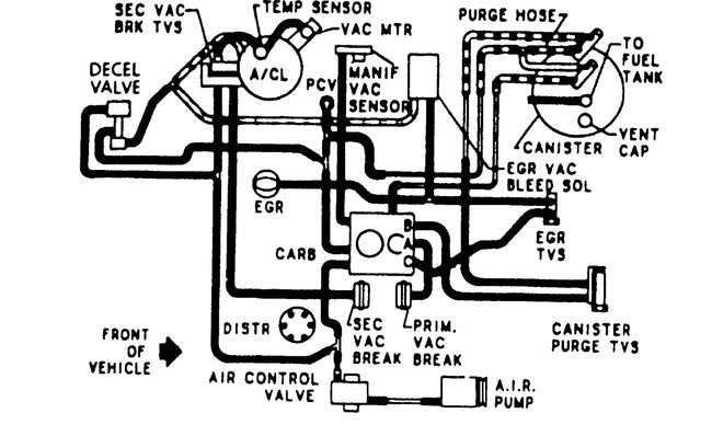

I attached two pics below. The first is a vacuum schematic for California emission vehicles. The second is for federal emissions. I'm not sure where you are located, so I added both.
Take a look through the schematics and let me know if it helps or if you have other questions.
