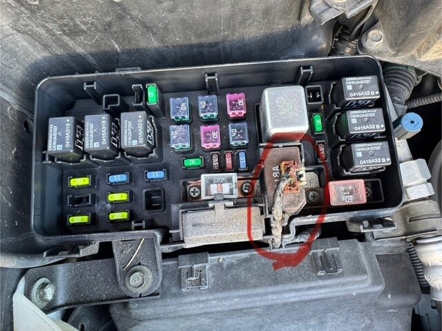

After a few days, I haven't noticed any issues with the vehicles functioning or operation. I did note however that there appears to be some melting or burning as noted in my photo. I don't know for sure if that was there before this incident or not, but it doesn't appear (yet) to be causing any sorts of issues. Anything I should be concerned about or replace?
Jan 27, 2025 at 6:44 AM
  • 54,503 POSTS
I can't tell if that is burnt or how bad the damage is, can you upload it and get a close-up image? Also, get wiring as well.

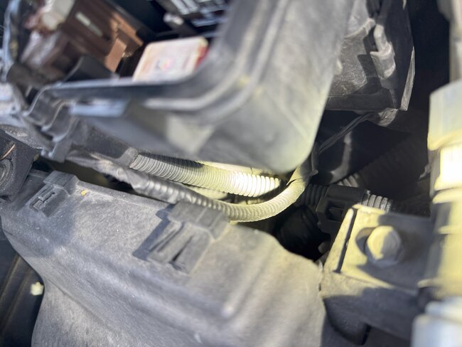

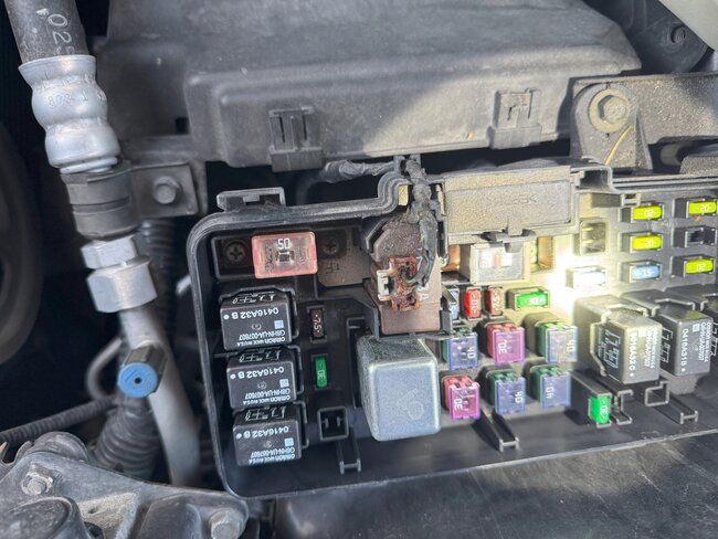

Hi Ken,
Sorry I didn't have access to the Pilot for a few weeks as it was undergoing some body work after I was rear ended. I attempted to take several photos that I hope will help.
Feb 10, 2025 at 12:43 PM
  • 54,503 POSTS
I still cannot tell if it has melted, sorry, sometimes the wiring just looks like that, can you unplug the connector to get a closer look, also does anything seem normal other than that?

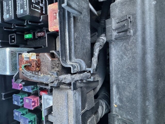

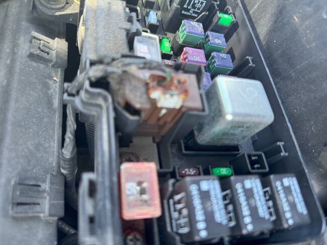

As far as I can tell, everything seems normal. If memory serves, I didn't see a way to unplug the connector, but I can take another look.
Feb 11, 2025 at 1:43 PM
  • 54,503 POSTS
If you can get a closer shot in focus I can see better, sorry.
