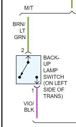

I would like to know what is going with my reverse lights. It used to work but when my son was following me, he noticed that every time I reverse the truck he noticed that it has no reverse lights. I already checked the light bulbs, continuity on wire harness is okay and so I disconnected the reverse switch from the passenger side of the transmission and I connect the single wire on the two prone. there is lights on the reverse when I turn on the ignition switch to run position. So what would be the problem? Is it the reverse switch?. Please help. thanks

If you connected the brown/light green wire to the violet/black wire and the lights turned on when the key was on, replace the switch. I attached a portion of a wiring schematic to confirm.

Good it's working. thanks for the information.
