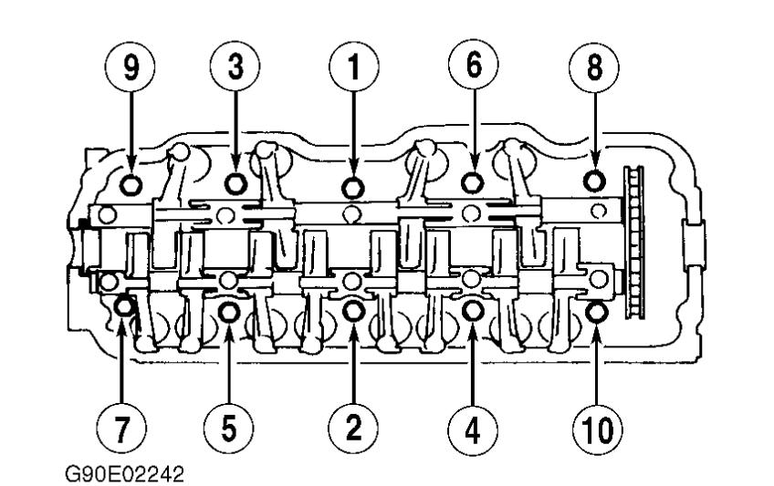

it's done that way because engines are made for different vehicles and some may not need that cooling in it. I think you ought to check this over more carefully for a crack or something similar. torque on bolts shold be as follows
22 ftlbs
58
loosen all bolts
22
then additional 80-85 degrees
follow sequence in pic maximum warpage on head is >004"

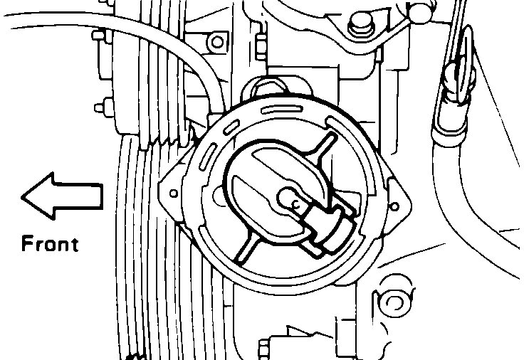

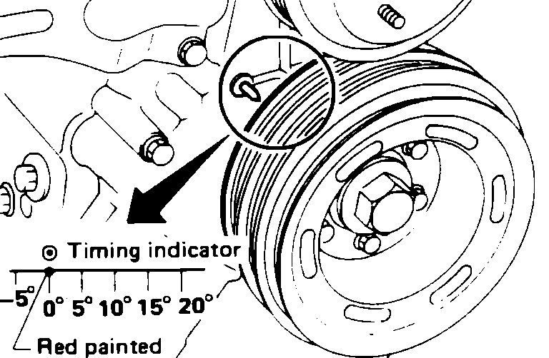

Changed head gasket, put it back together start it up would not idle. replaced TPS, MAF, OXS, check timing marks. it idles now but re stab distributor and oil pump can only get it on timing marks with a light but distributor bolt holes are not lined up so can't lock down distributor.

  • 110,190 POSTS
If you have it running but can't get the distributor locked down because if its position, then you most likely have the distributor one tooth off.
What I want you to try is removing and replacing the distributor. Here are the directions specific to your vehicle for doing this. The two attached pictures correlate with these directions:
REMOVAL
1. Remove the screws securing the distributor cap and remove the cap.
2. Remove the bolt securing the distributor.
3. Disconnect the crank angle sensor connector and remove the distributor.
INSTALLATION
Timing Mark
Picture 1
1. Turn the engine over until #1 cylinder (front) is at TDC compression stroke.
Rotor Position
Picyure 2
2. Install the distributor, making sure the rotor is aligned as shown when fully seated.
3. Install the distributor securing bolt and tighten slightly.
4. Connect the crank angle sensor terminal.
5. Install the distributor cap and tighten the screws.
6. Refer to ADJUSTMENT PROCEDURES and adjust the timing.
