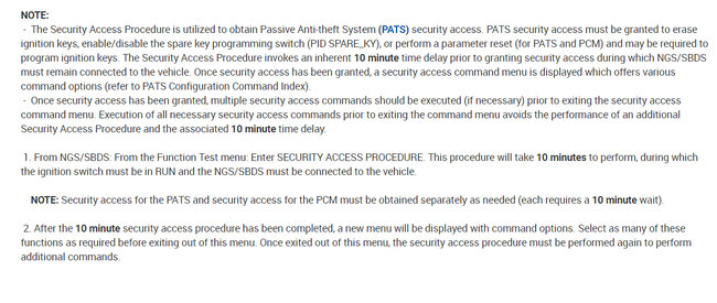

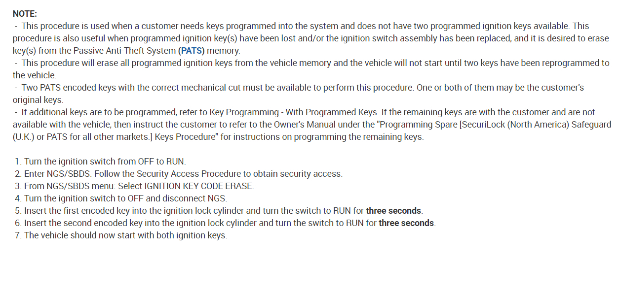

Can I replace my lock cylinder and reprogram my key the same way you explained for the 1998 Ford expedition for my 1998 Ford Explorer? I have the exact same thing happened last the keys drill it out got the lock cylinder, tumbler, and stuff out but then I lost my keys after that, so I don't have the key. So, can I do all the same things you guys explained for the Expedition?
