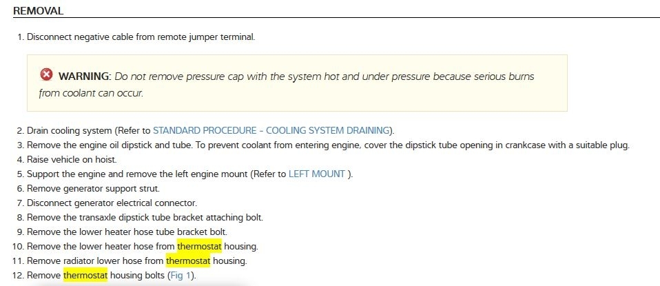

Hello, I am looking for the location for the thermostat.

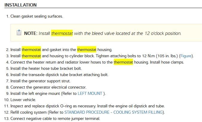

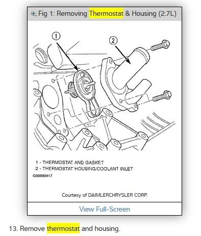

Prodemand does not simply list a location, but it does have a how-to article for the job. I have attached it in the images below. It may be the most complex thermostat job I have ever seen.
