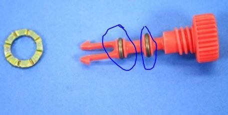

It's possible the radiator is cracked, however another possibility is that the O-ring that the drain seals with either came out or was damaged and it is allowing the coolant to leak past. I would drain the system and check that first, at the same time you can examine the radiator itself for a crack, however if the coolant is only coming out the small outlet the O-ring inside is a more likely suspect. It isn't shown well in the video but should be similar to the picture. The circled parts are the O-rings. You can get a replacement from a parts store or a dealer. Then once you drain the coolant check for the rings or any damage that could be the issue.

The piece we unscrewed to drain the coolant doesn’t look like that orange piece in the picture you sent. It’s black and much shorter and doesn’t have o-rings or the hooks at the end. We have an aftermarket radiator, I replaced it about 5 or 6 years ago.
I will see if I can get a new screw piece and hopefully that works.

Okay, aftermarket would be different, but it should still have o-ring seals. There were a few types of drains used, some only turned 1/4 turn others unscrewed. If you know who made the radiator you might be able to find the part easier. Or just the seals if you took the drain out.

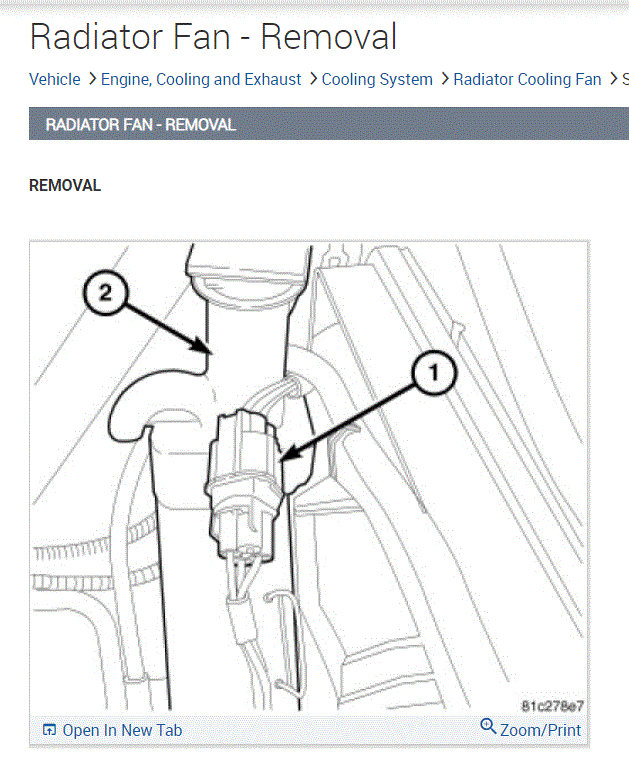

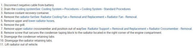

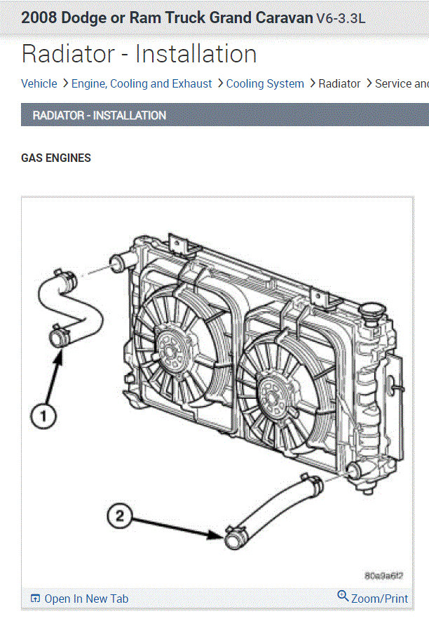

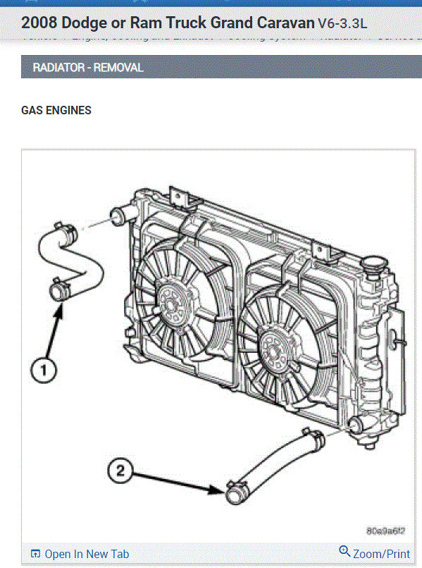

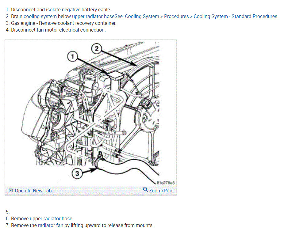

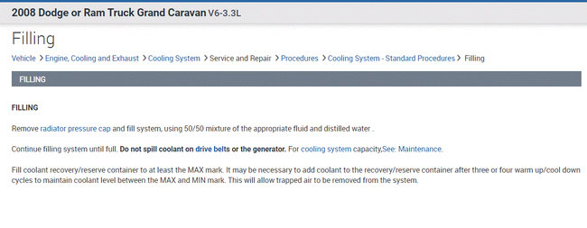

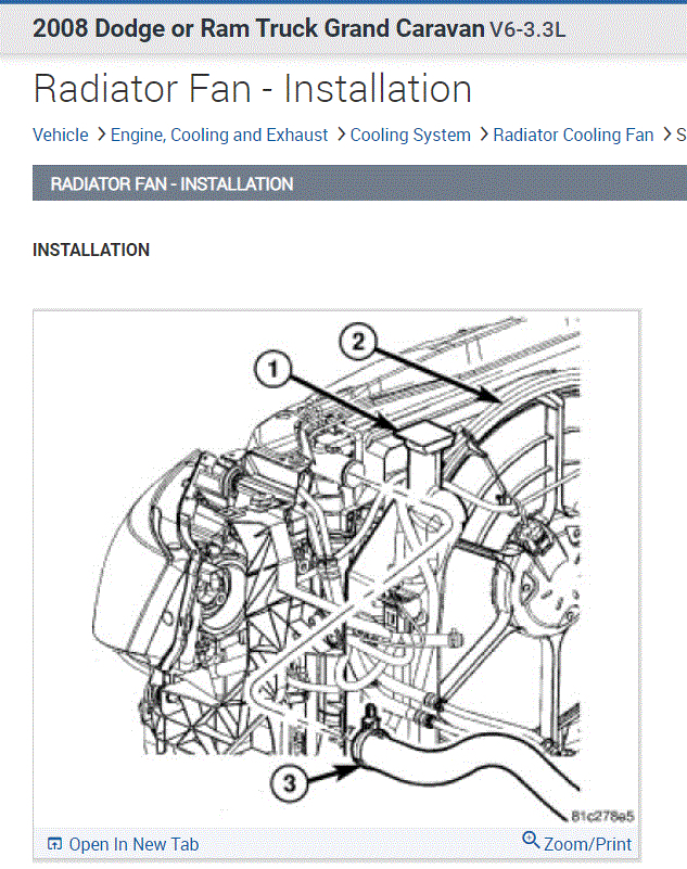

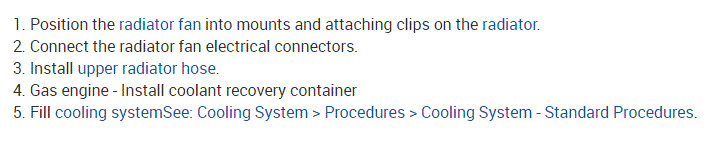

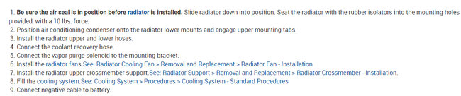

  • 110,194 POSTS

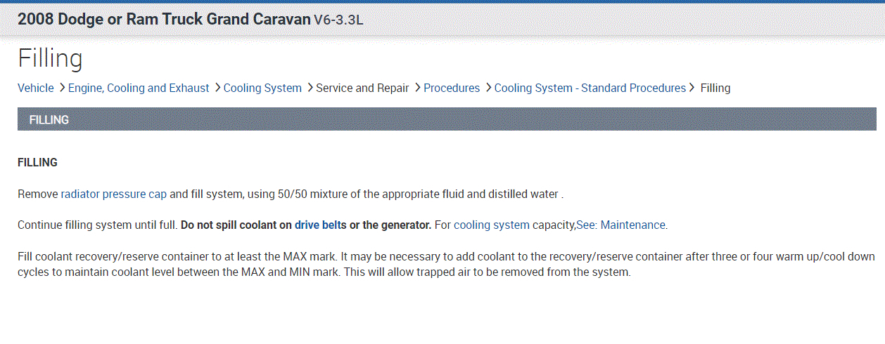

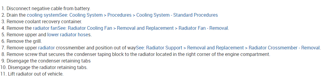

I noticed we didn't hear from you for a couple of days. Have you made any progress? We are interested in knowing.
Also, I wanted to provide the directions or radiator replacement just in case you need them or run into trouble. Also, I included the directions for cooling fan removal and coolant refill.
I hope this helps.
Thursday, April 8th, 2021 AT 7:36 PM

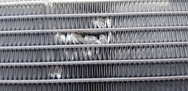

CLOVETT6
  • 8 POSTS

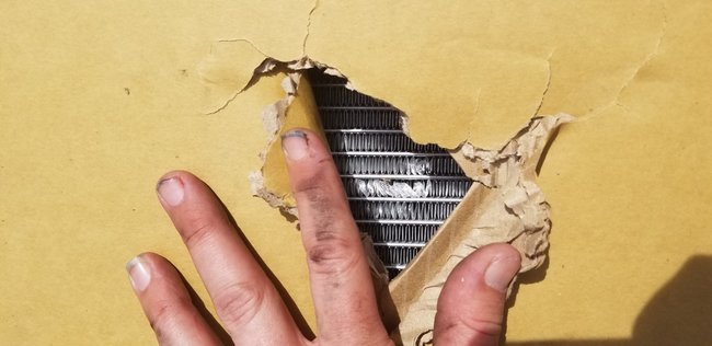

Well, looks like it’s going to be a couple more days before I can get it done. My kids brought the box in when it was delivered and my son brought it out to me after I had taken everything apart. Then I notice the box.
I called 1aauto and they are sending another one but won’t be here until Tuesday.
Friday, April 9th, 2021 AT 10:35 AM
STEVE W.
  • 15,695 POSTS
Ouch! I'd probably pressure test it and put it on the shelf if it didn't leak (or evil bay it). One of the things I dislike with aluminum cores over good old copper/brass. On those you could cut out those tubes, solder them up and be done. On aluminum you can sometimes repair them, but it's a lot more work.
Friday, April 9th, 2021 AT 6:04 PM
