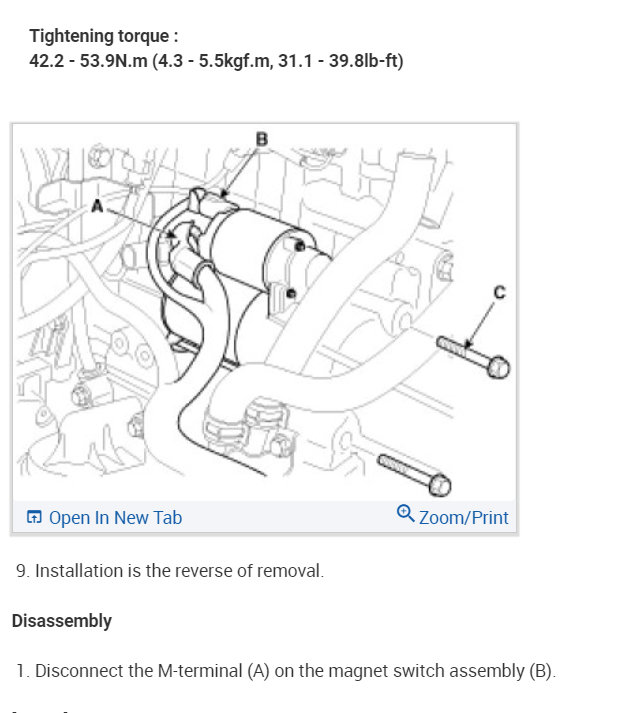

Reinstalling and cannot get the new one aligned into the bell housing.

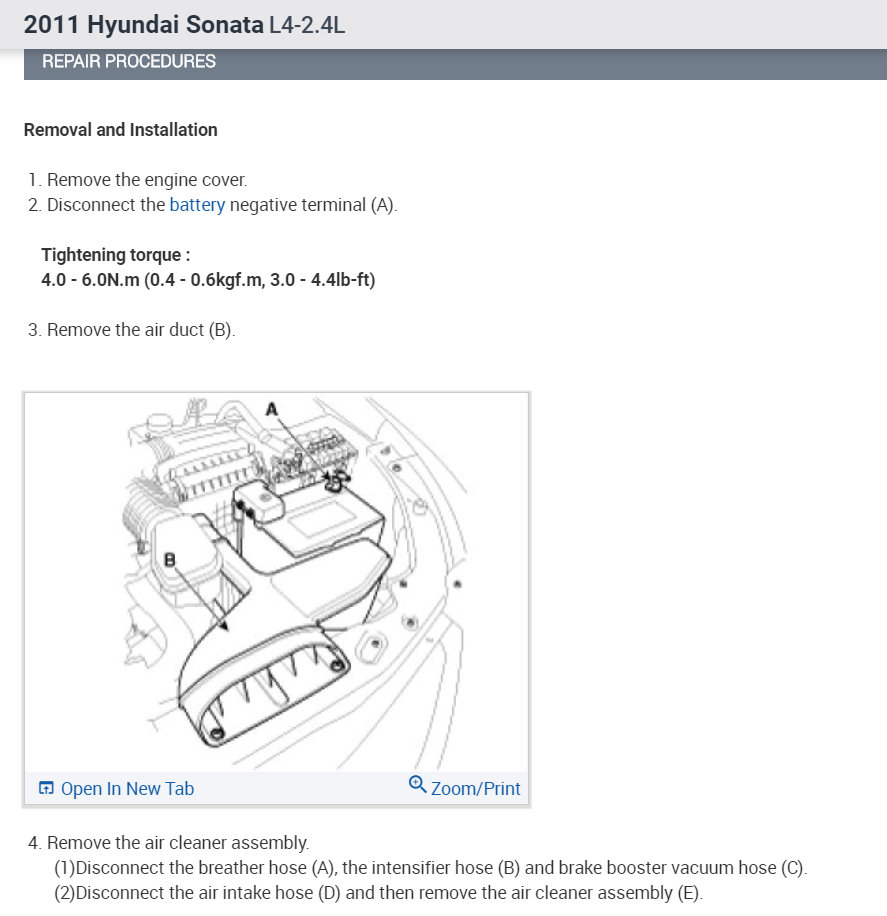

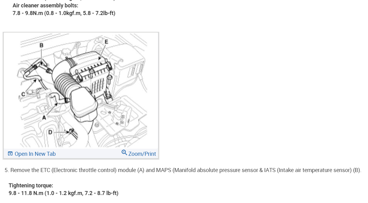

If the bolt holes are not lining up you could have the wrong starter here is a guide to help you install it correctly with diagrams below to show you how on your car.

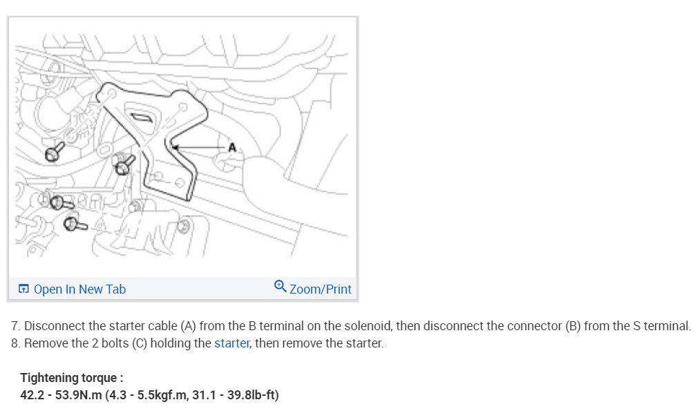

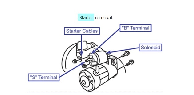

Remove negative battery cable. Remove cable then connections from starter S terminal. Remove the two bolts holding the starter. Don't let the starter fall out and hit you in the face.

Where exactly is the starter located on this 2010 sonata 2.4 engine
I bought a starter need to replace it. Any suggestions would be great-but I have to find the thing first.-Ive replaced starters in other cars
the car has 148k miles
thank you very much for any info!
Im not a mechanic, so please tell me if im looking at the front of the engine, where would it be?
Monday, December 2nd, 2019 AT 1:55 PM (Merged)
  • 110,194 POSTS
It will either be in the front (closer to the driver's side) about oil pan level. It will be bolted in to the transmission bell housing. Check there. If it isn't there, check the rear of the engine, same height. Close to the transmission.
