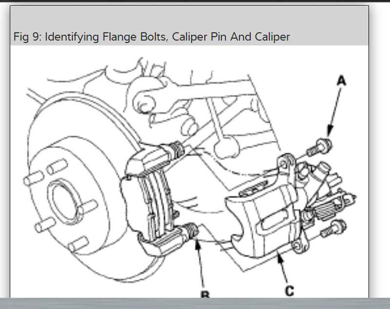

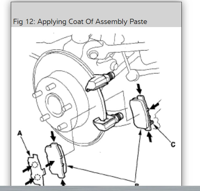

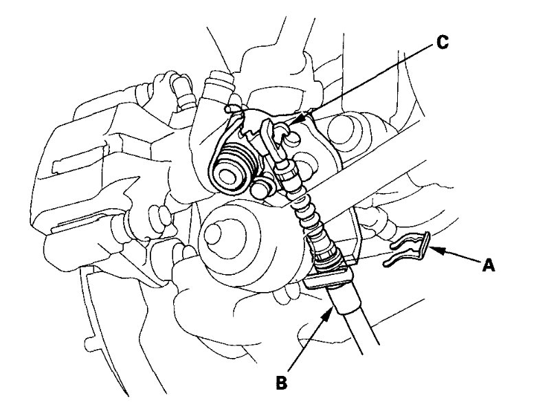

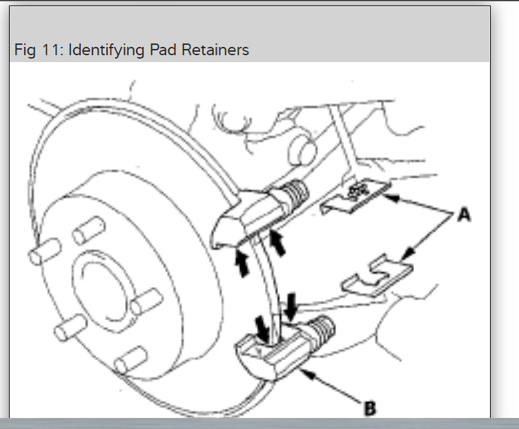

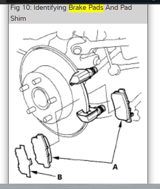

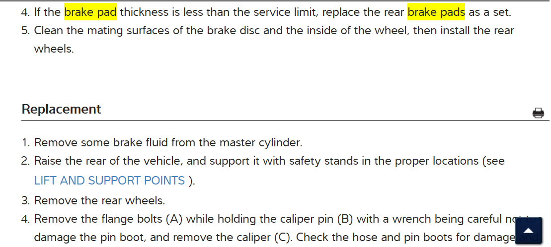

How do I get the emergency cable off of the caliber so I can move the caliber to put the new pads on?
May 26, 2019 at 2:25 PM
SCGRANTURISMO
  • CAR REPAIR CONTRIBUTOR
  • 4,897 POSTS

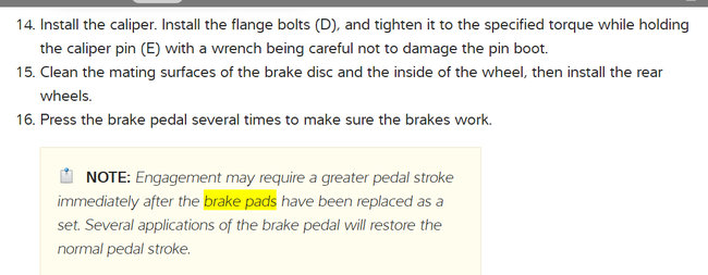

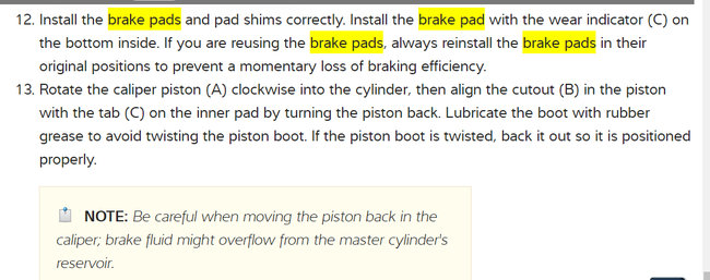

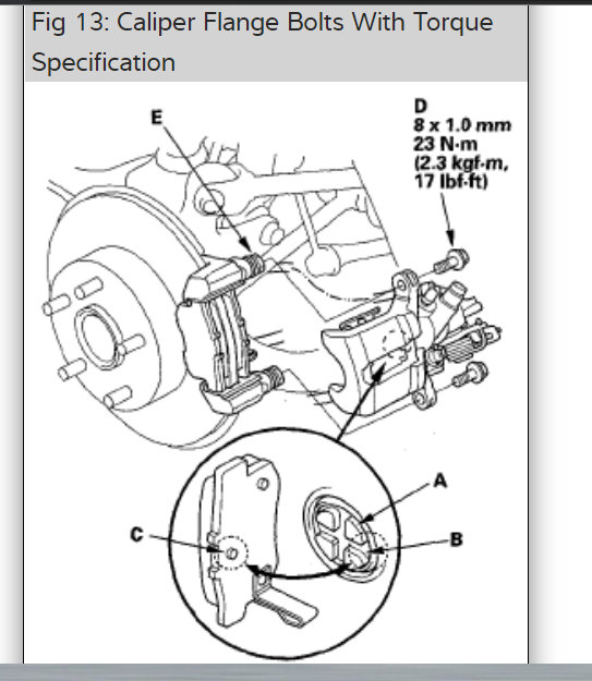

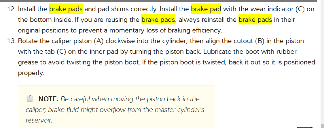

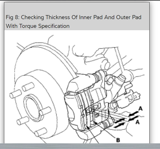

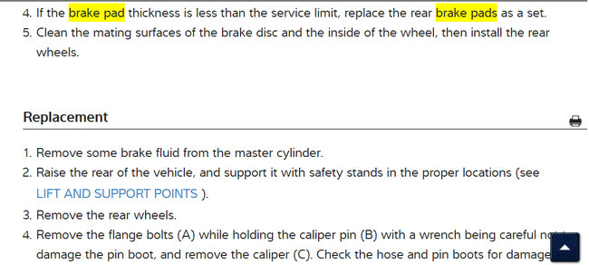

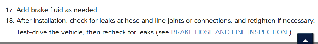

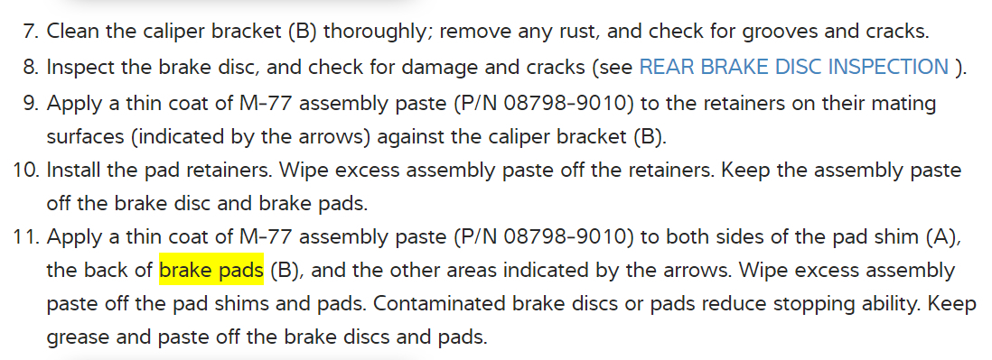

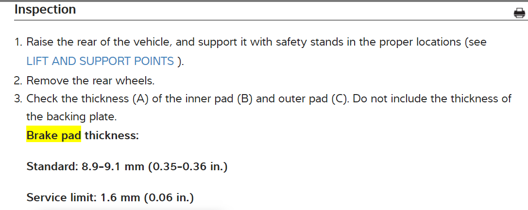

I have included in the diagrams down below the step by step factory guide for the removal as well as installation of the rear brake pads on your vehicle. I also have included a link below for you to go to.
https://www.2carpros.com/articles/how-to-replace-rear-brake-pads-and-rotors
Please go through these guides and get back to with how everything turns out.
Thanks,
Alex
2CarPros

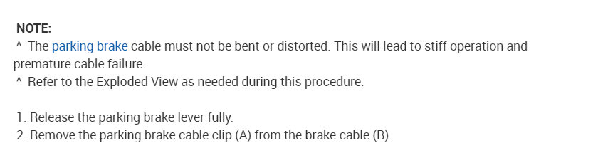

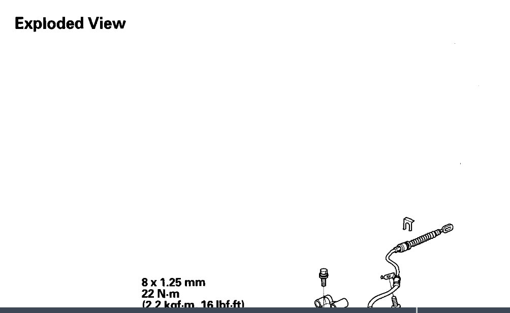

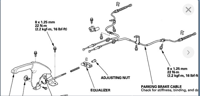

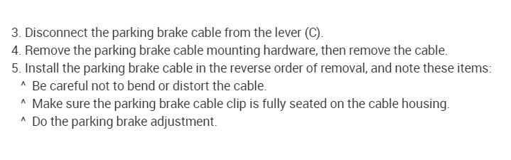

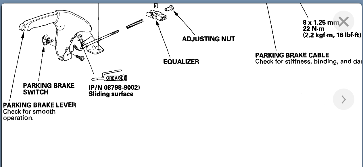

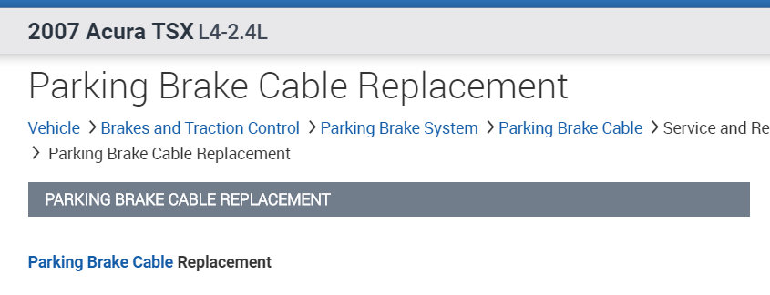

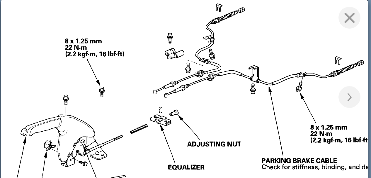

I understand this,but I can’t get the caliber off the rotor because the emergency brake is on the caliber. how do I get the emergency brake off the caliber? no room to get the caliber off unless the cable is off the caliber.
May 27, 2019 at 2:30 AM
SCGRANTURISMO
  • 4,897 POSTS
Hello again,
Sorry about that. I figured that Acura would have included that in the instructions it was necessary to do when changing your rear brake pads. Nevertheless, I have included the information the you requested in the diagrams down below. Please go through the guide and let us know how it turns out.
Thanks,
Alex
2CarPros
