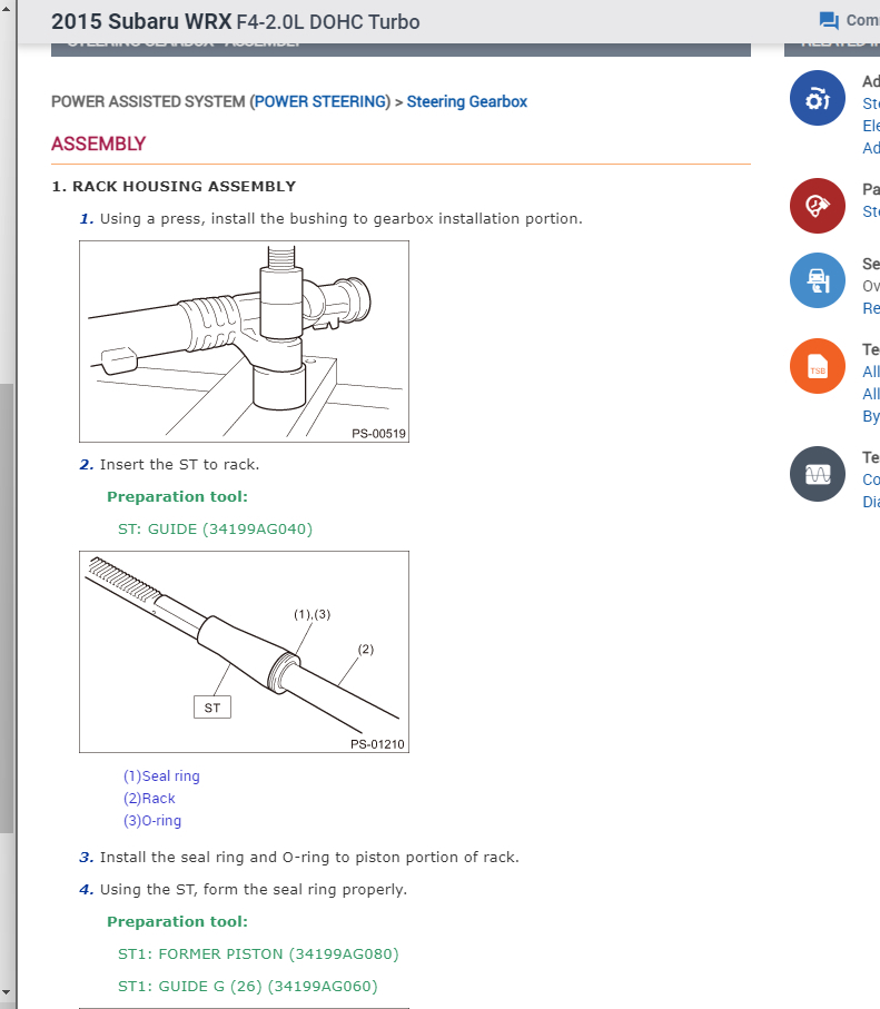

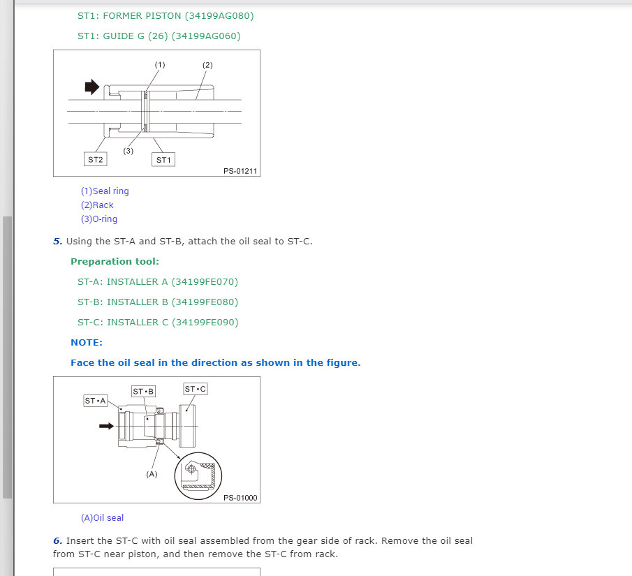

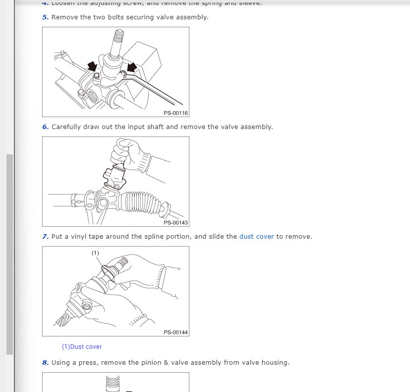

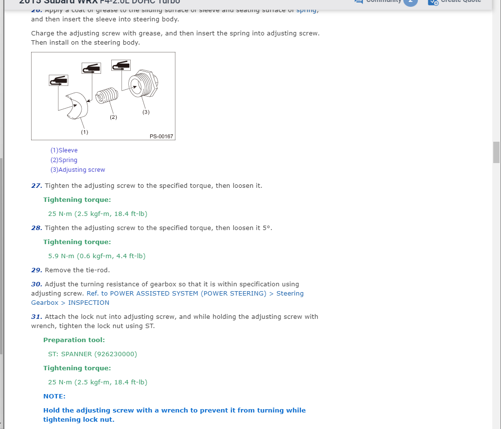

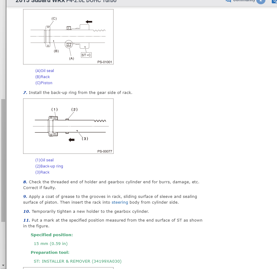

Replacing rack and pinion seals
2015 SUBARU WRX
51,000 MILES • 4 CYL • TURBO • 4WD • MANUAL
DIVIDES
  • 903 POSTS

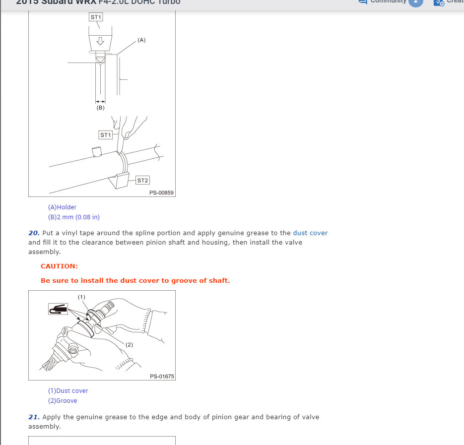

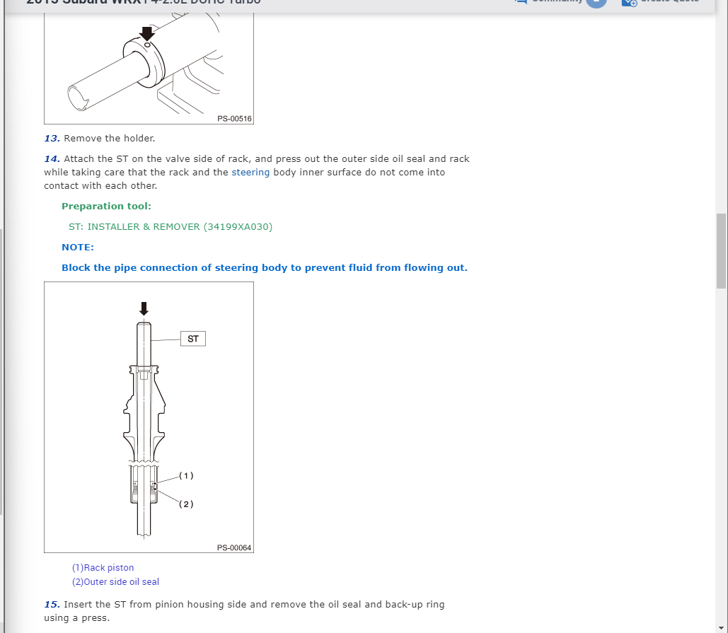

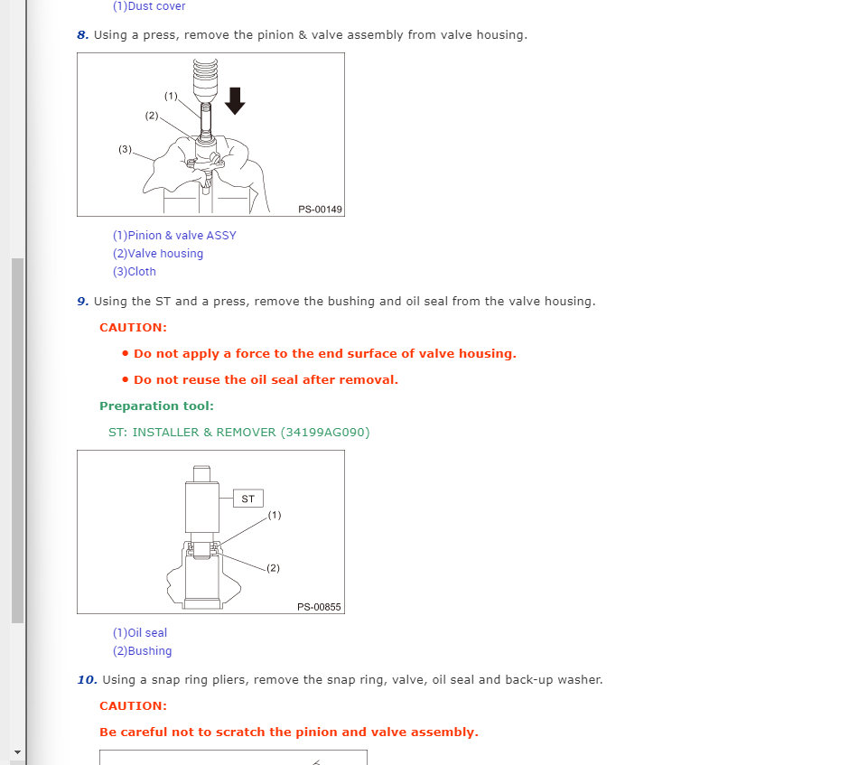

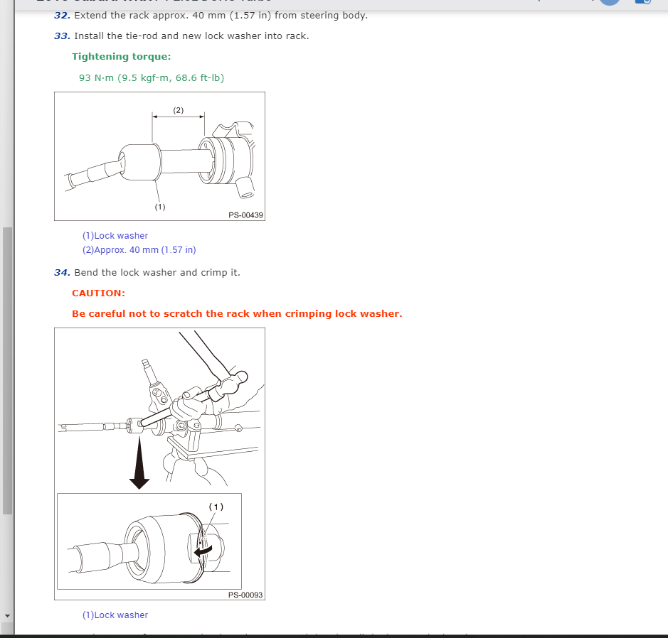

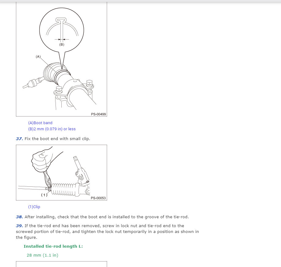

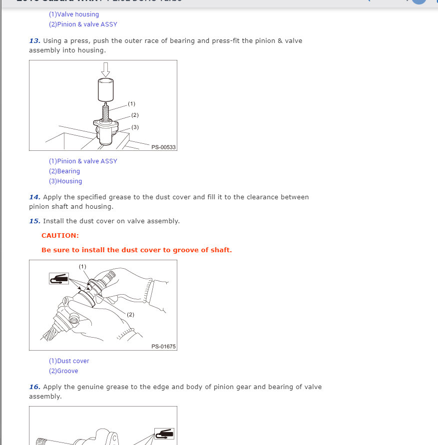

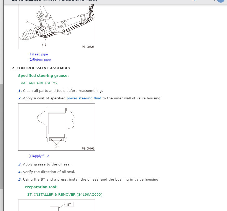

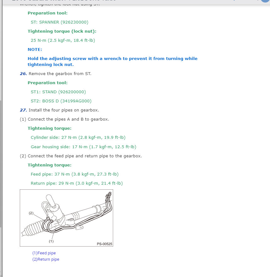

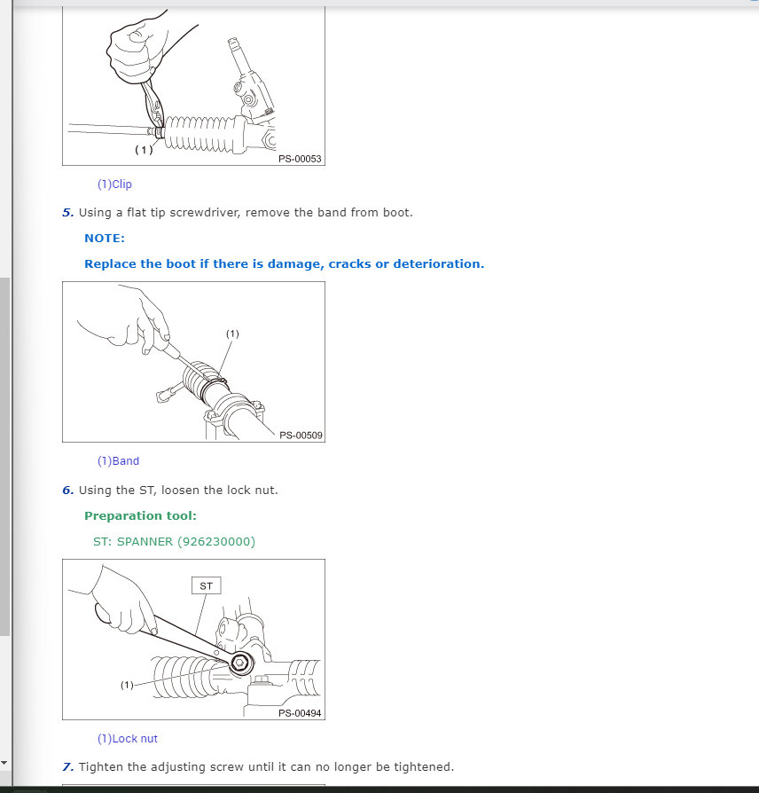

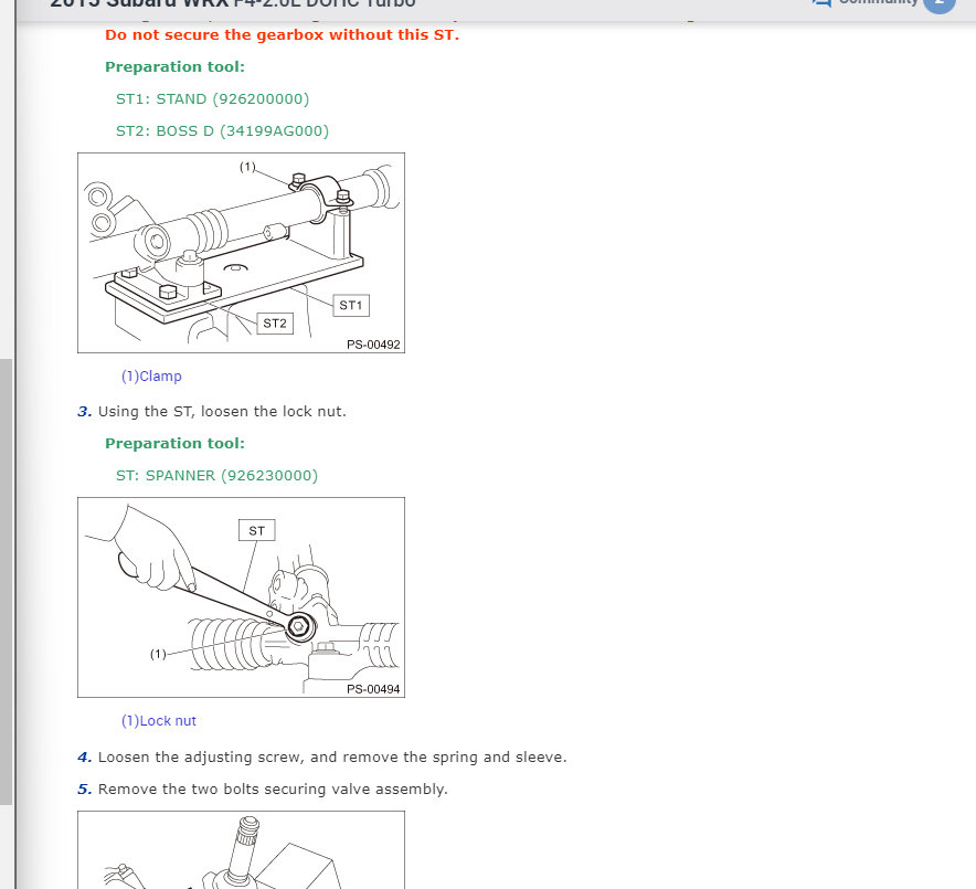

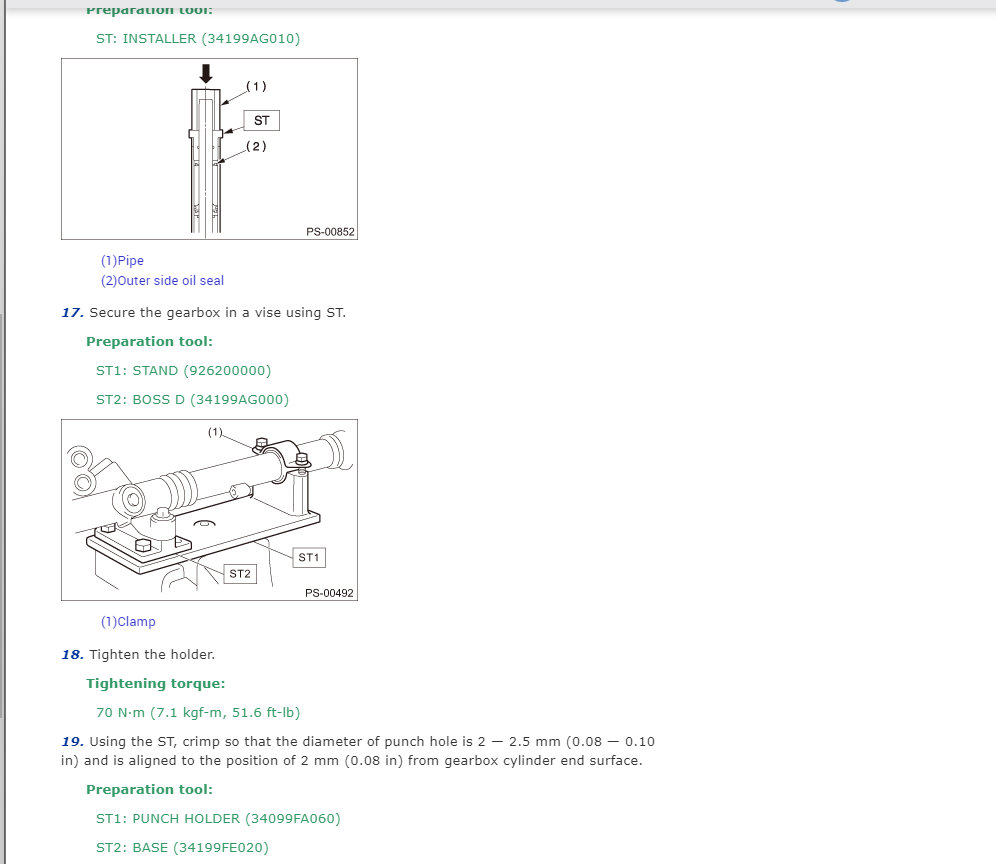

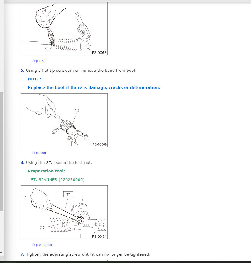

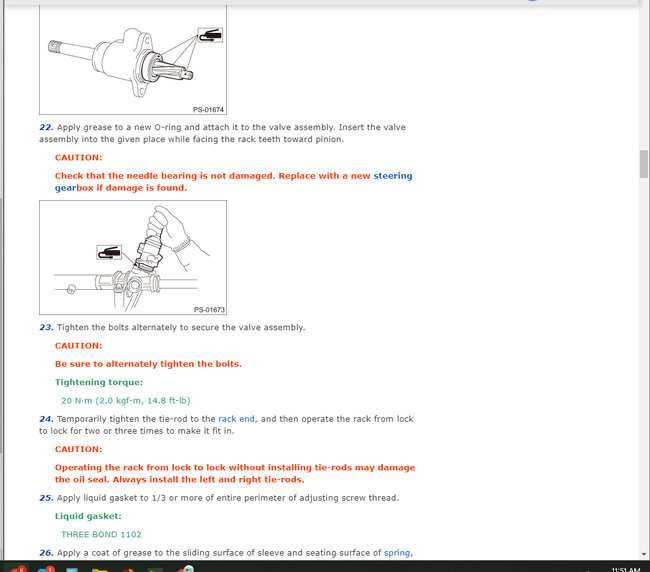

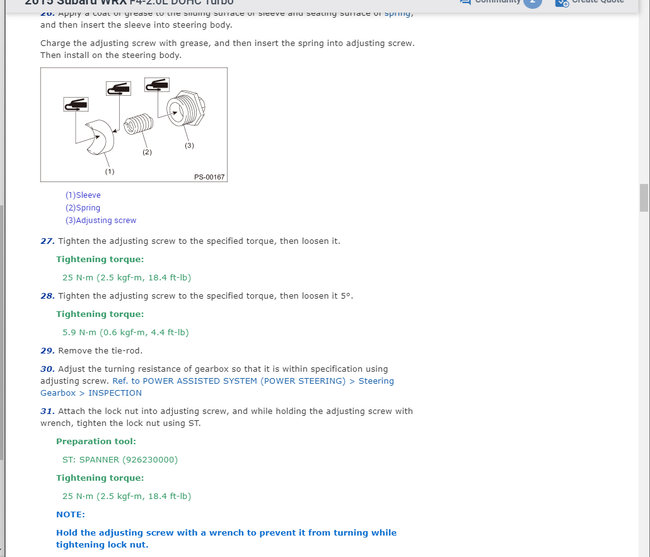

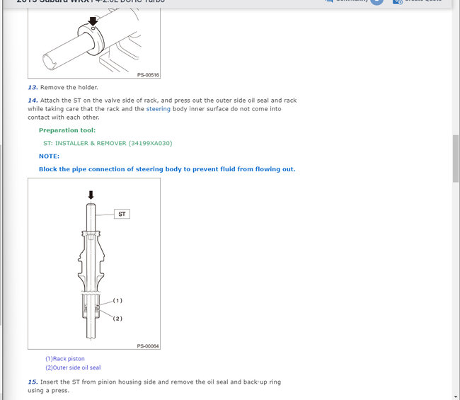

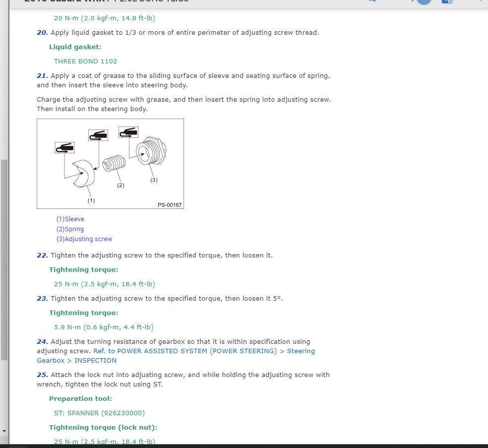

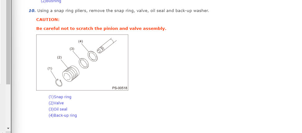

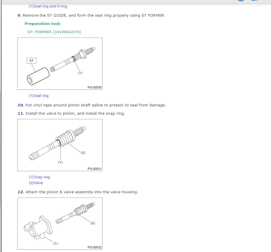

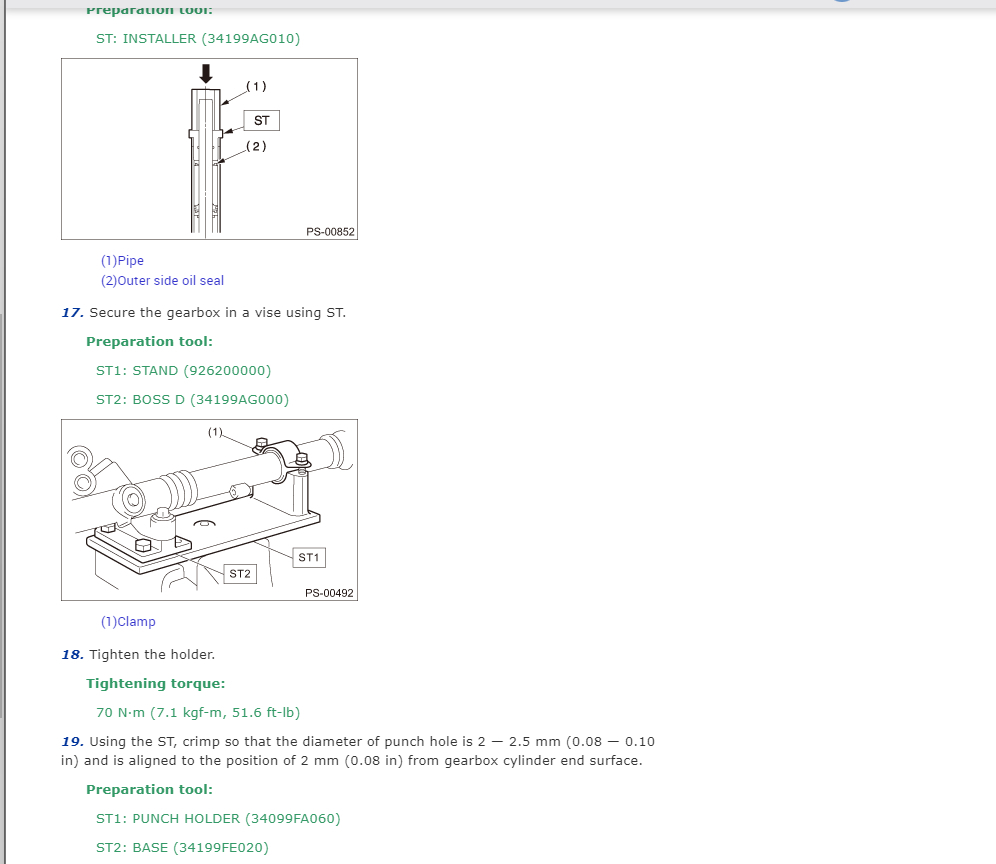

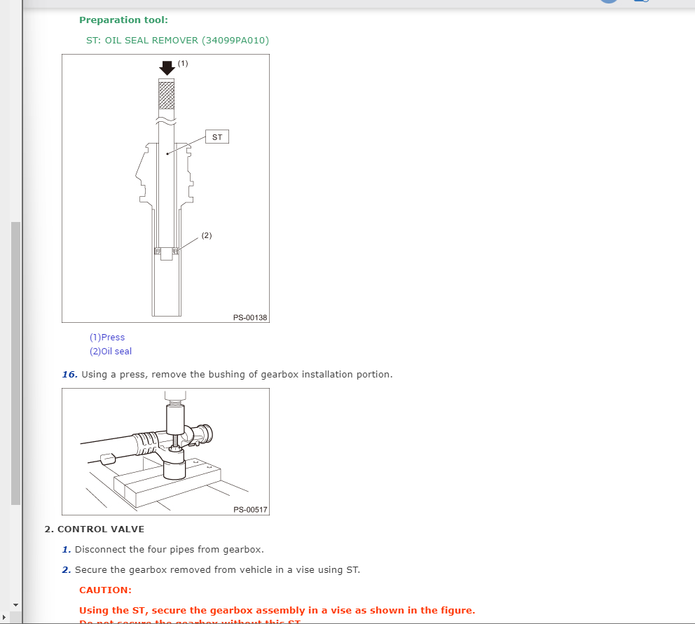

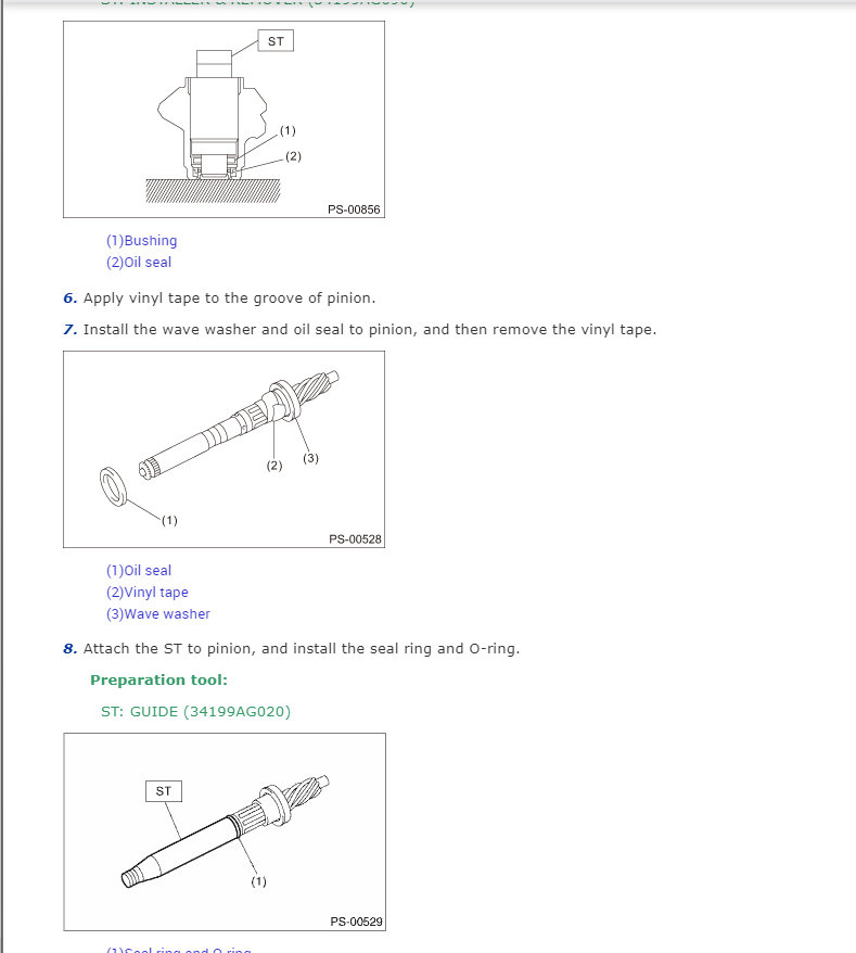

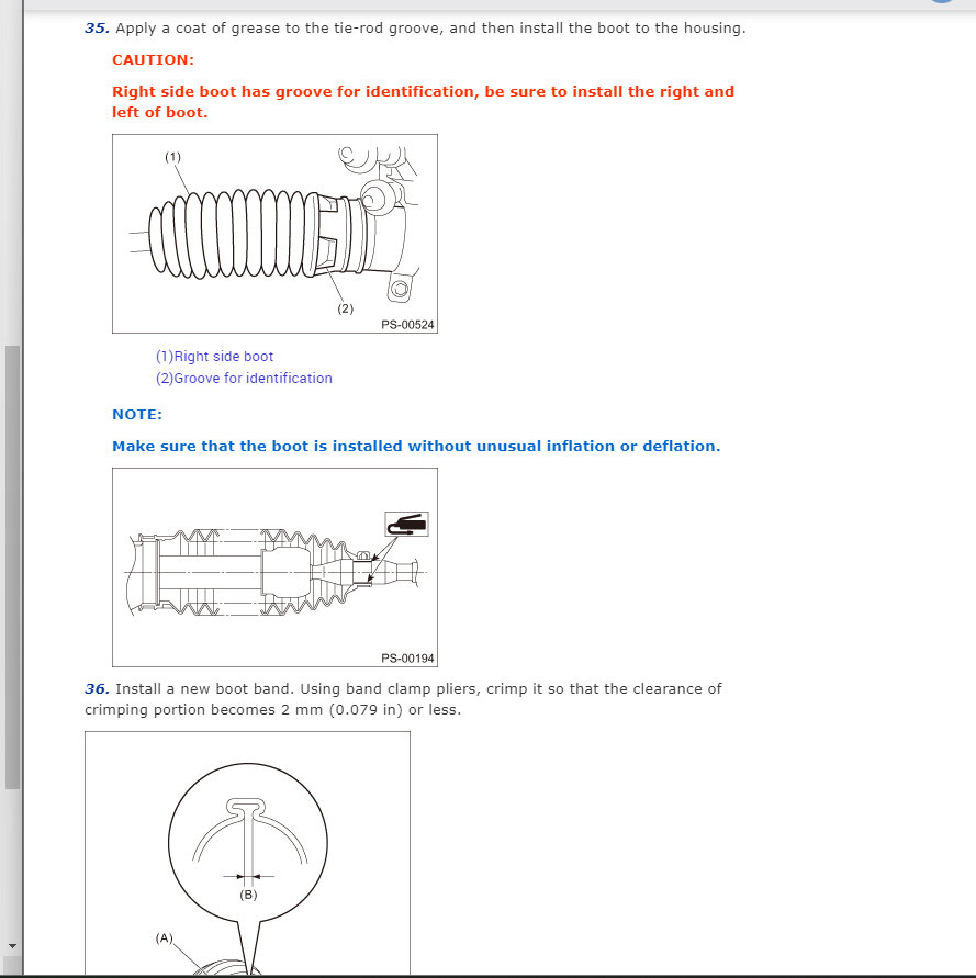

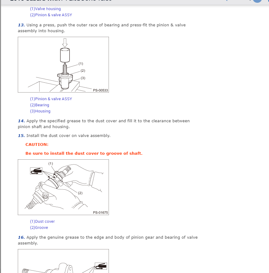

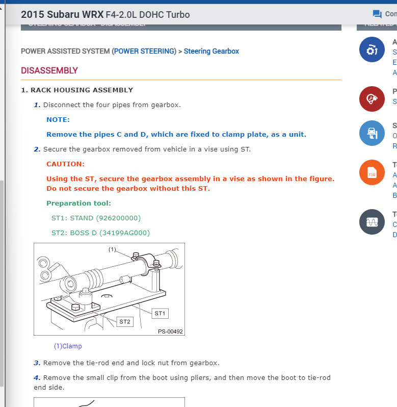

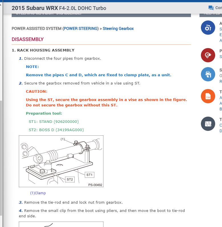

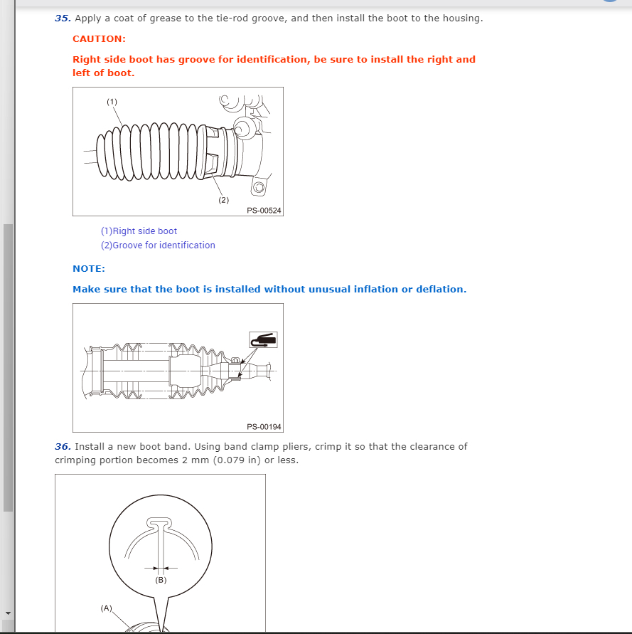

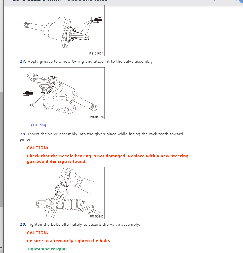

This is a common issue with these, any instructions or TSB on how to change the seals?
Apr 16, 2022 at 2:23 PM

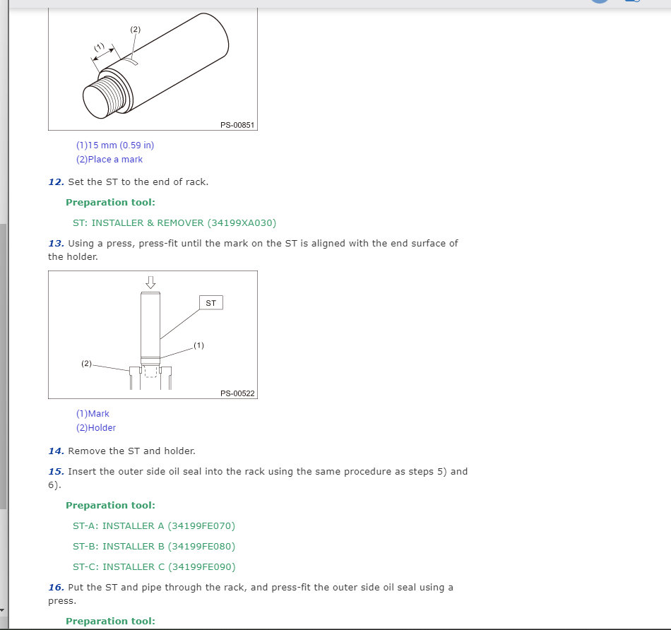

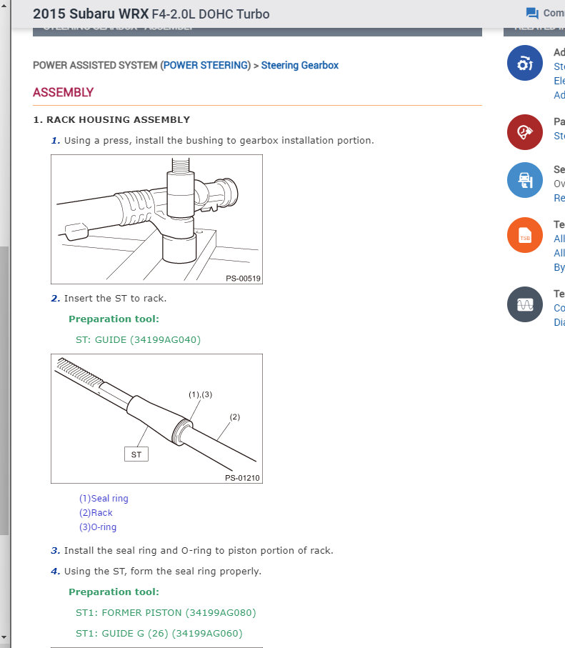

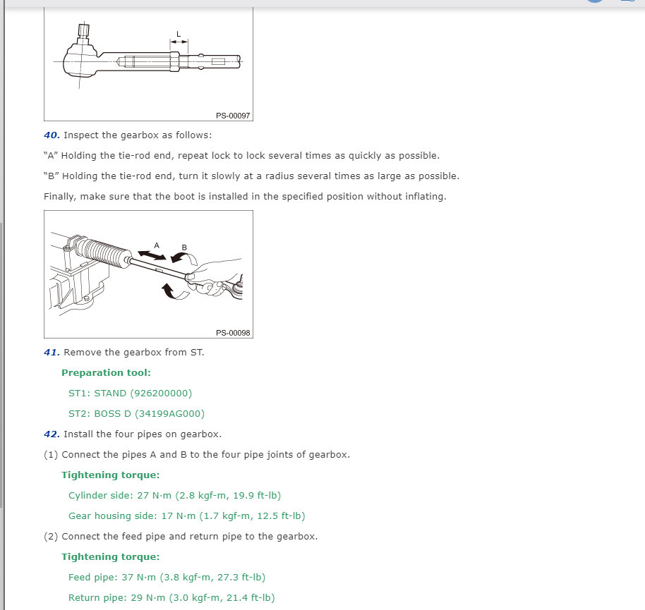

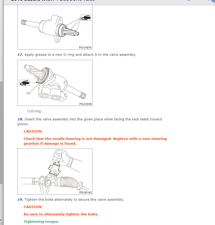

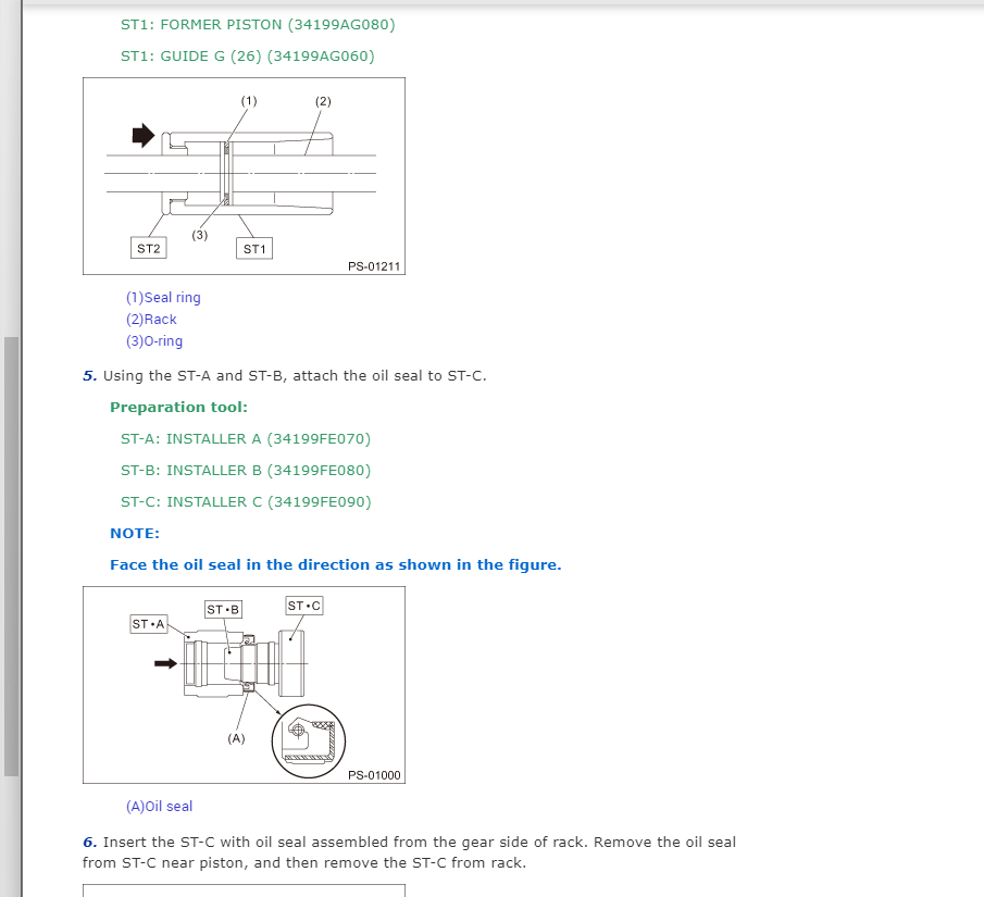

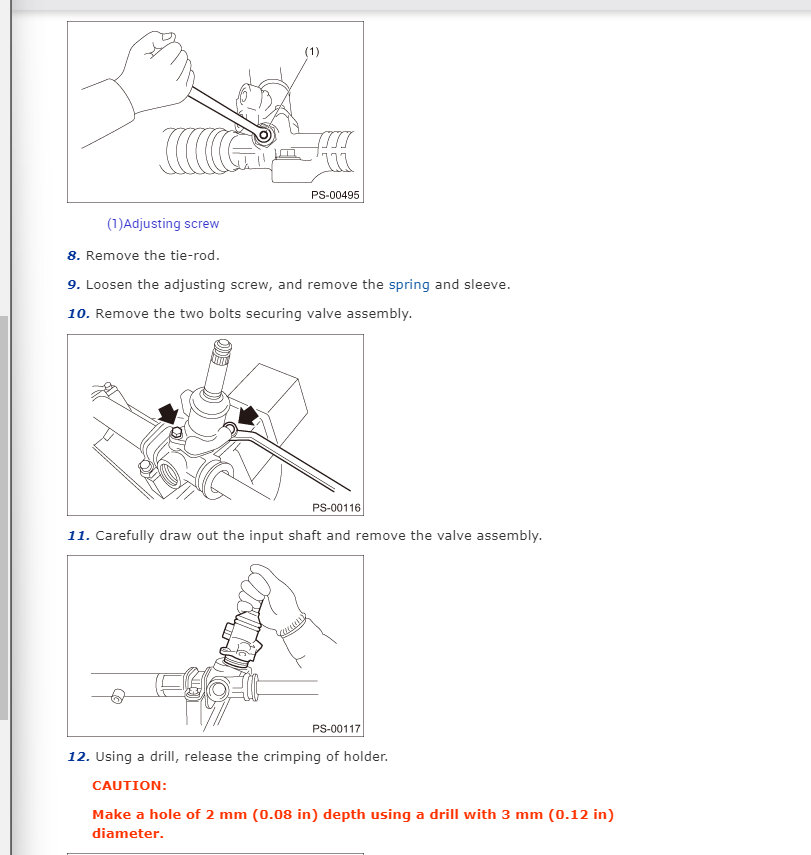

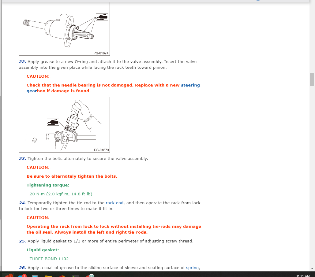

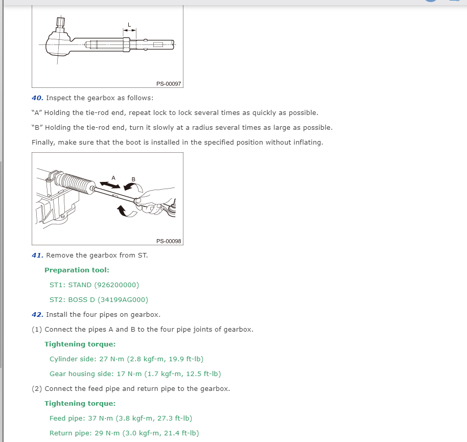

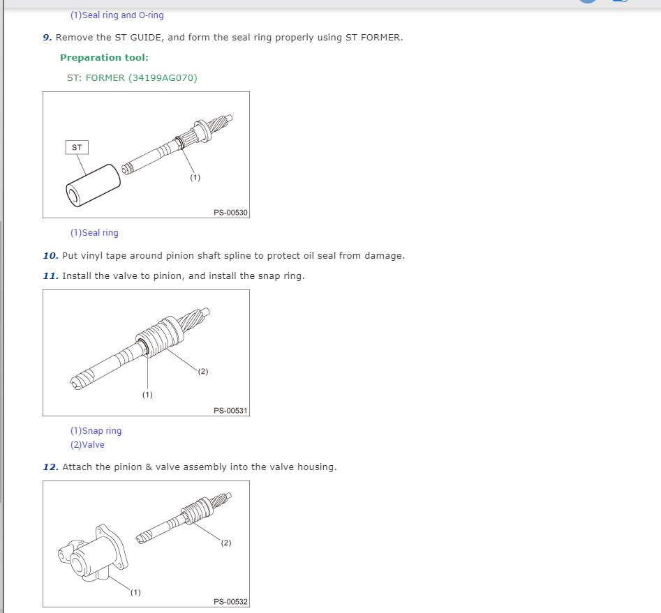

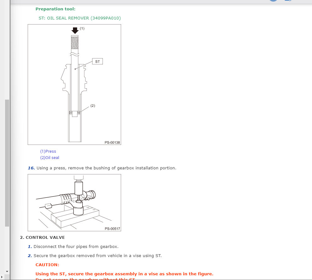

This rebuild process is pretty extensive, but I am attaching the entire process so that you can run through it and see if the portion that you are looking for is included.
Also, here is a guide that will help with flushing it with new fluid:
https://www.2carpros.com/articles/power-steering-fluid-flush
Please see the entire process below and let me know if you have questions on this.
Thanks
