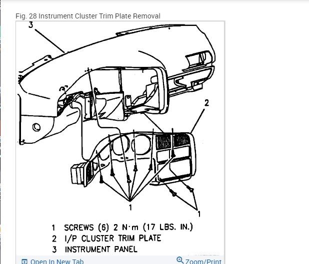

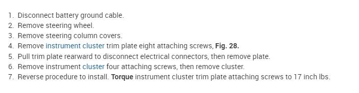

VIN 1G3NL5438PM025097. The instrument cluster has disadvantages. I want to replace it. I am in a region where there are no car services. With the help of gmpartsgiant.com online store, I determined that the original number of this part for my car is 16131528. However, the part with this number is not available for sale. There are parts in stores, for example 16130503, 16132293, 16167223, 16167915 and others. But I don't know which one will fit my car. Tell me please?

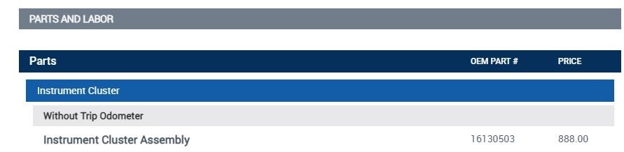

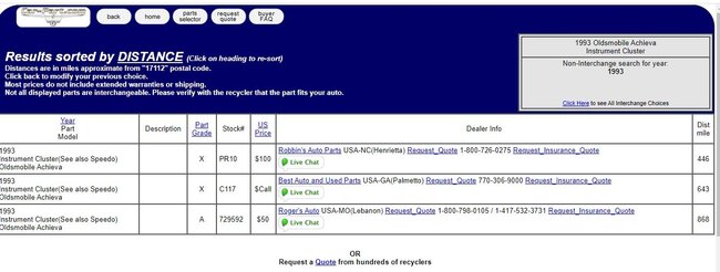

Good morning,
I attached some possibilities from junkyards for you to call and ask for the part numbers to verify the correct one.
I just checked with Aldata and apparently, the part number was upgraded to the 503 clusters you found.
