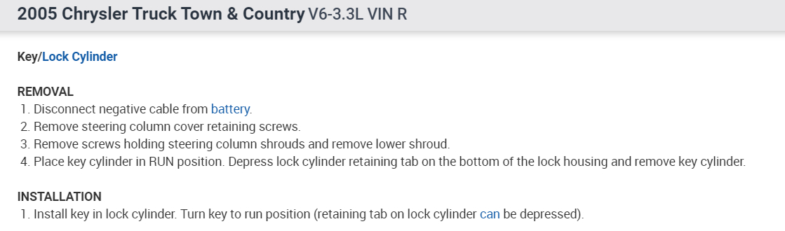

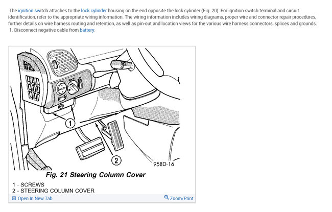

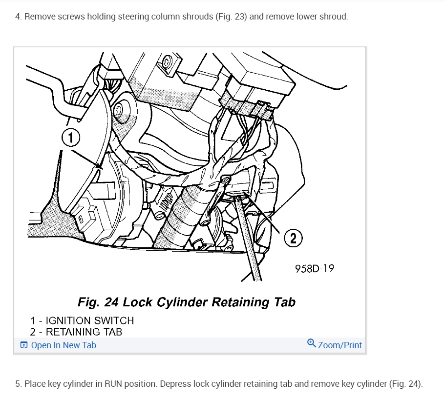

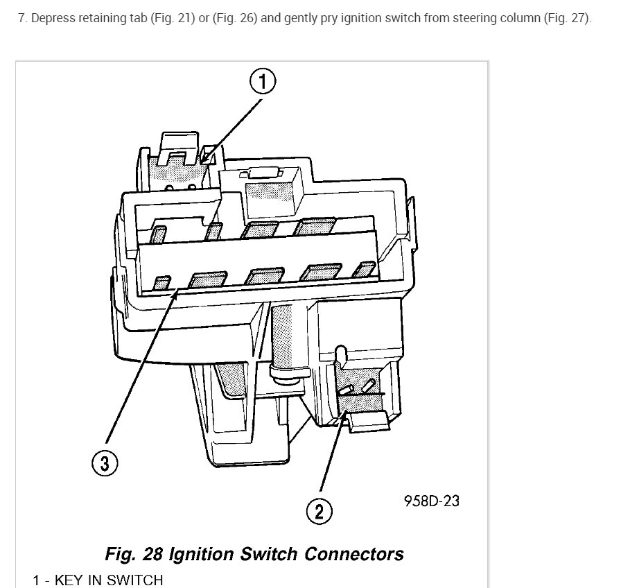

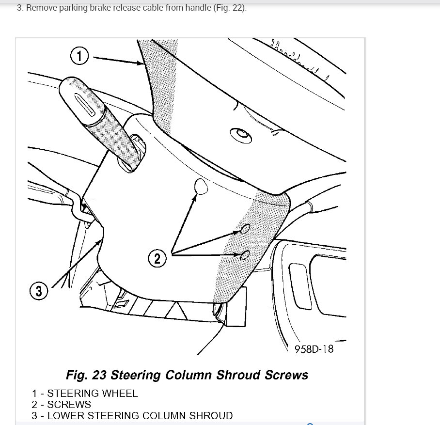

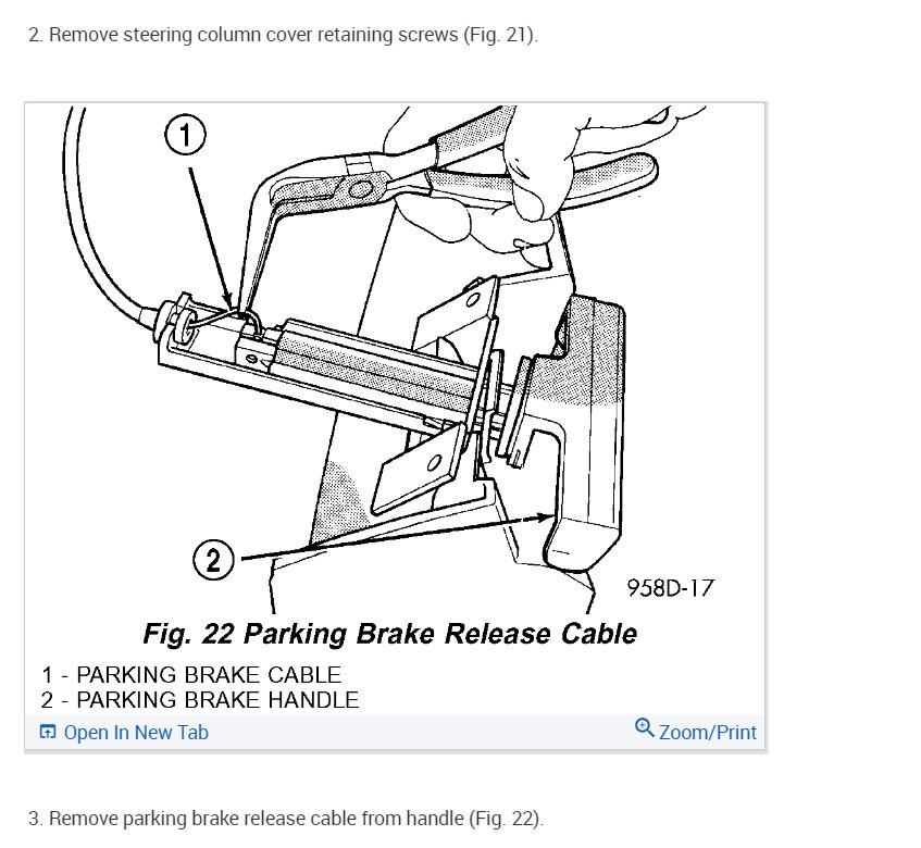

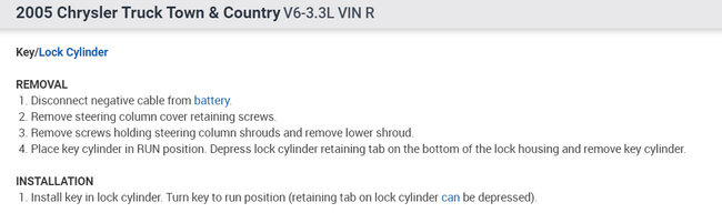

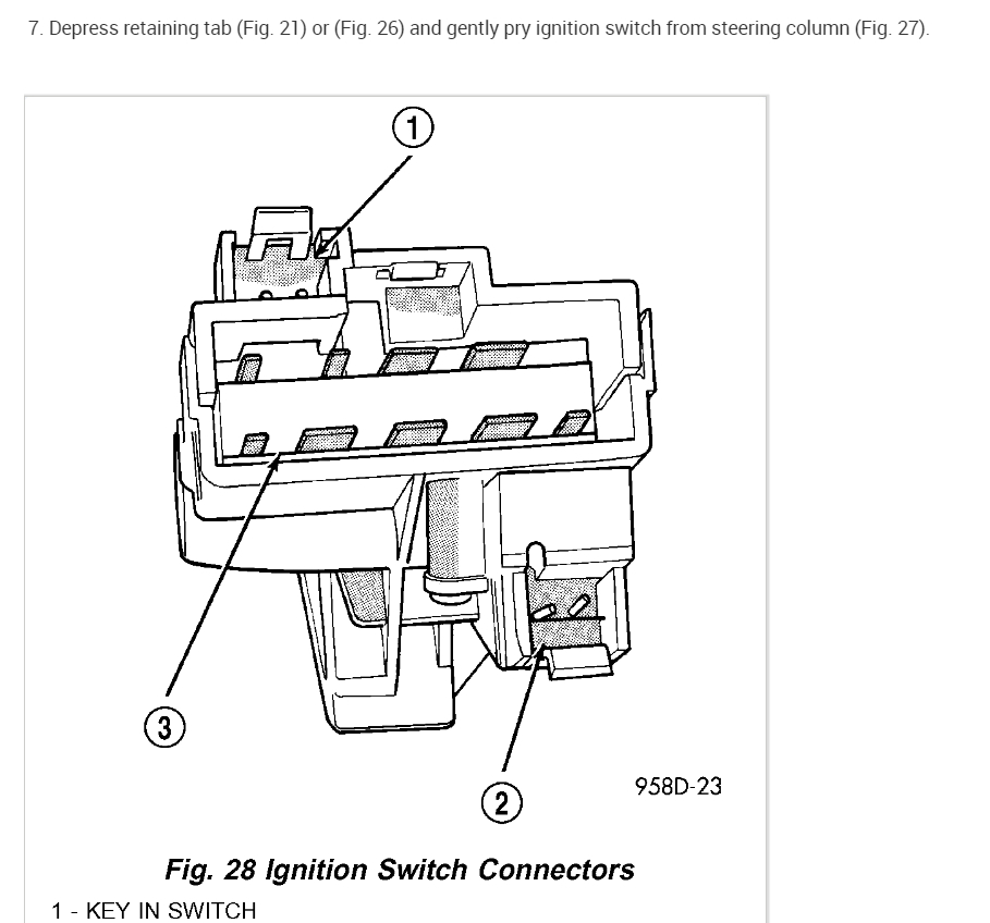

Lost keys about 2 years ago tried to drive anyway broke ignition switch and signal coil around ignition switch.
Mar 19, 2023 at 5:50 AM
  • CAR REPAIR CONTRIBUTOR
  • 54,477 POSTS

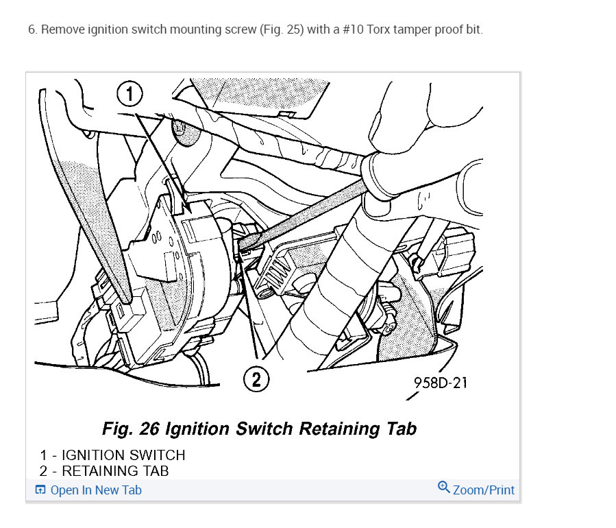

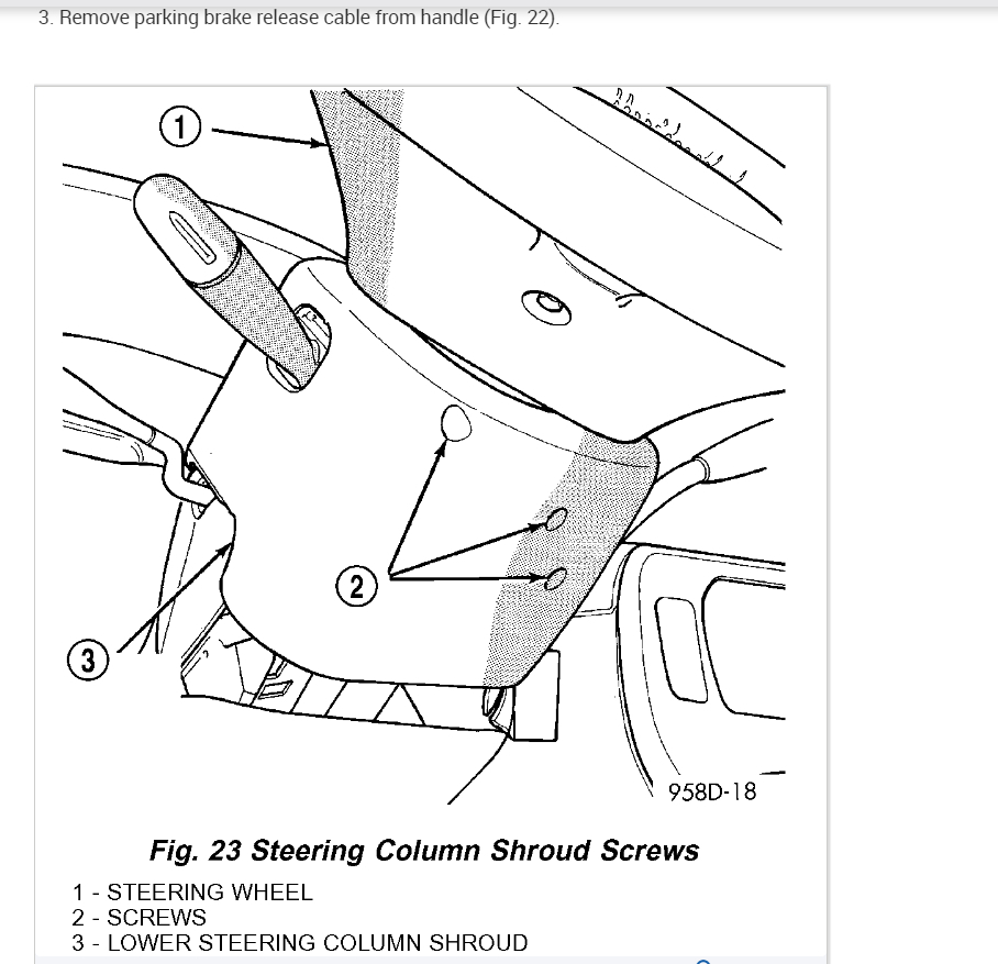

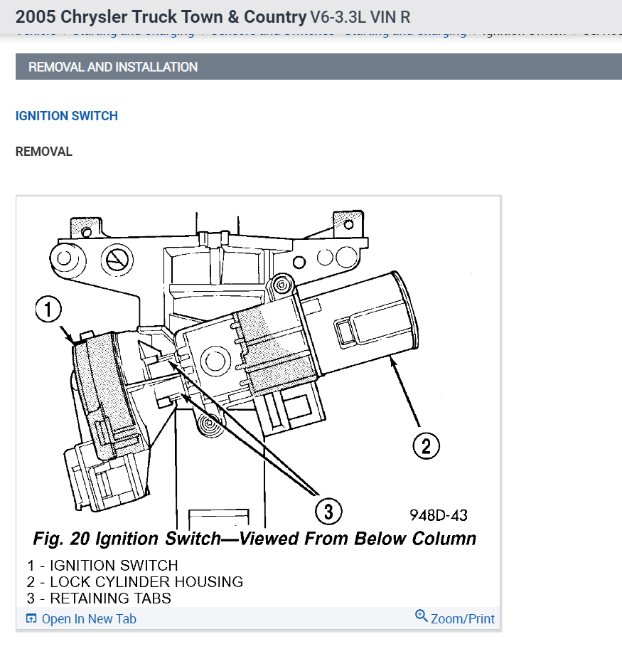

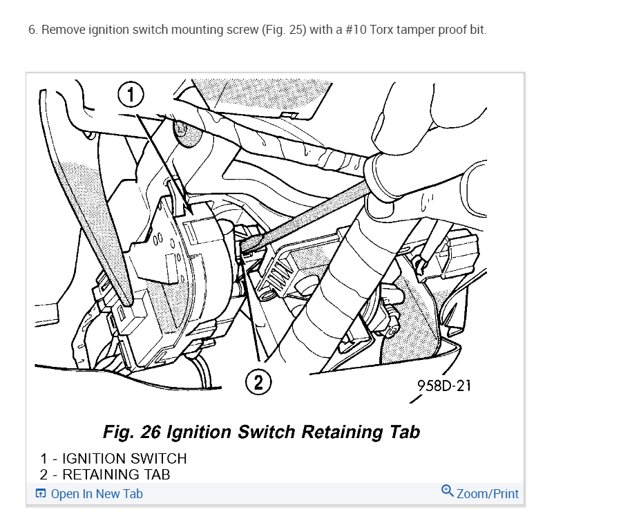

Hi Christina,

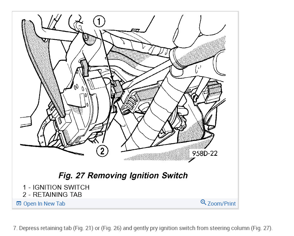

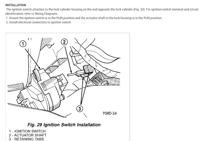

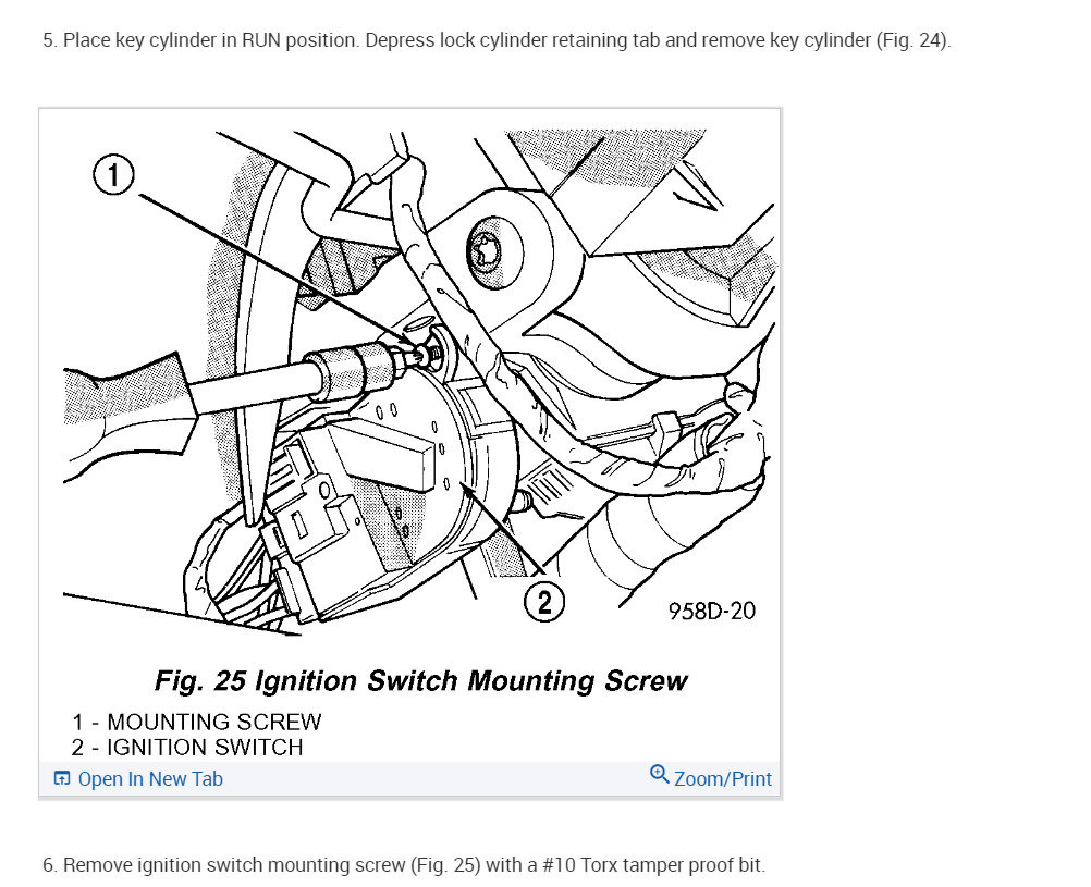

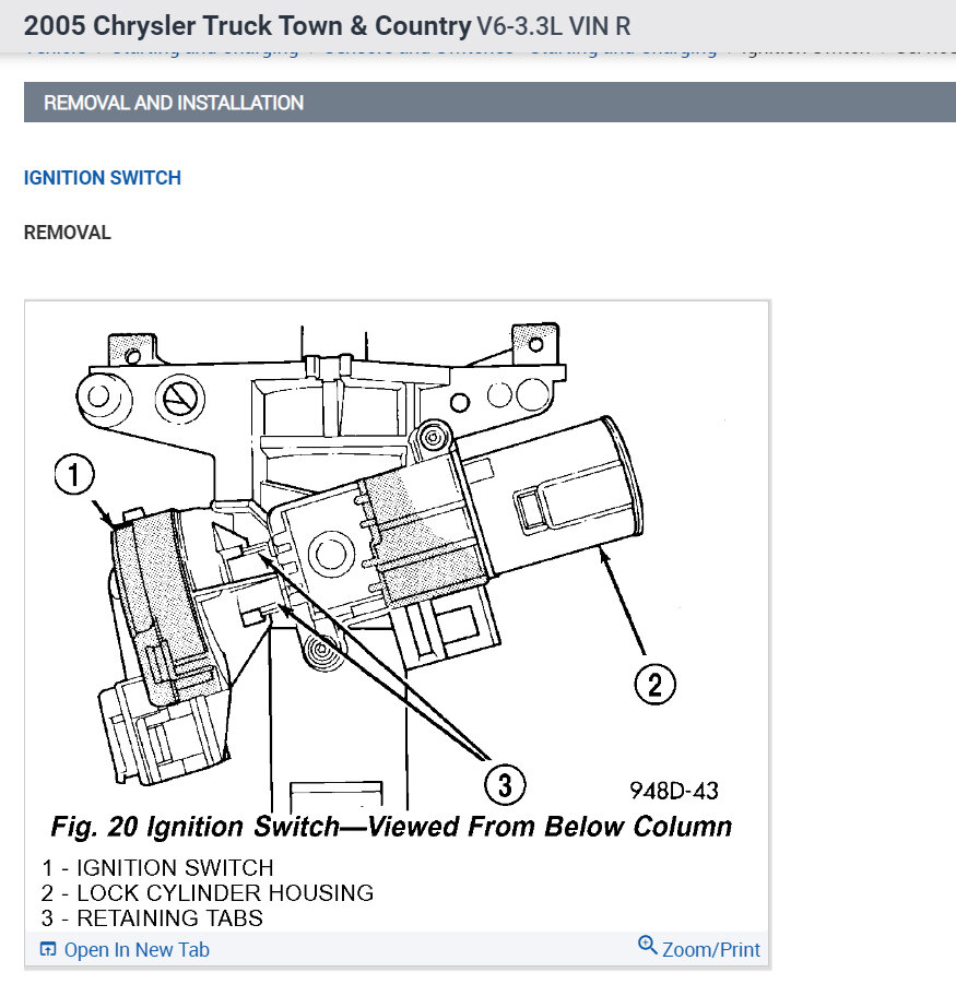

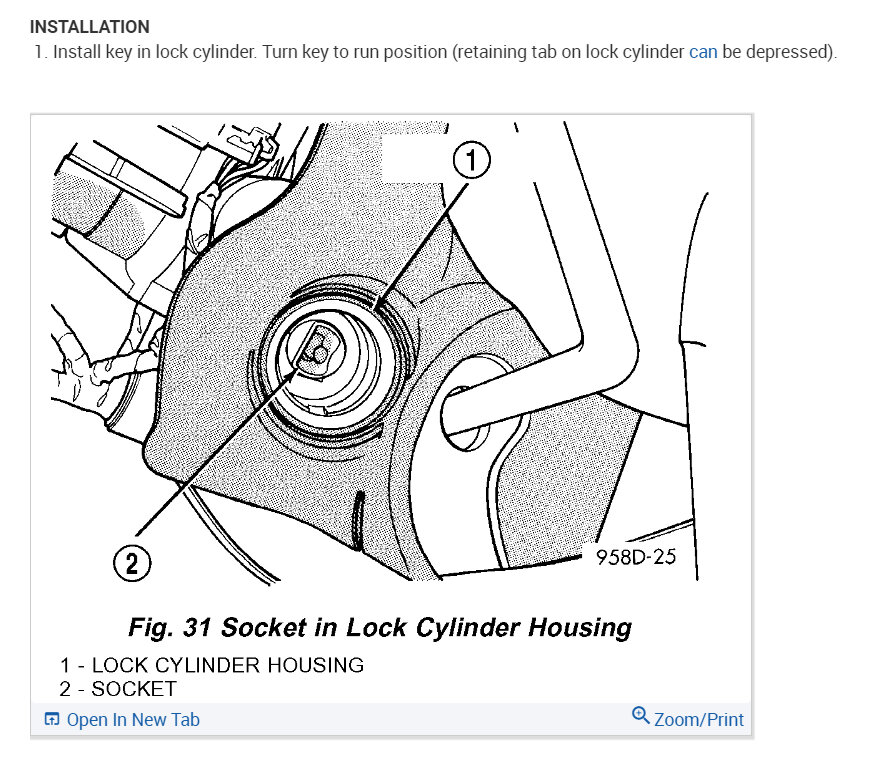

I am not sure what you are asking, do you need instructions to install the new switch if so, here is how the job is done in the images below, but if you can upload an image of the problem, I can help you better. Check out the images (below). Let us know what happens and please upload pictures or videos of the problem so we can see what's going on.
