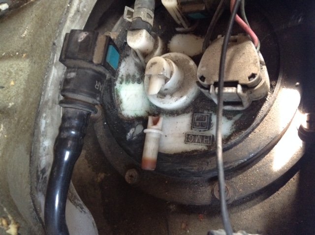

I was replacing my fuel filter when the connector for the fuel inline hose broke. Not on the filter side, on the side with the fuel tank. What am I looking at in terms of replacing this tiny little piece of plastic?

Here is a picture for reference.

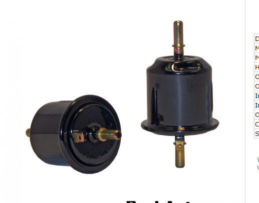

That is the evaporator canister not fuel filter. You will need another one. in picture is a picture of fuel filter. It is above the tank fuel sender.
