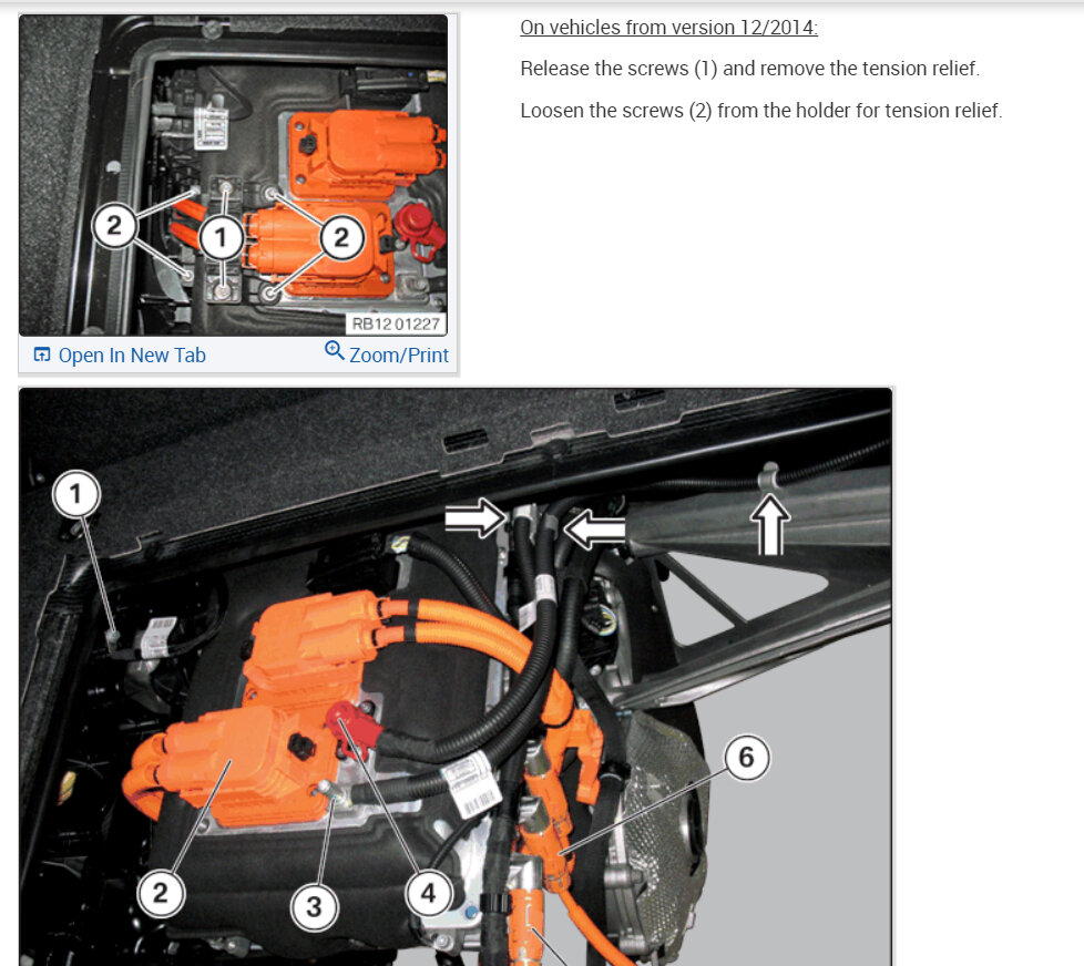

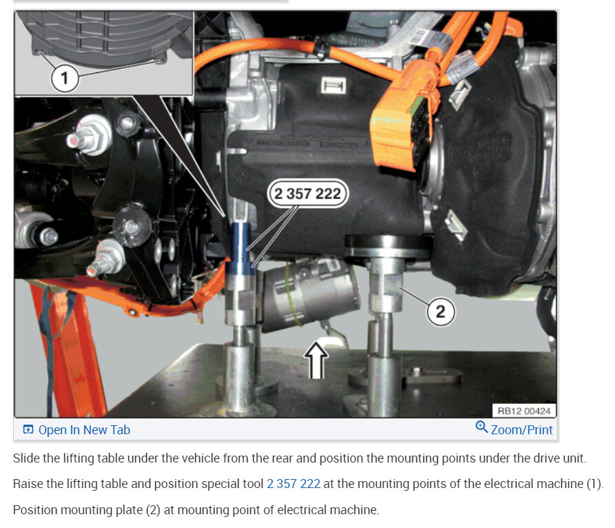

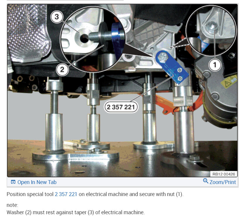

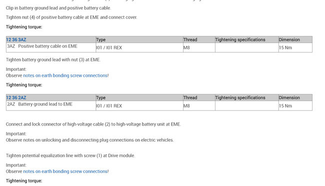

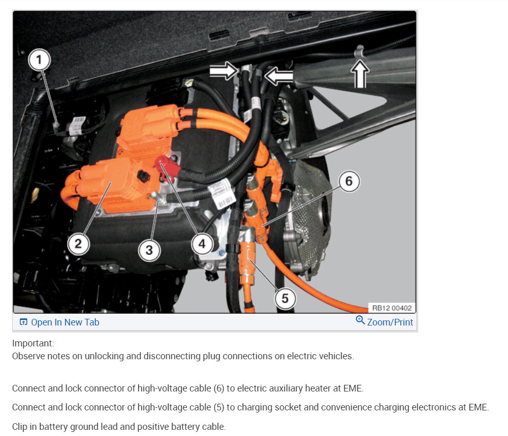

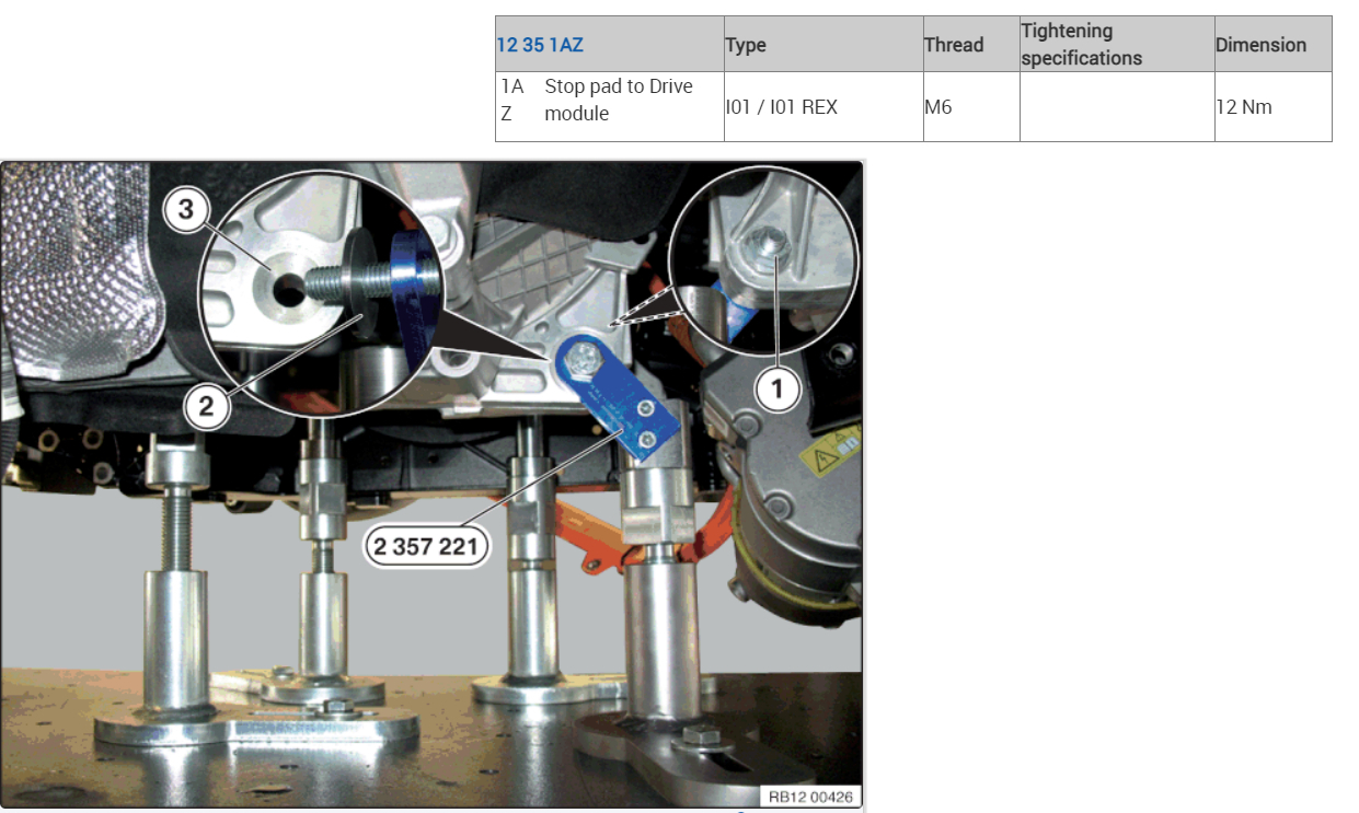

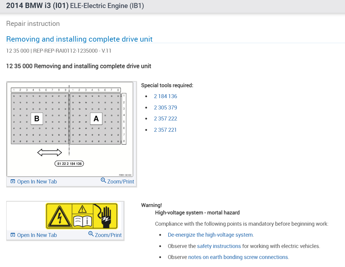

Can you pull any instructions on how to replace the electric motor on this car? Am interested to know if i buy this vehicle. Also, would it require programming?
Aug 20, 2023 at 9:47 AM
  • CAR REPAIR CONTRIBUTOR
  • 54,433 POSTS

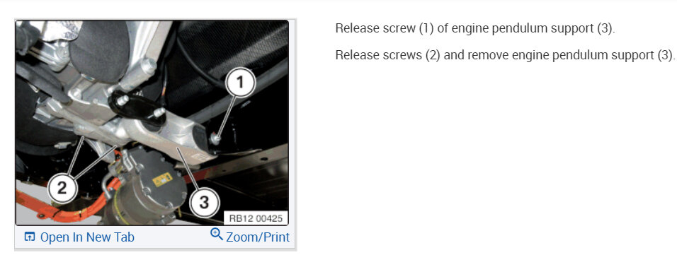

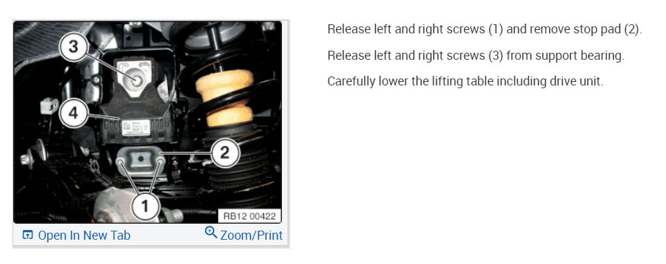

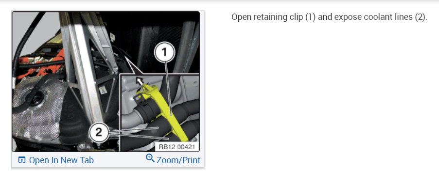

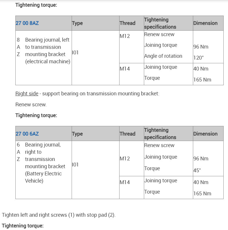

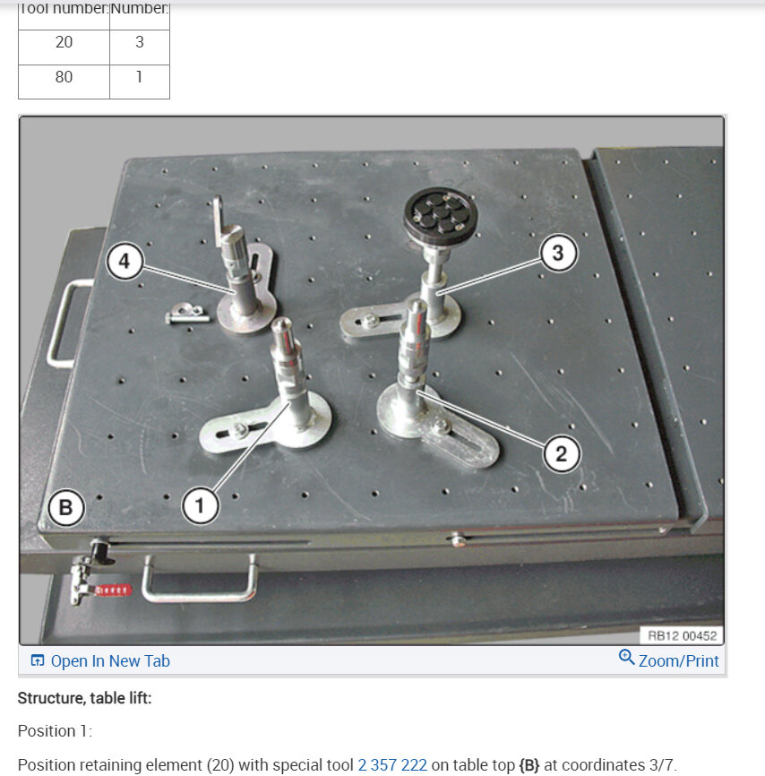

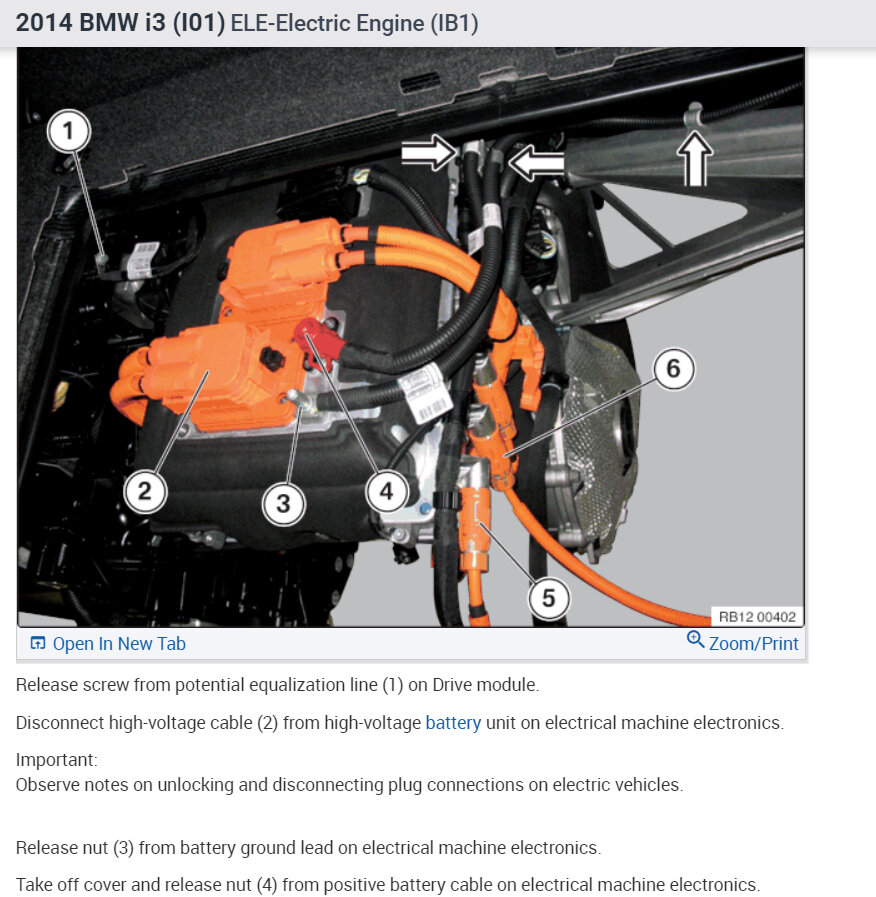

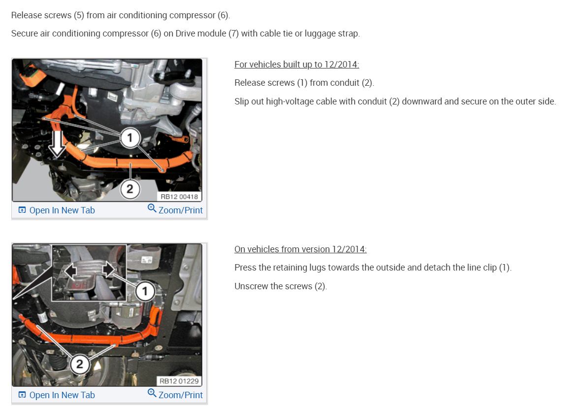

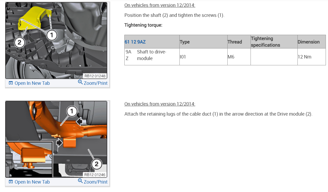

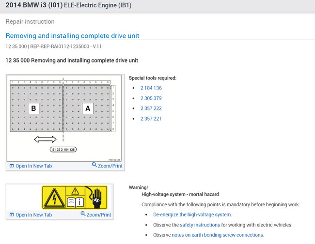

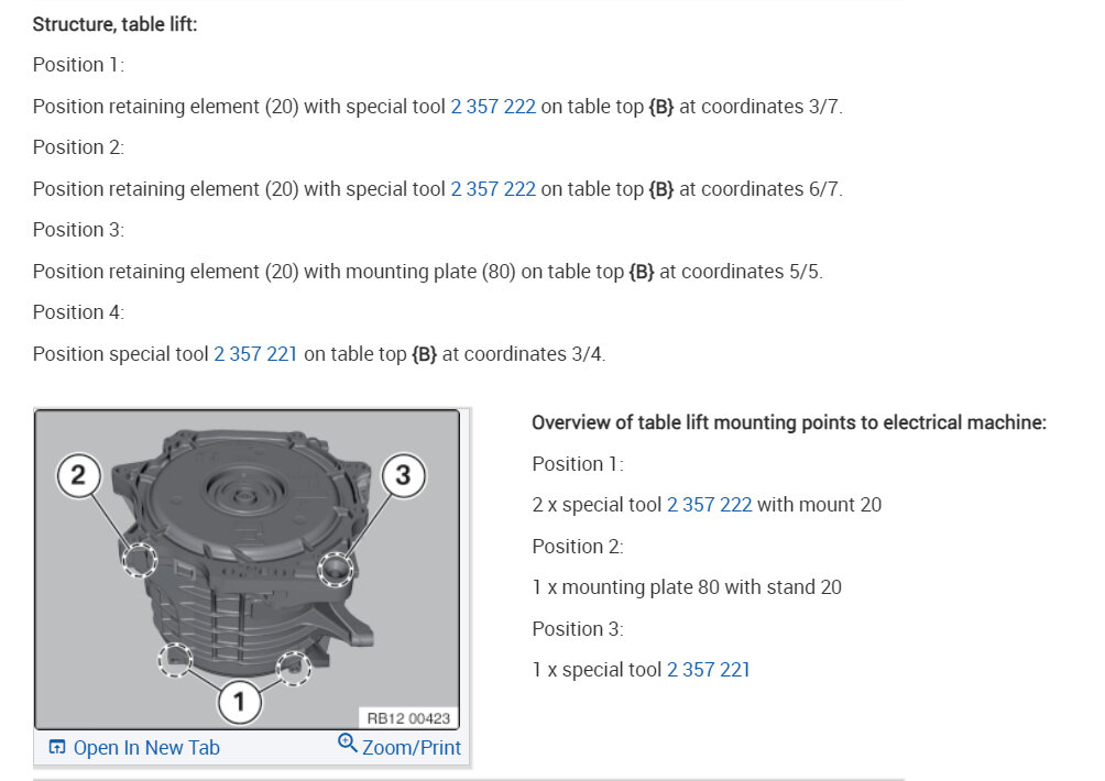

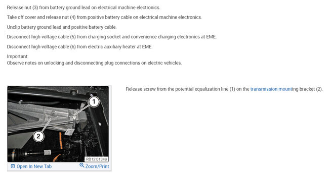

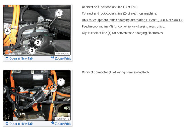

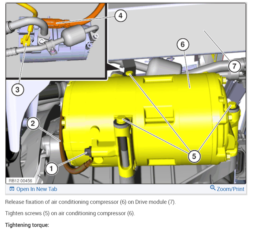

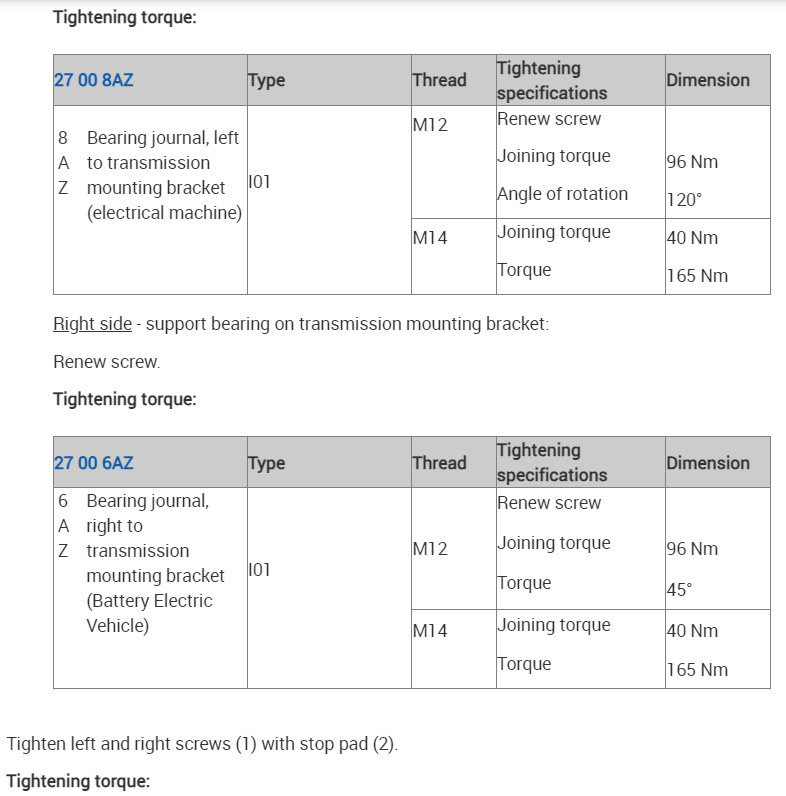

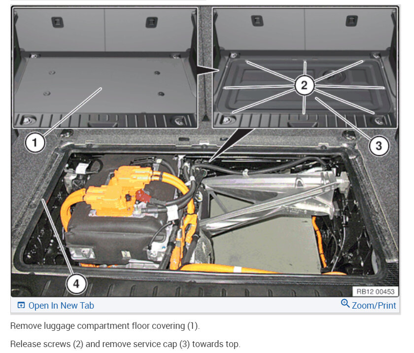

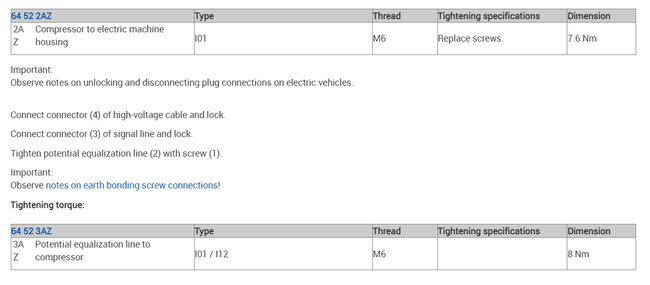

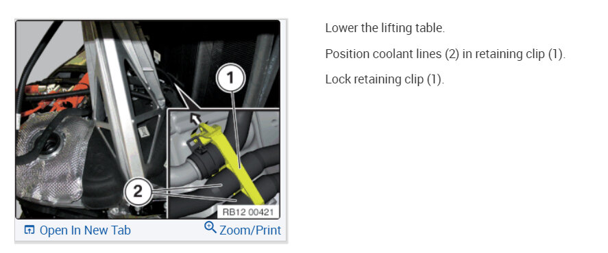

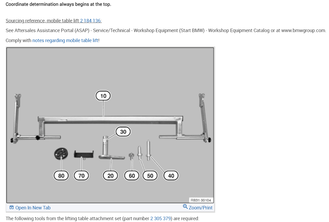

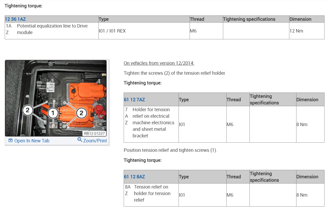

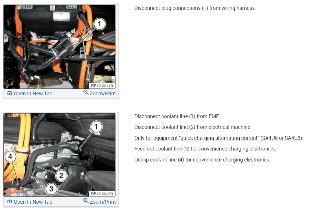

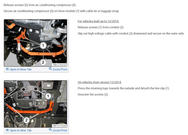

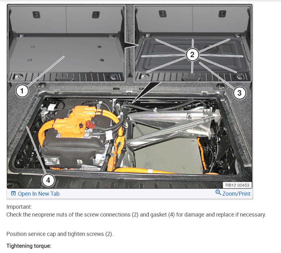

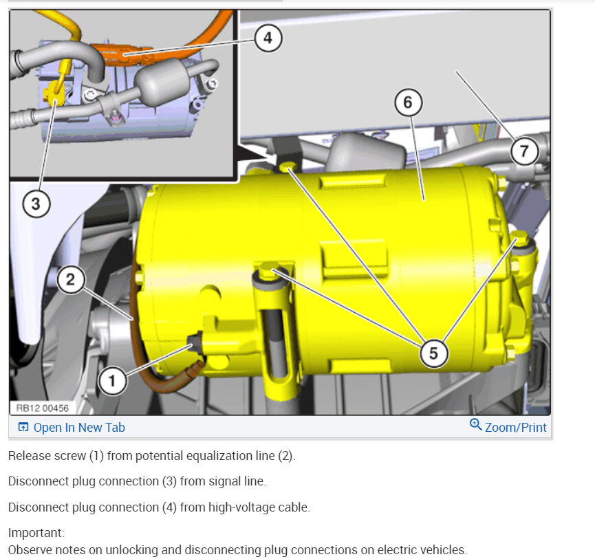

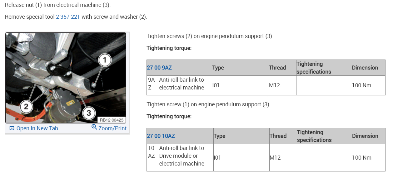

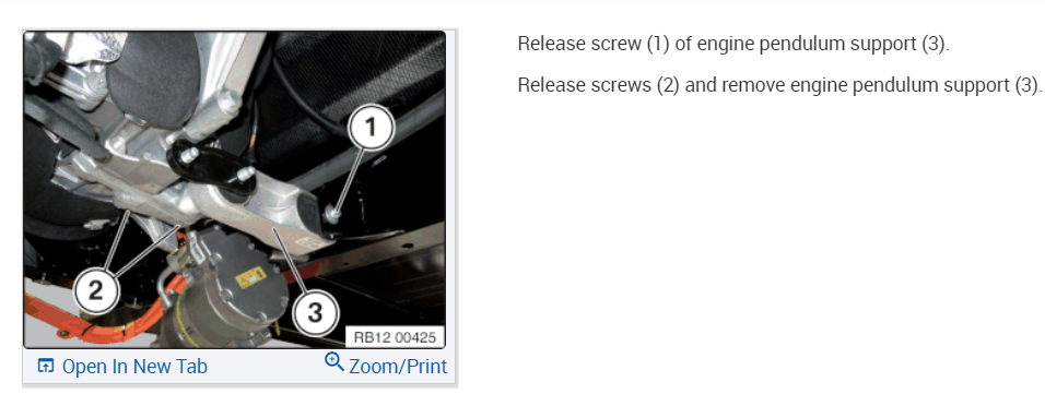

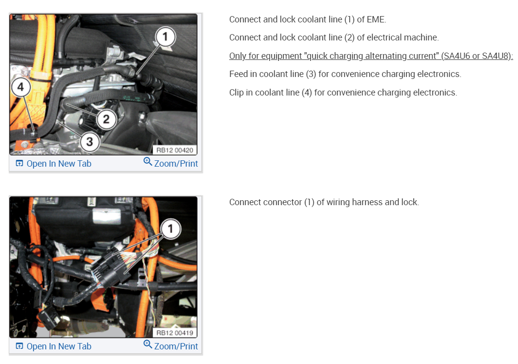

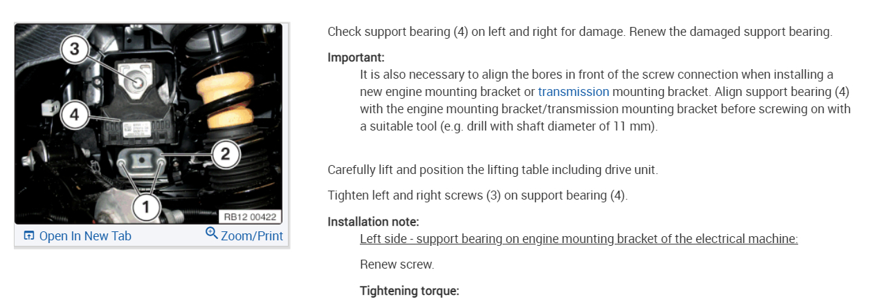

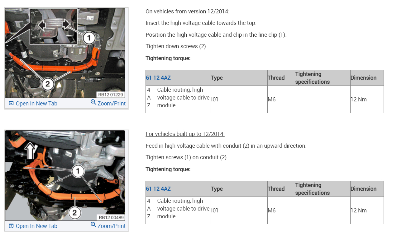

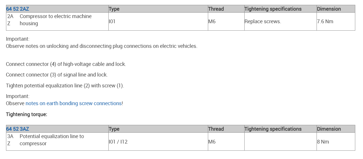

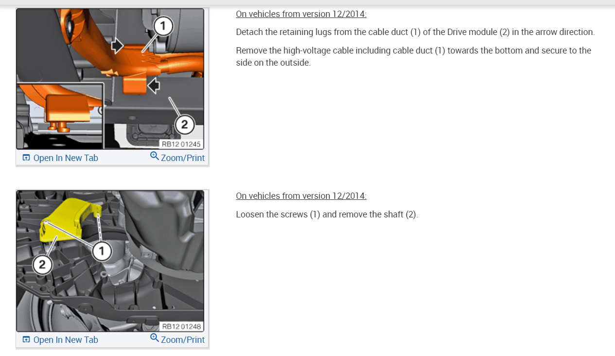

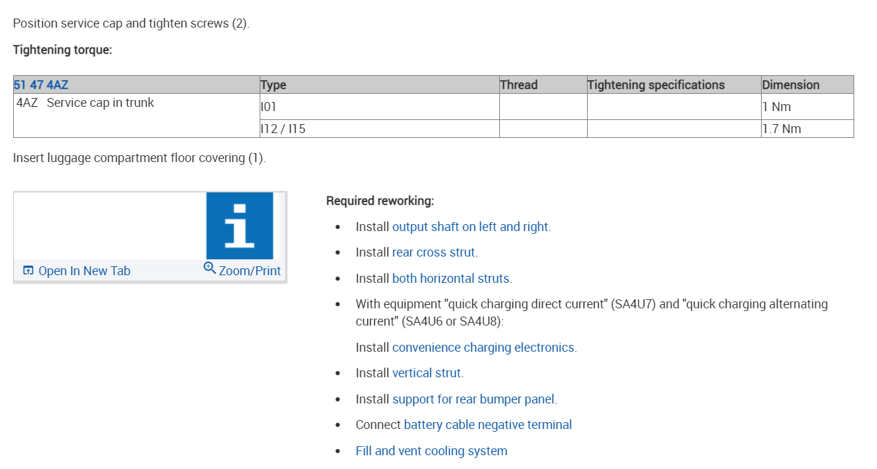

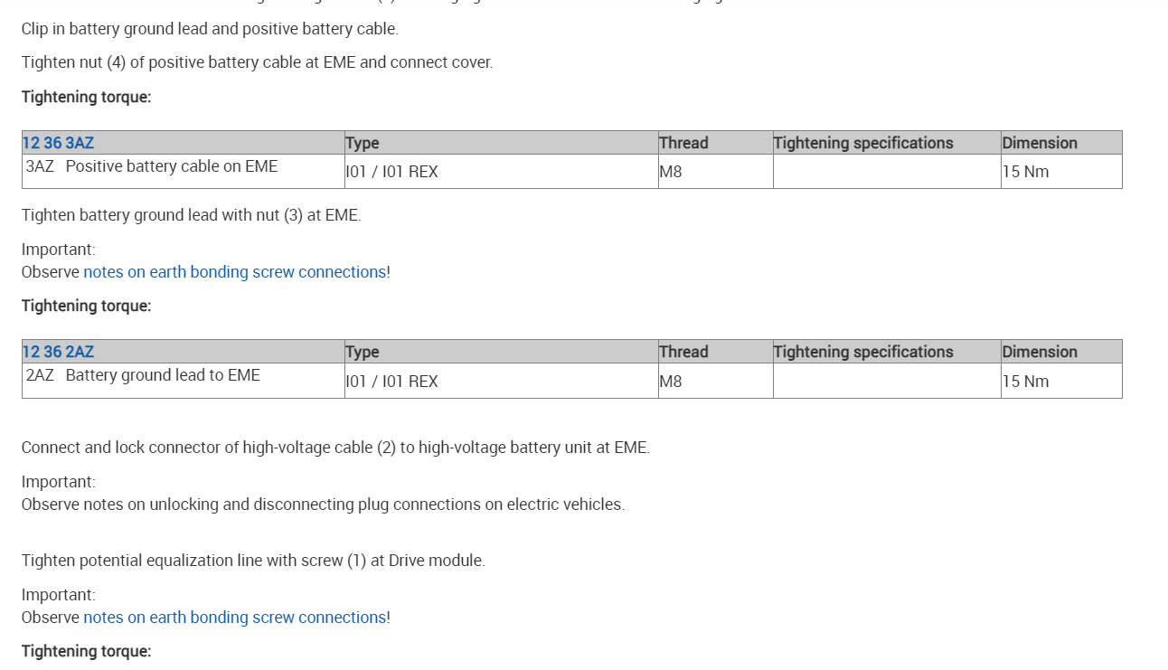

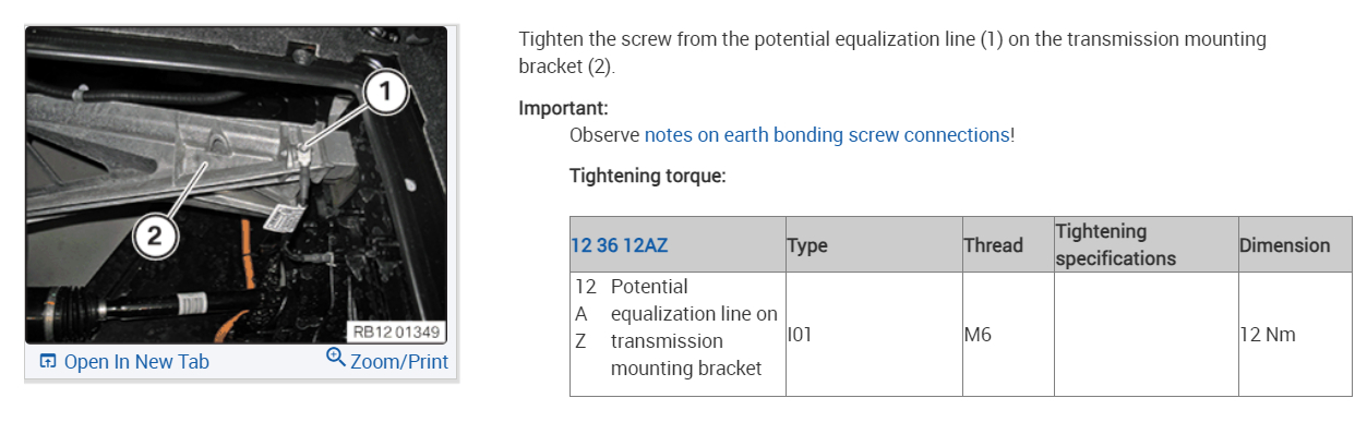

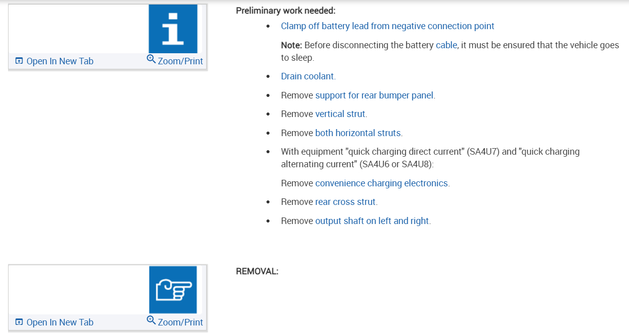

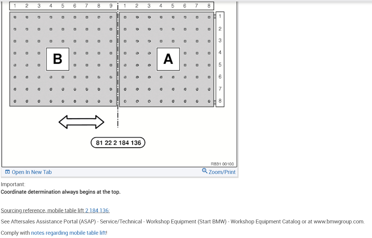

It takes a specialized table rig to hold the electric motor because it is heavy so be ready for that. I looked at the instructions and I didn't see any programming necessary. You must be careful and follow the instructions because a wrong move can cause electrocution. I have included the instructions given but if you have any questions or need more information please ask. Check out the images (below). Please let us know how it goes.

hotdarn, I see, thanks. So, the electric motor and the gas motor are both one assembly?

There is no gas propulsion motor, the gas motor is a range extender which runs a generator to help charge the battery.
