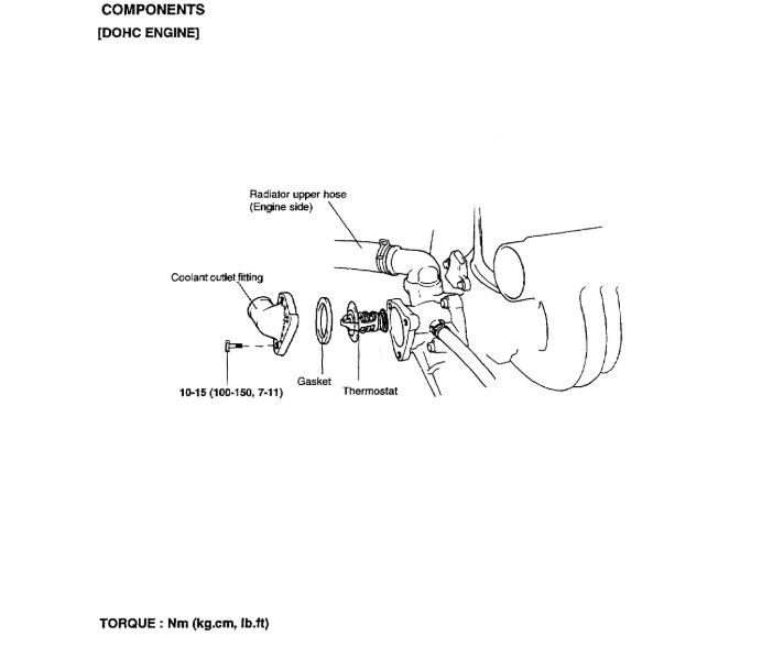

Radiator overheats.
Tuesday, September 11th, 2018 AT 8:54 AM
MECHANIC
52,796 POSTS
Good afternoon.
Below is the procedure and a picture for you to view.
REMOVAL
1. Drain the coolant to the thermostat level or below.
2. Remove the Engine coolant outlet fitting and gasket.
3. Remove the thermostat.
Image (Click to make bigger)
