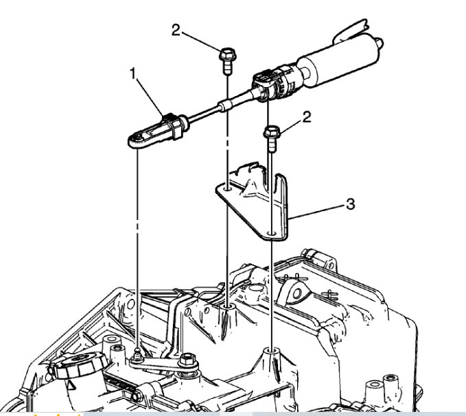

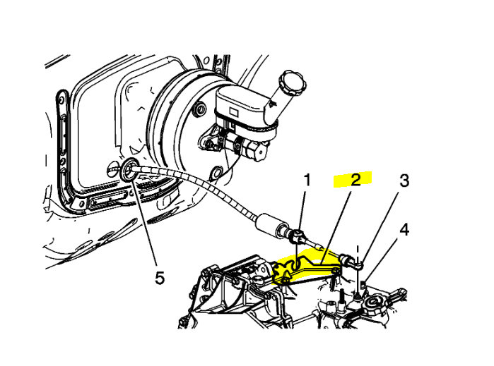

There are two cables on this vehicle. What I suggest is this. Have a helper shift through the gears vehicle you watch at the transmission to see if the cable is moving the shift lever on the transmission.
There is a cable bracket that may have broken, or the cable may have come out of the mount. Check that as well. See pic 2.
Let me know what you find.

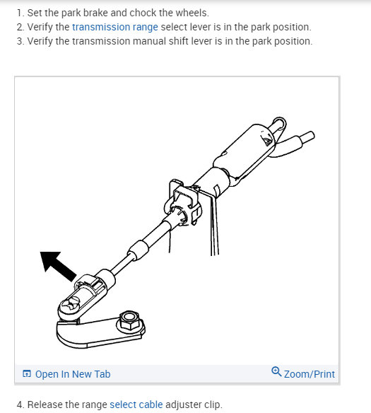

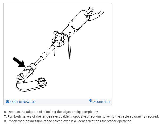

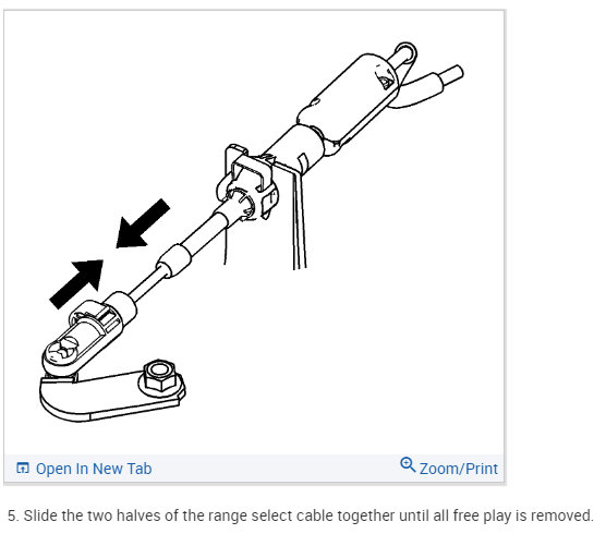

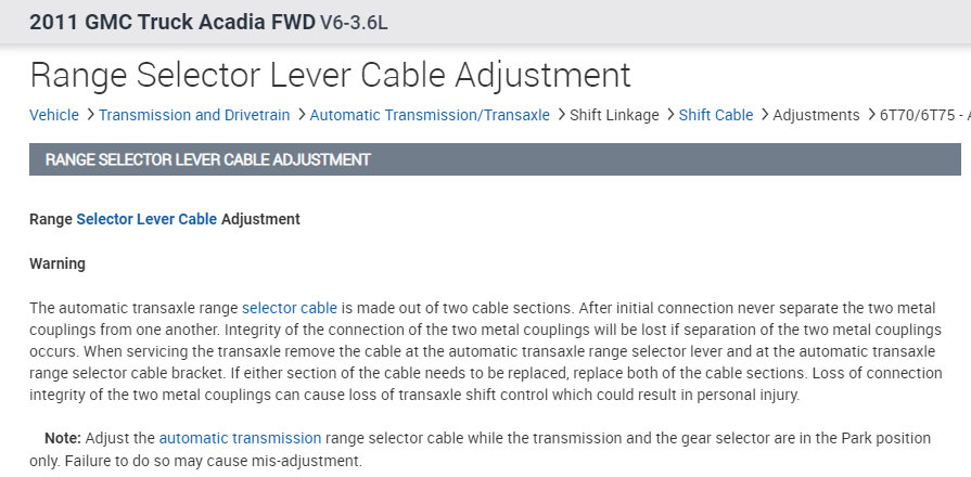

It sounds like it simply needs to be adjusted. If you look below, I attached the directions for adjusting the cable. Take a look through it and let me know if you have questions and are comfortable performing the procedure.

DAVEM16
  • 17 POSTS
Hello, the adjustment you recommended work like a charm. The adjustment was easy, it only took about 15 minutes. Thank you for all your help, you saved me a ton of money, now I don't have to take it to the dealer. I appreciate all your help, thank you!
