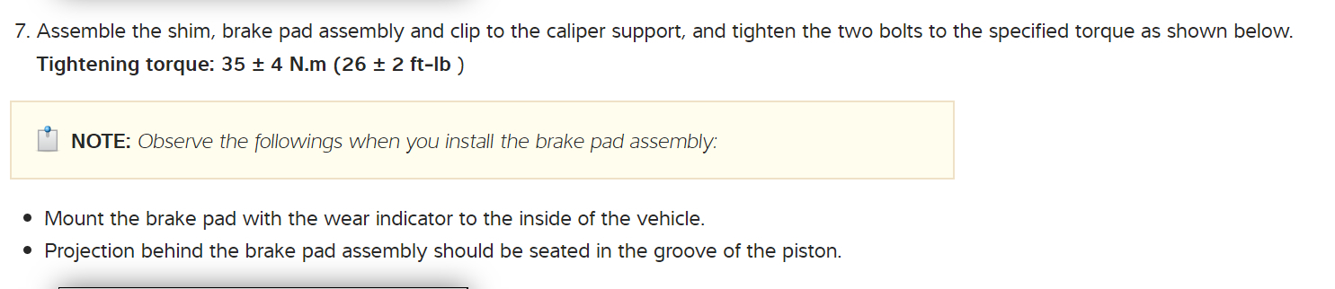

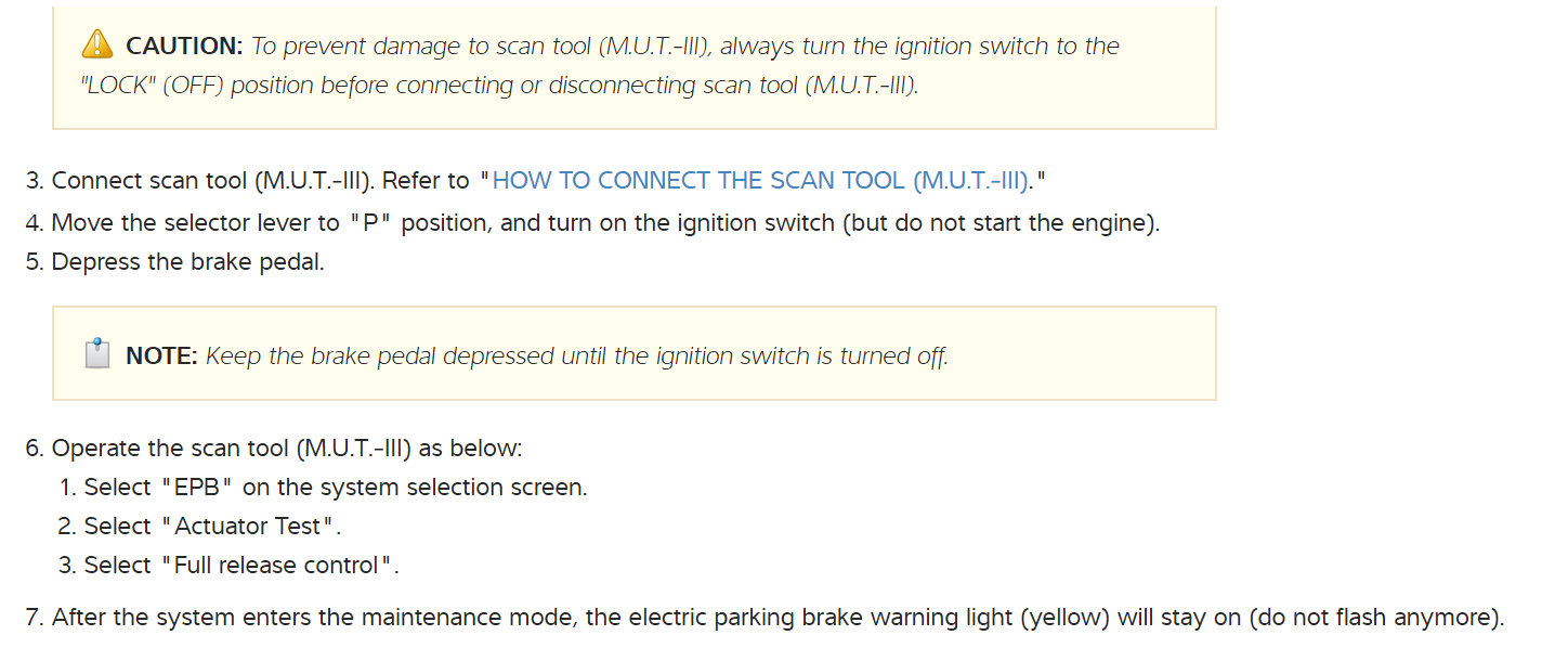

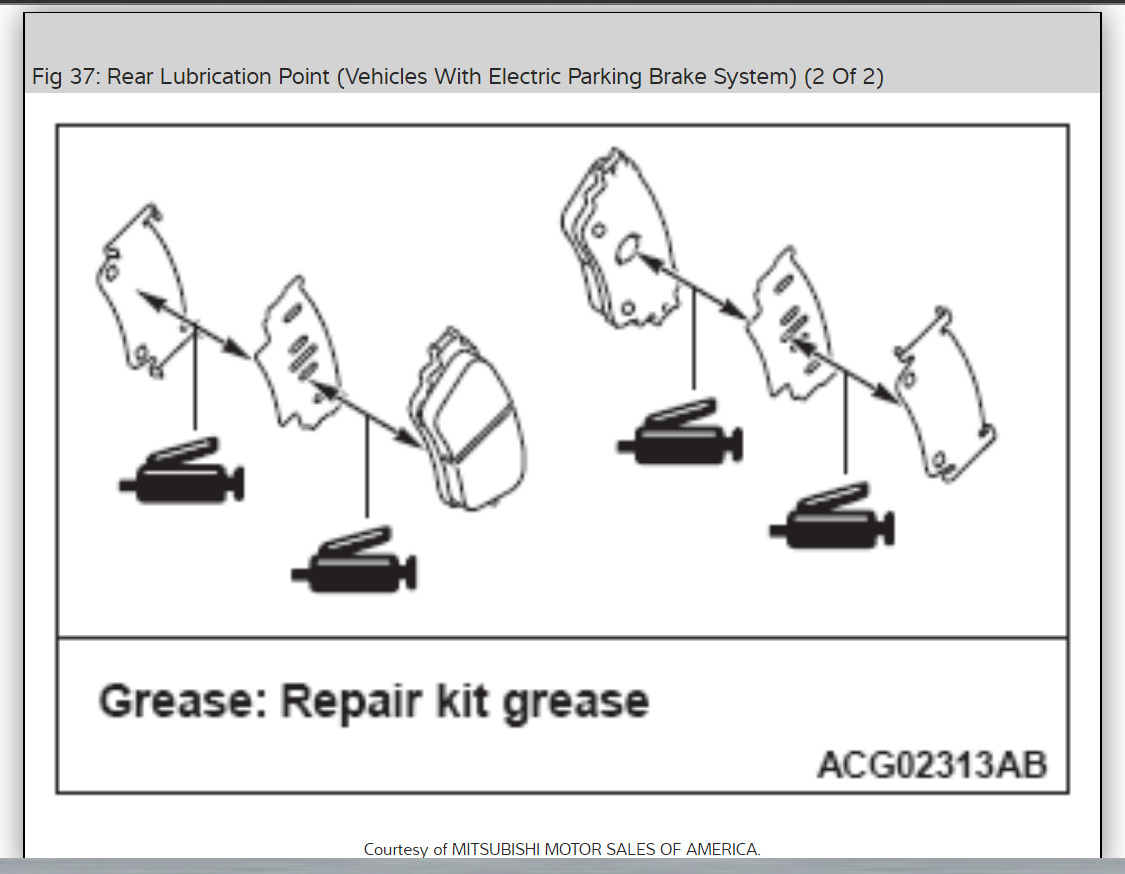

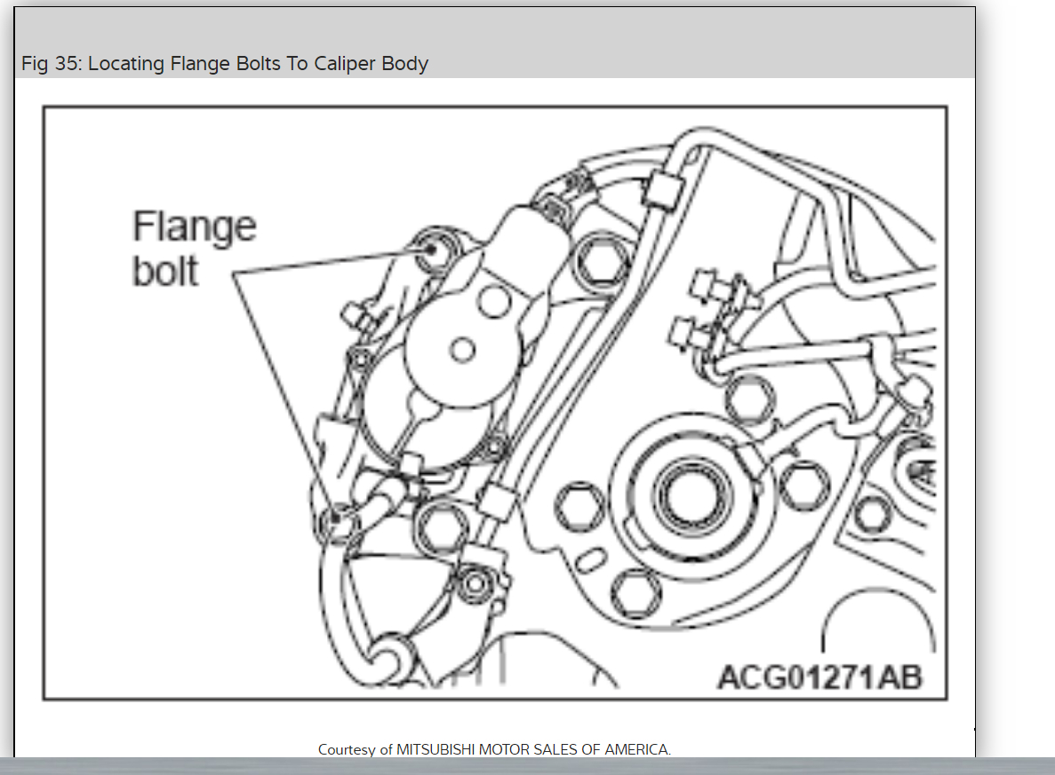

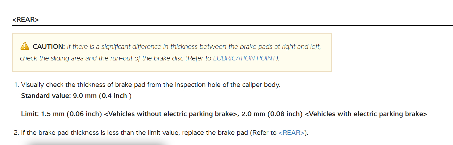

cannot locate any shop manuals on how to replace the pads and rotors
2017 MITSUBISHI OUTLANDER
35,000 MILES • 2.4L • 4 CYL • 4WD • AUTOMATIC
NICK GERMAN

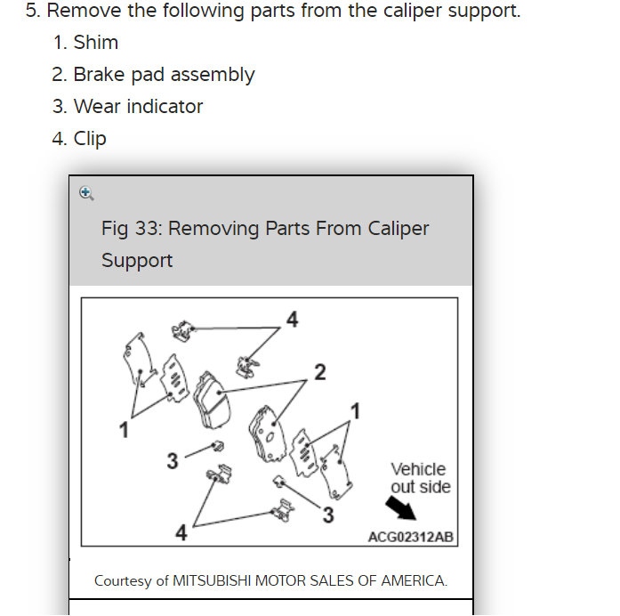

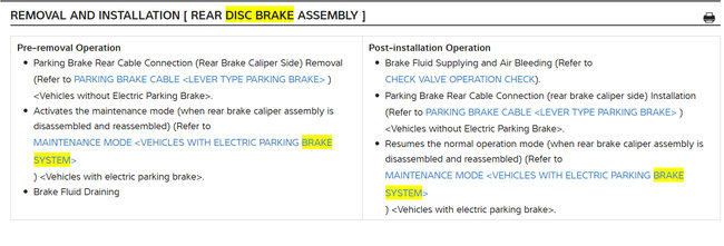

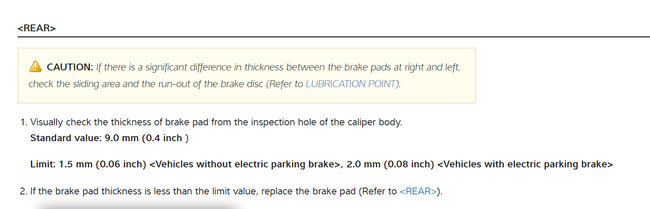

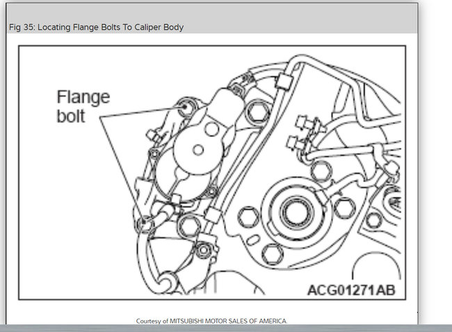

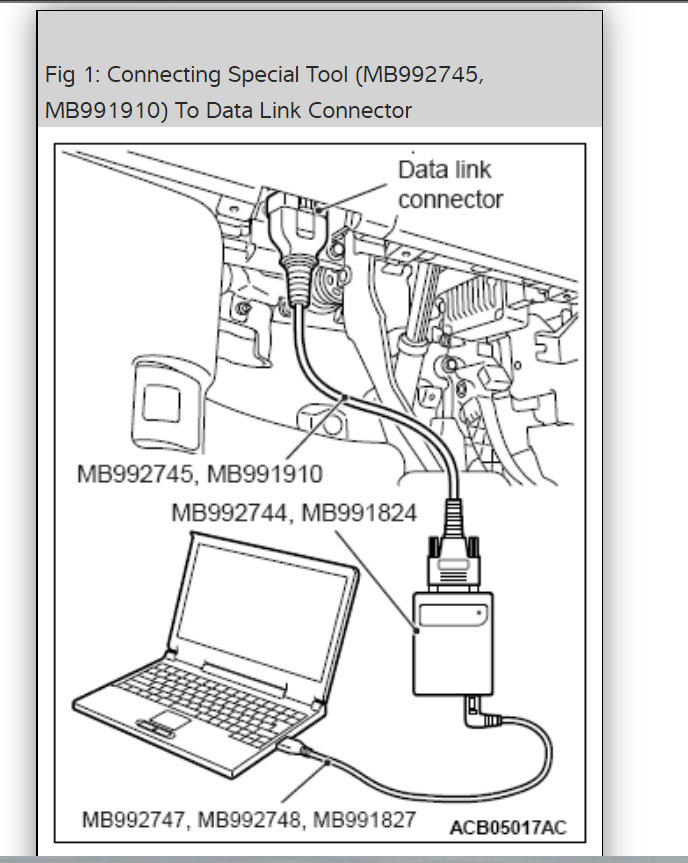

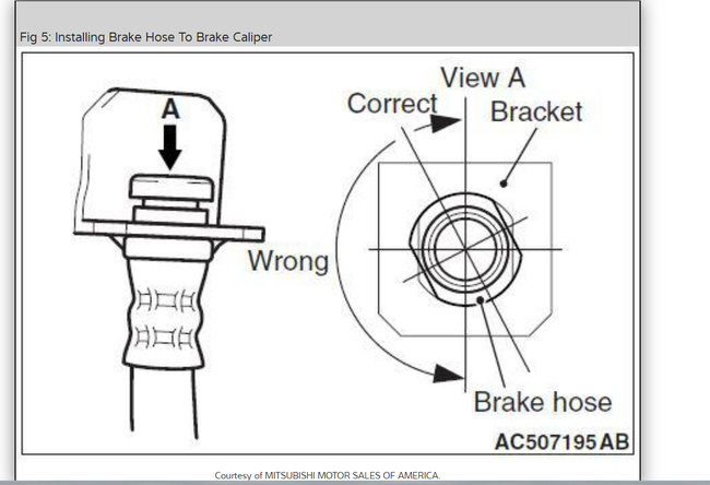

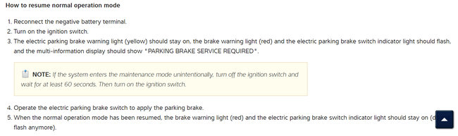

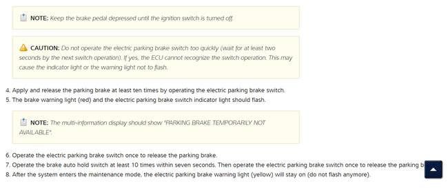

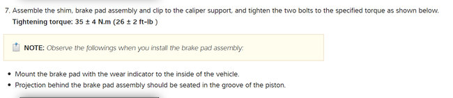

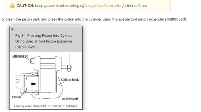

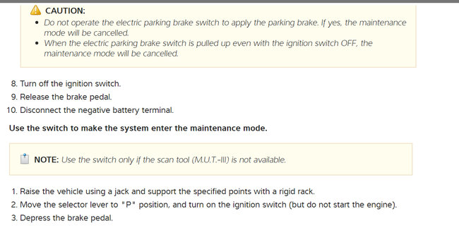

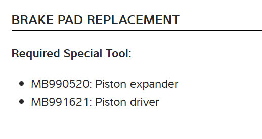

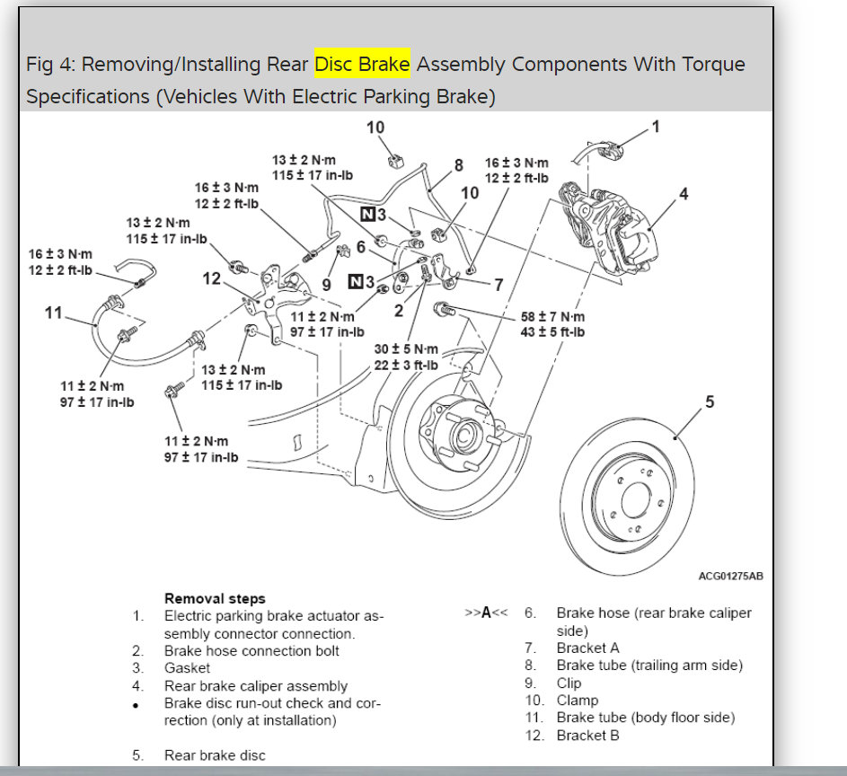

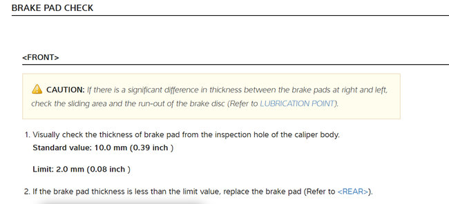

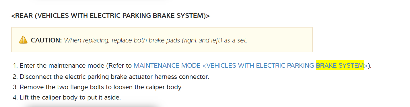

I cannot locate any shop manuals on how to replace the pads and rotors for this vehicle. It appears since the factory installed electronic rear parking brake, there are a few extra steps to follow. Do you have the manual? Thanks.
Jul 9, 2019 at 8:24 AM
SCGRANTURISMO
  • CAR REPAIR CONTRIBUTOR
  • 4,897 POSTS

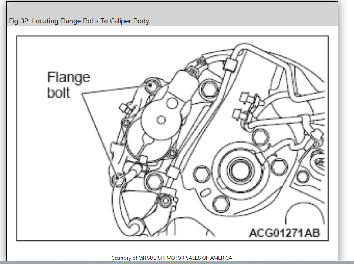

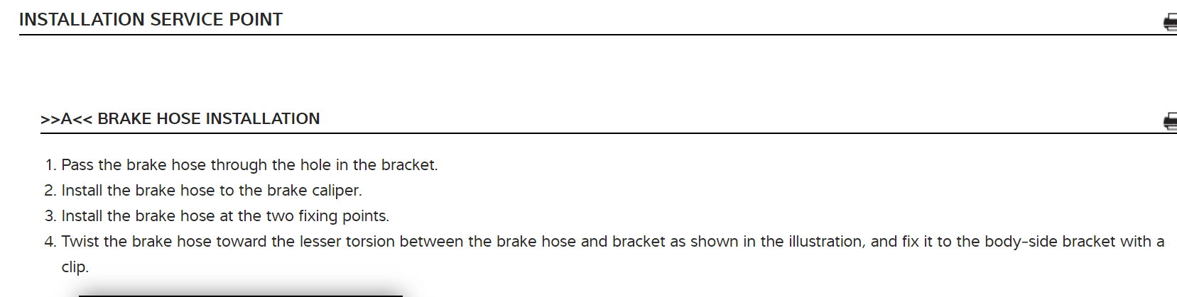

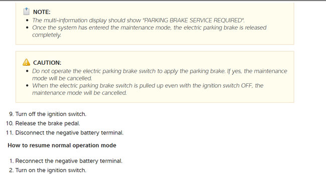

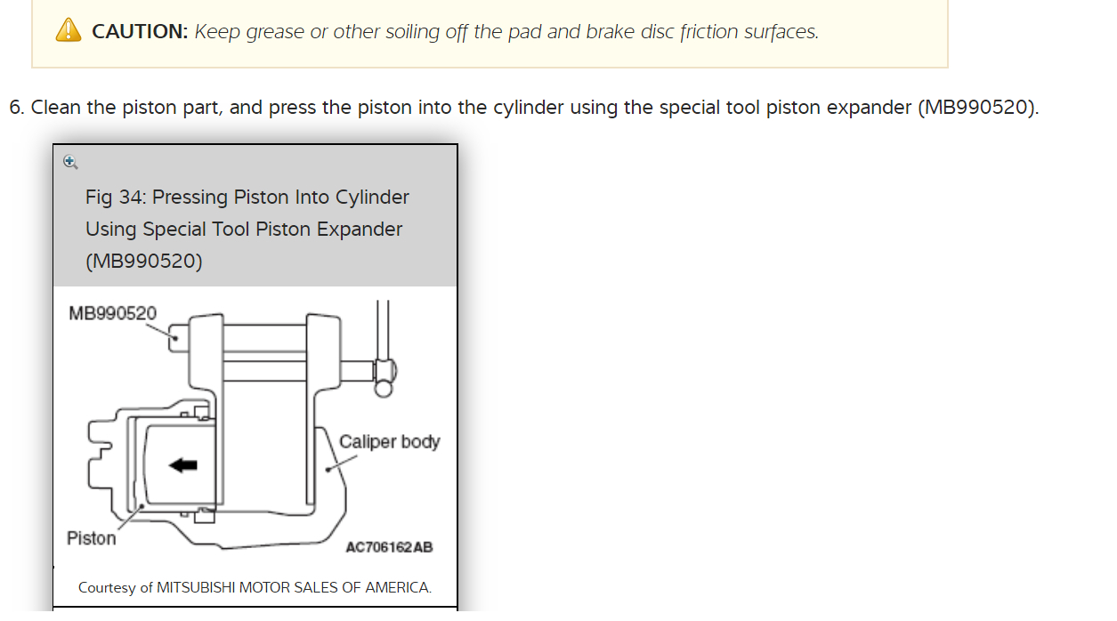

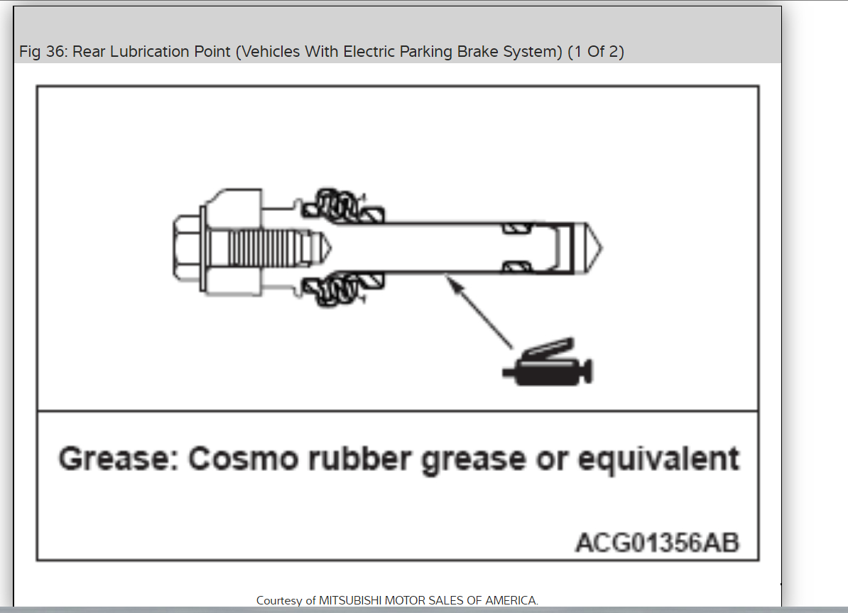

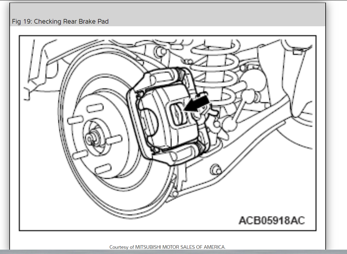

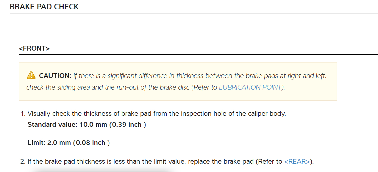

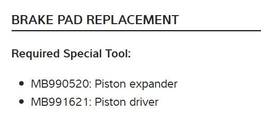

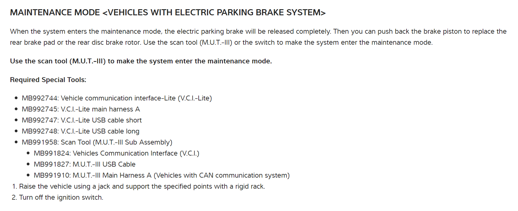

I have included the information that you requested in the diagrams down below.There is a section of this operation that does require the use of a special scan tool and a laptop, although I'm not sure if that will be required for just changing brakes or not. Keep in mind that these are the directions that are given to the Mitsubishi factory trained technicians at the dealership, so they cover a wide range of problems and they have all the specialty tools to play with. Please get back to us with how everything turns out.
Thanks,
Alex
