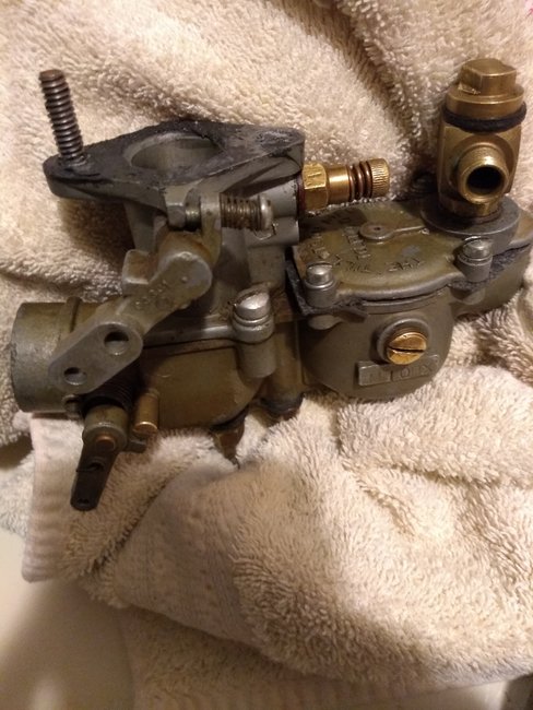

I need someones help, i am trying to put a mounting bolt into a carburetor. The hole the bolt is going into is white metal, not enough material to tap.
Looking for an adhesive that will hold to white metal, JB weld don't work, super glue did not work.
Please help.

Good morning,
Can you upload some pictures of what you see so I can see what you are dealing with?

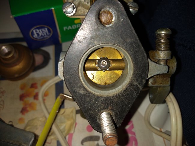

Thank you for your quick reply. here are two pictures. if you need anything else please let me know.

This looks like a 3/8 size bolt? Is that correct?
If it is, does the bolt go in at all? Are there any threads left in the housing?
Do you have a clear shot of installing a bolt from the bottom of the mount on the intake?

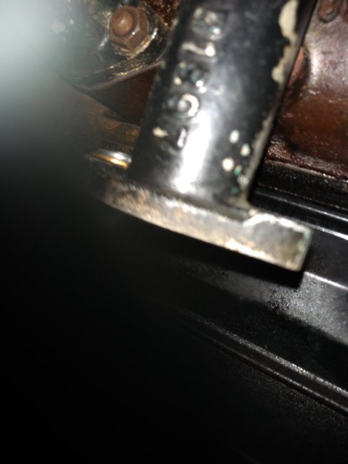

Roy,
The bolt is a 1/4 - 20. There are no threads left in the housing, the hole the threaded bolt goes into is larger than 1/4 -20. The carburetor is an updraft carburetor, the two threaded bolts go up through the bottom of the intake flange, two nuts hold the carburetor to the flange.
See photo of flange.
Kenny

Wow, I wish I had a better resolution for this.
It looks like you will need a new body for it to accept the mounting stud.
I know that is easy to say but I do not see anything else other than a heli coil. The problem with that is the threads and the body staying in place. You would need to drill out the hole to 5/16 and then thread it to accept the 1/4 threads. Do you think the body has enough room to drill it out?
