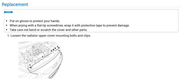

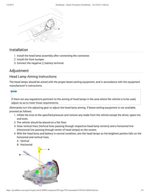

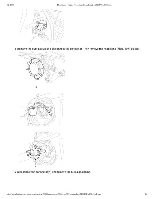

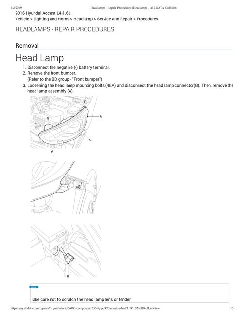

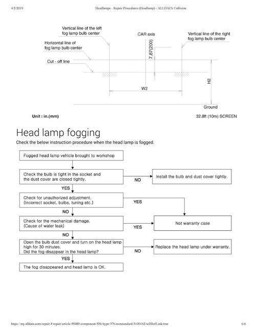

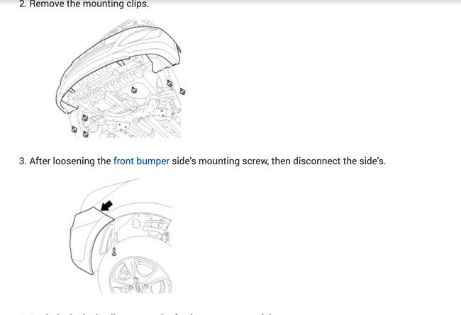

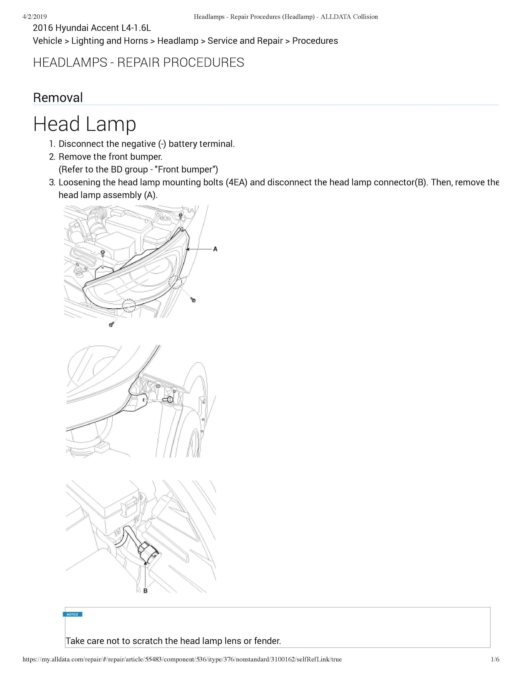

I would like to know how can I remove a headlight assembly?
Tuesday, April 2nd, 2019 AT 7:02 AM
2 Replies
JOETECHPRO
MECHANIC
705 POSTS

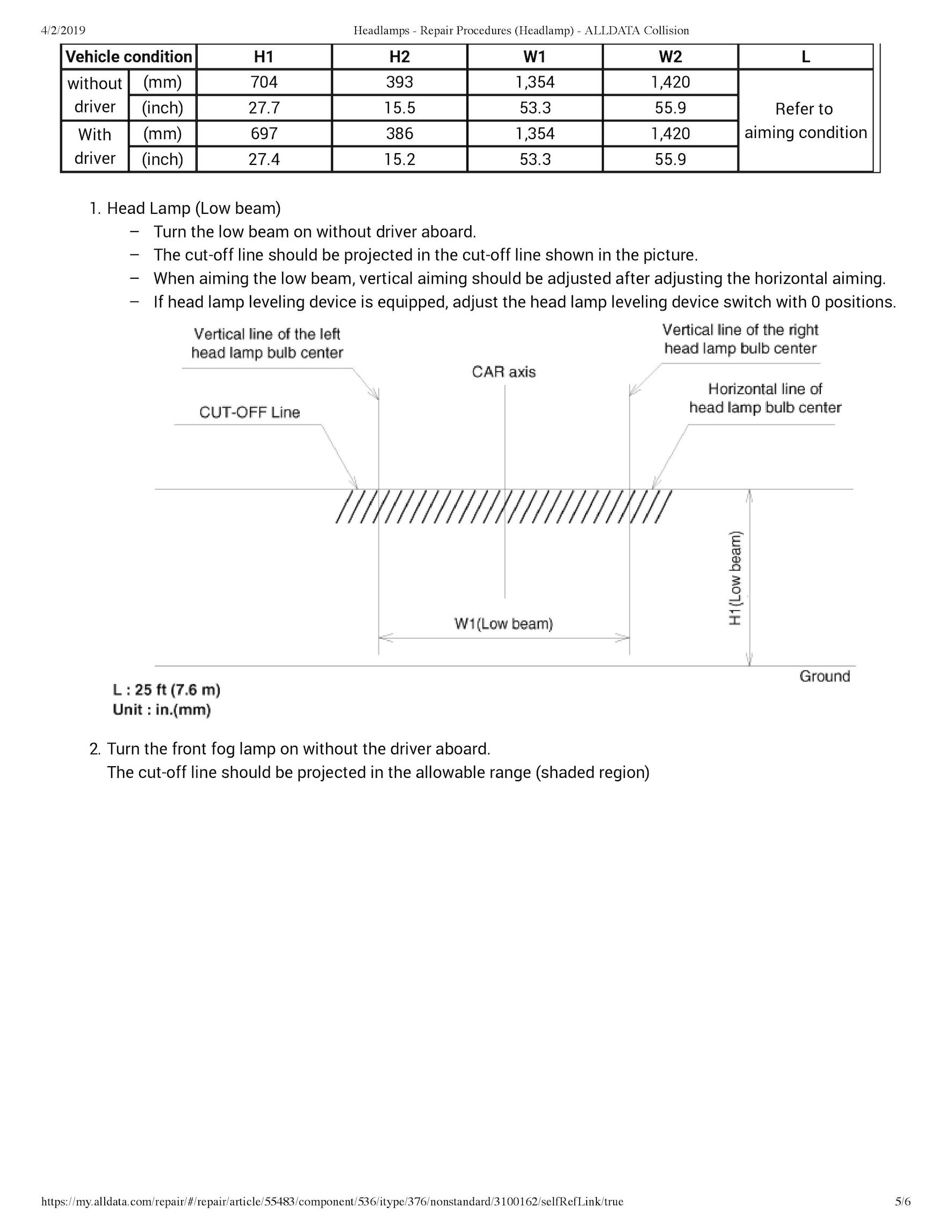

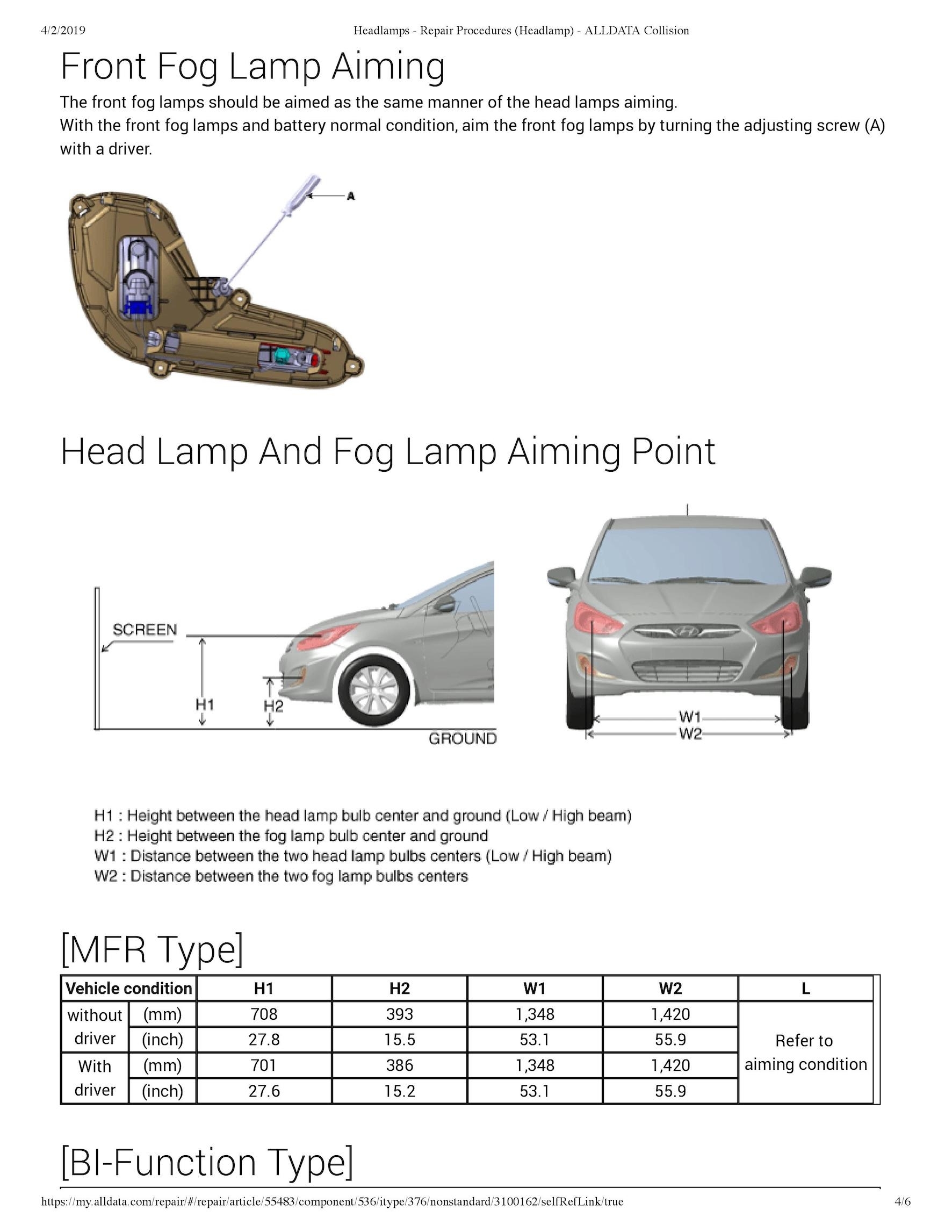

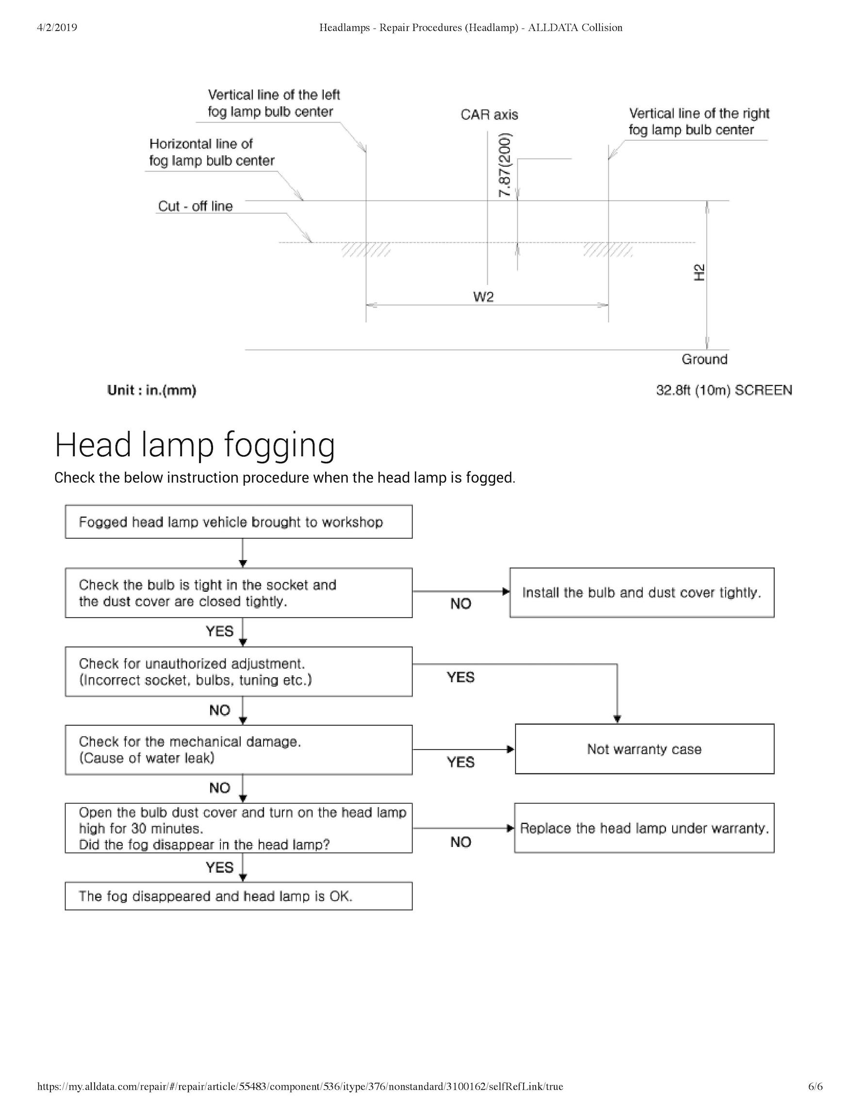

Hey JUNIOR1964,
Please see the attached instructions to remove the headlight assembly.
You will need to remove the bumper to do so, I will add the instructions for this in my next message.
Regards, Joe

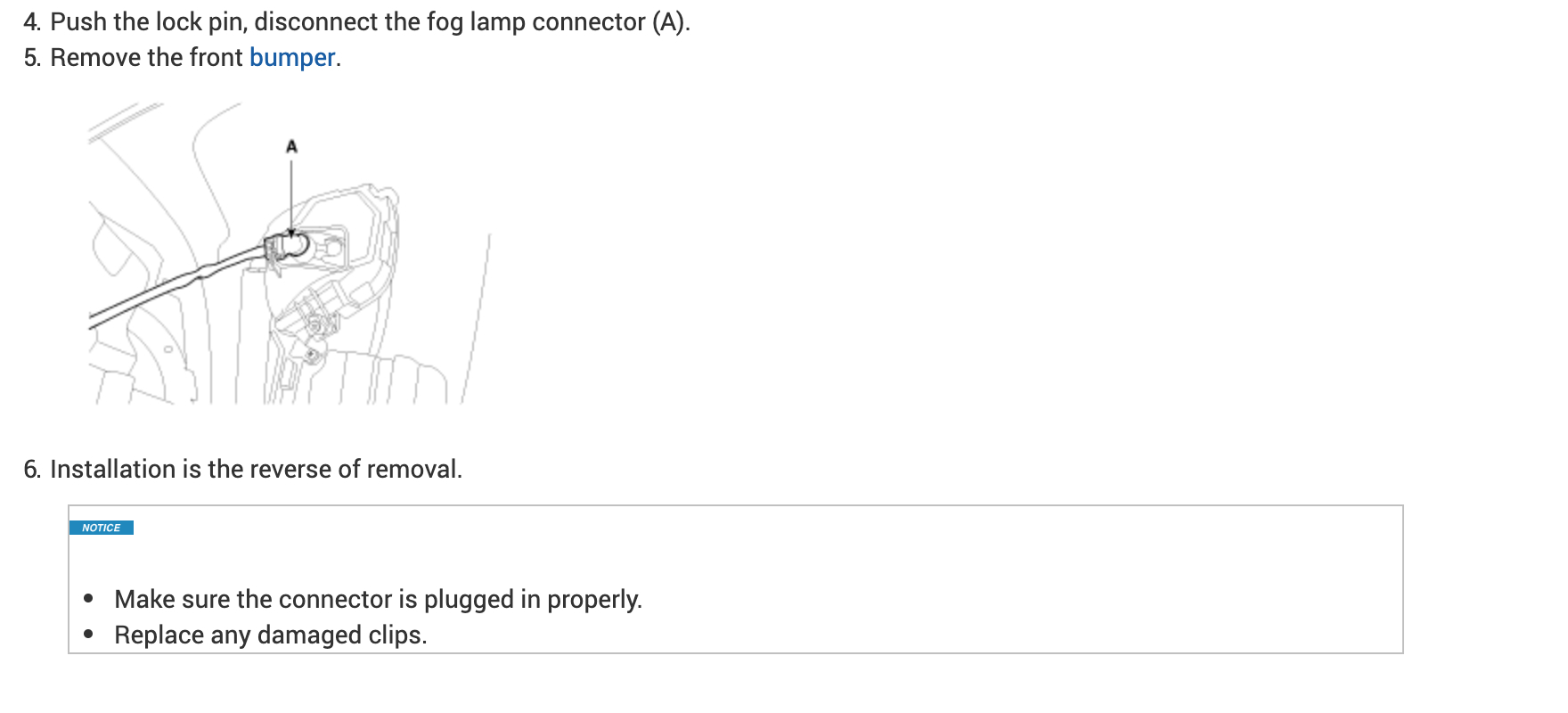

Hey JUNIOR1964,
Bumper removal instructions below.
Let me know if you have any further questions
Regards, Joe
