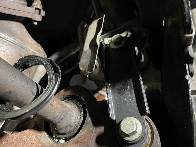

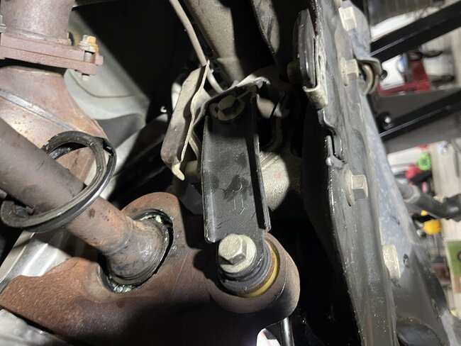

I tried and tried it's not coming out. The boot separated in middle so am stuck with half shaft and bearing in there. Hammered the bearing and where the old boot attaches no success. Used forks, pry bars nothing is moving. I wanted to do like I did with a Mazda I have and remove it with the bracket but the idiots who designed it designed it with 4 bolts one of them tucked under the part where the boot attaches.
Sunday, May 28th, 2023 AT 2:22 PM
BHAMDOC1973
  • 2,018 POSTS
After banging on the bearing for hours between breaks, I was like there was no way this thing is not budging a milli, so I found out there were 2 hidden bolts that create a half circle around the bearing, the bracket is so rusty it is so hard to make it out, 2 10 millimeter bolts, removed Nd the whole thing popped out in 2 seconds. I need to pay more attention to the design next time I do something like this.
Sunday, May 28th, 2023 AT 4:26 PM
BHAMDOC1973
  • 2,018 POSTS
It was a little painful putting the half-circled mount back on, so if anyone is doing this, remove the small transfer case mount and the its a piece of cake. I am surprised it fixed the issue. I don't understand how an axle can cause such binding, also at 85,000.
