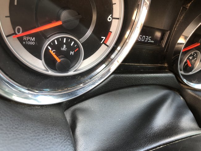

The van listed above is a Grand Caravan, need to replace the cluster.

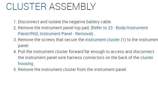

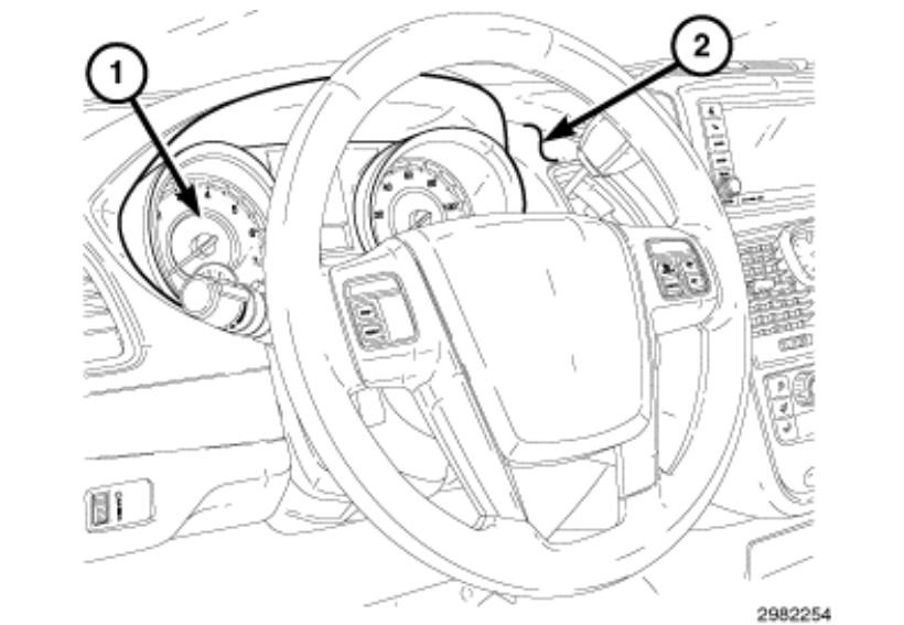

Good afternoon.
Nice to hear from you again.
I attached the procedure below for you.

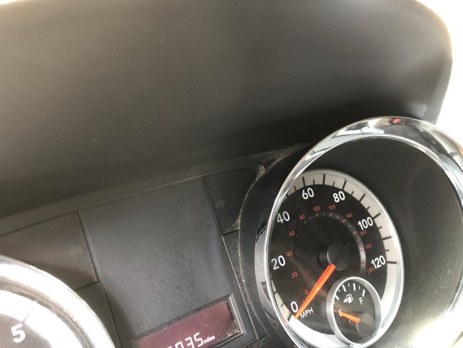

Dealer diagnosed it as bad cluster, temperature and fuel gauge not working, speedometer intermittent.
Tuesday, June 16th, 2020 AT 12:58 PM
Yep, you can send it out and have it repaired instead of replacing it. It usually takes about 3 days.
Look on Google for places in your area.

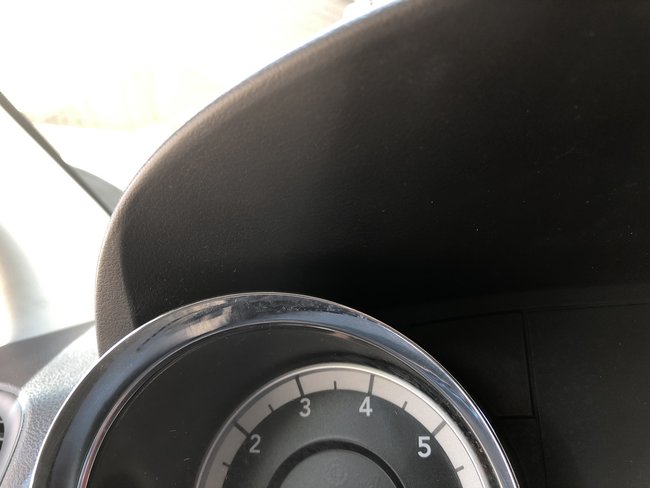

Doesn't look like there are any screws to this.

There is nothing to pop it looks like part of the dash all one piece.

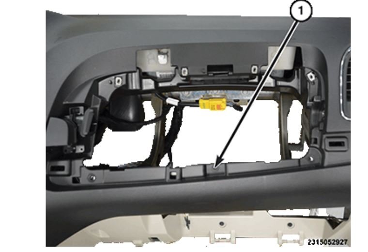

The procedure states to remove the upper pad to access the screws for the cluster. Did you see that in my first post?
Tuesday, June 16th, 2020 AT 1:13 PM
NASER NASER
  • 836 POSTS

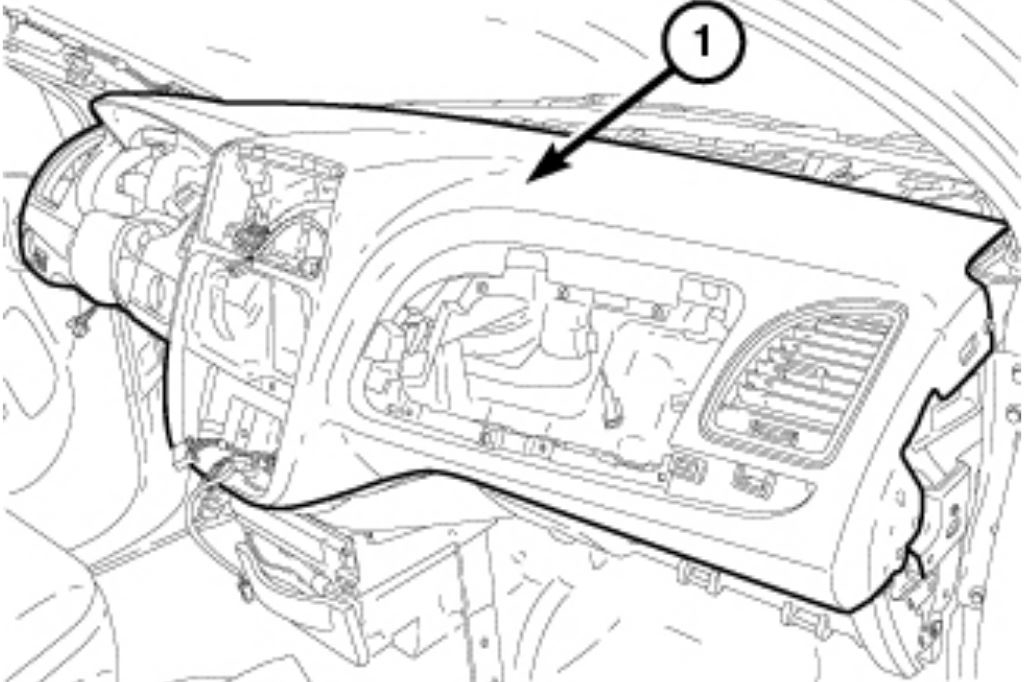

Yes, I saw it. But how you remove the upper pad? The upper pad is basically the whole top of the dash, radio, A/C display, trims.
Tuesday, June 16th, 2020 AT 1:14 PM
Yes, it is correct. The dash pad is the instrument panel.
I attached the instructions and pictures for you.

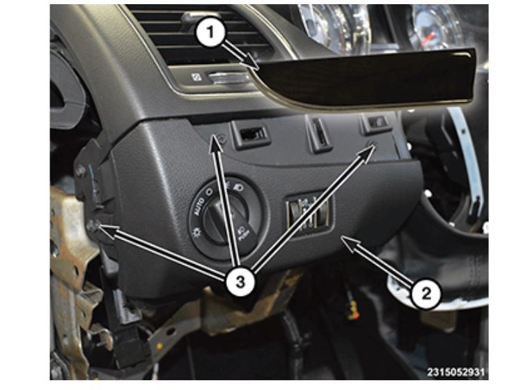

Remove both instrument panel end caps (Refer to 23 - Body/Instrument Panel/CAP, Instrument Panel End/Removal).
Remove the steering column (Refer to 19 - Steering/Column - Removal).
Using a trim stick or equivalent, remove the applique (1).
Remove the three screws (3) and the headlamp switch bezel (2). Disconnect the wire harness connectors.

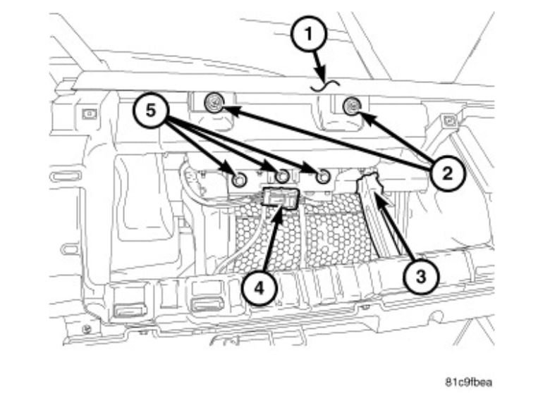

Remove the three passenger side airbag bolts (5).
Disconnect the passenger side airbag wire harness connector (4).
ImageOpen In New TabZoom/Print

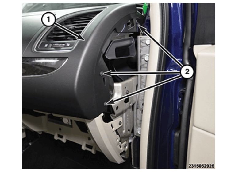

Remove three screws (2) on the right side of the instrument panel pad (1).
Remove one screw (1) located in the upper glove box opening.

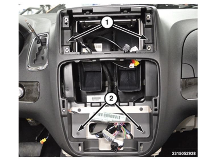

Remove two screws (1) located in the radio opening.
Remove two screws (2) located in the instrument panel center bezel opening.

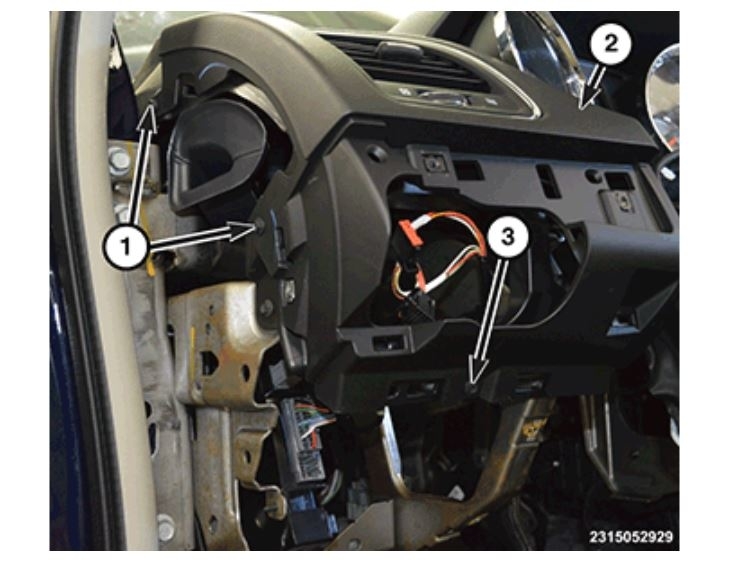

Remove one screw (3) located below the headlamp switch bezel.
Remove two screws (1) on the left side of the instrument panel pad (2).

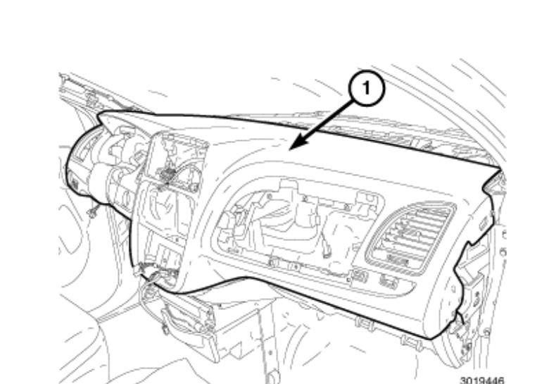

Remove six screws (1) along the top of the instrument panel pad.

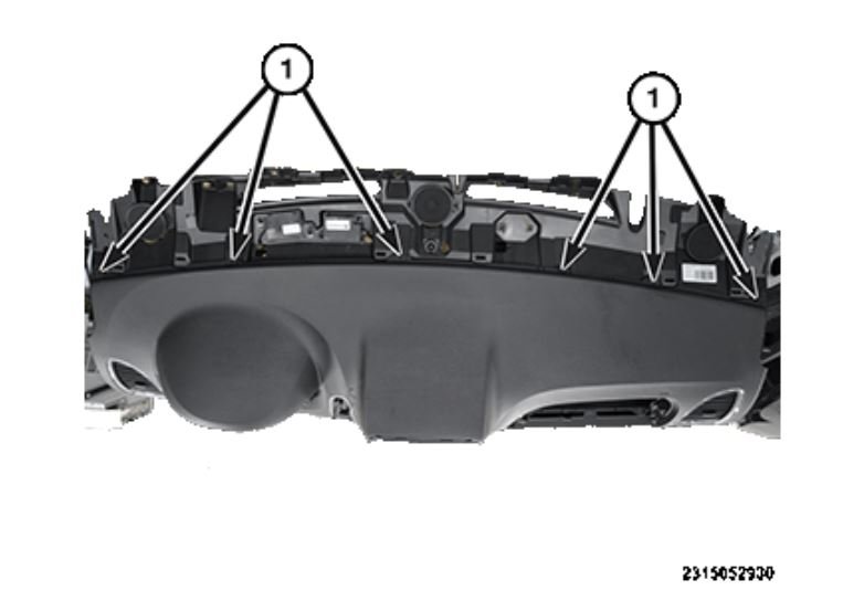

Pull the instrument panel top pad (1) rearward to disengage the retaining clips that secure the top pad to the structure.
Lift upward and rearward to remove the instrument panel top pad (1) from the vehicle.

They are underneath the top dash pad shown in the pic attached, it has to come off first. Removing the cluster is almost as bad as taking out the entire dash on those vans as the only part left after getting the pad off is the dash carrier.
Don't try to use a used cluster, they are a one time unit, once programmed they are stuck with the VIN from that vehicle and are not able to be swapped, you can only use a new cluster.
