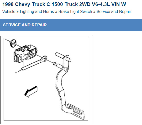

brake light switch replacement previous owner put it on wrong
2000 CHEVROLET SILVERADO
100,000 MILES • 4.8L • V8 • 4WD • AUTOMATIC
RAYCLAIRE425

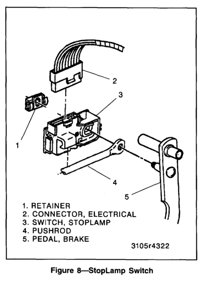

We think the previous owner put it on wrong and can't find any information on how to get it off. Help please.

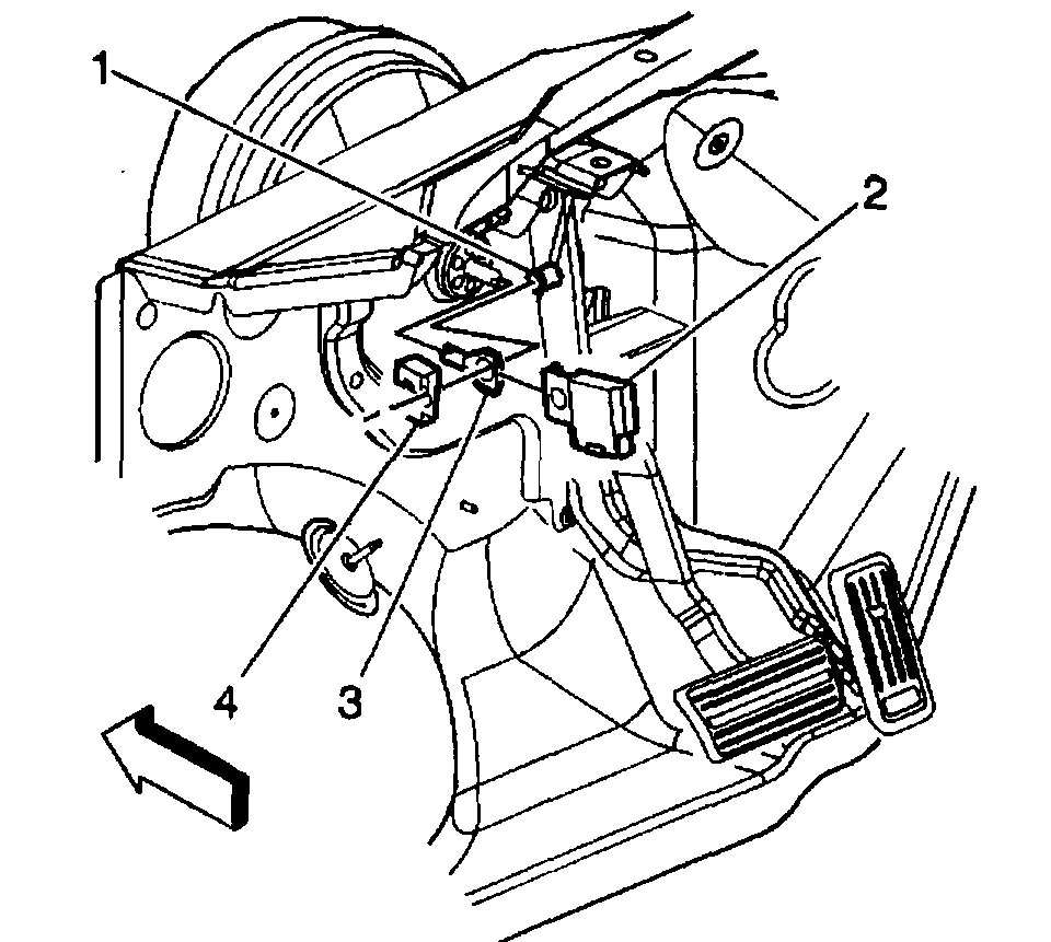

Here are the directions specific to your vehicle for brake light switch replacement. The attached pictures correlate with the directions.
__________________
2000 Chevy Truck K 1500 Truck 4WD V8-4.8L VIN V
Stoplamp Switch Replacement
Vehicle Sensors and Switches Sensors and Switches - Lighting and Horns Brake Light Switch Service and Repair Procedures Stoplamp Switch Replacement
STOPLAMP SWITCH REPLACEMENT
Removal Procedure
pic 1
1. Disconnect the electrical connection from the stoplamp switch (2).
2. Remove the pushrod retaining clip (4).
3. Remove the stoplamp switch (2).
Installation Procedure
pic 2
1. Install the stoplamp switch (2).
2. Install the pushrod retaining clip (4).
3. Connect electrical connection to the stoplamp switch (2).

On the brake pedal under the dash there will be a king pin pull it out and remove the stud and the switch should come right out then disconnect the wiring harness and replace switch.
Some model does not have a removable pin that goes thru the brake pedal for the booster actuator rod. It is permanent a fixed to the brake pedal. You have to remove the clip on the end then the brake light switch will come off the pin.

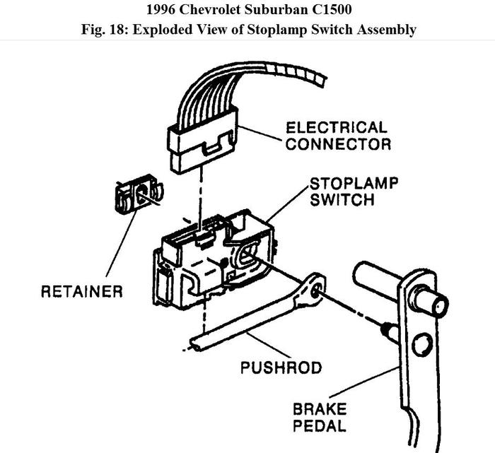

Get the new switch and look at it. You have to release the switch from the pedal assembly and install the new one.
Here is directions.
STOPLAMP SWITCH
Removal & Installation
Disconnect negative battery removal. Remove retainer clip from brake pedal pin. Remove switch by unsnapping from pushrod. Remove electrical connector from switch. To install, reverse removal procedure.
Check the image below

Brake light switch is located at top of brake pedal

i found the brake clip thank you it was very helpful, now ther is a silver clip that holds the assembly to the brake pedel how do i get the clip off?
Mar 8, 2021 at 6:15 PM (Merged)
DOCFIXIT
  • 18,828 POSTS
One side should have a cut out. Rotate up and switch should pull out. If needed pry out the cutout side.

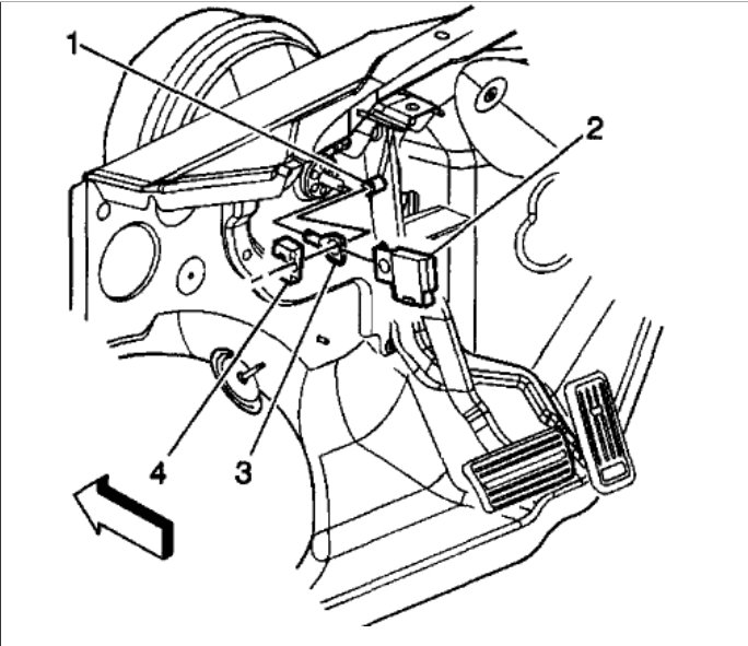

I have installed 3 brake light switches with the last one being an OEM switch. When the brake pedal is pressed, the switch slides down the brake push rod shaft and does not move the metal clip in the switch to activate the brake light switch. I've also had an ASE Certified Automotive Instructor look at it and he too cannot find anything wrong other than the switch will work when manually pressed. I don't know if the previous owner had replaced the brake power booster. From what I've read so far, there is a difference between a GMC and Chevrolet brake booster which resolved someone else's problem.
Have you come across any other trucks with this problem?
  • 54,832 POSTS
The brake light switch needs to be clipped using a retainer clip by the brake arm lever, here is a diagram (below) that shows what I am talking about and should help you get it properly mounted. The pedal arm activates the switch pressure sensitive.
