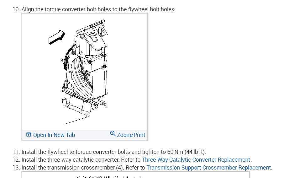

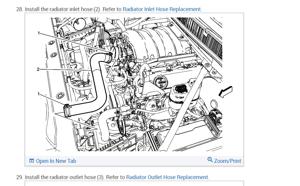

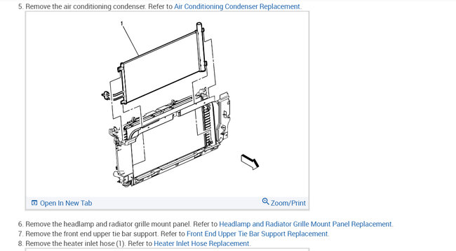

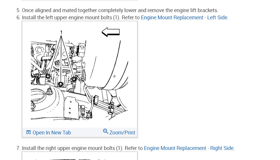

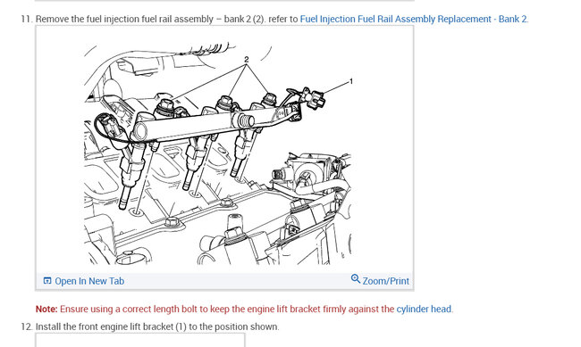

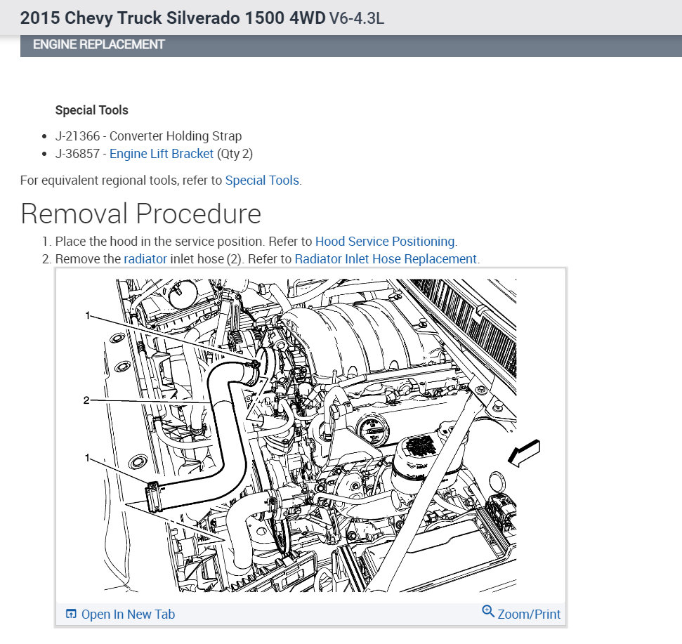

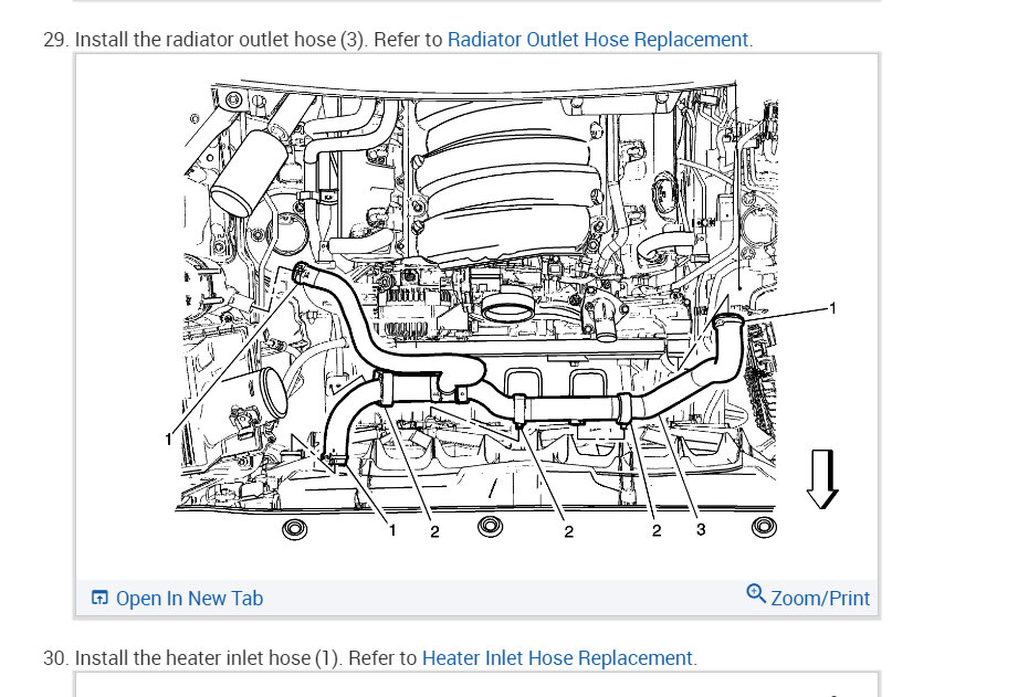

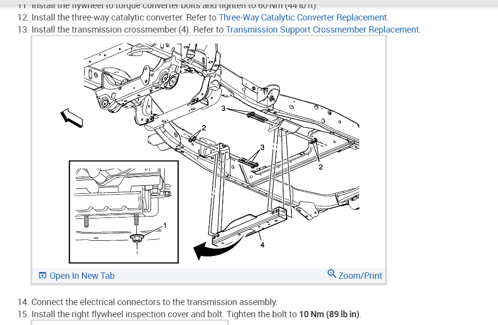

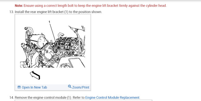

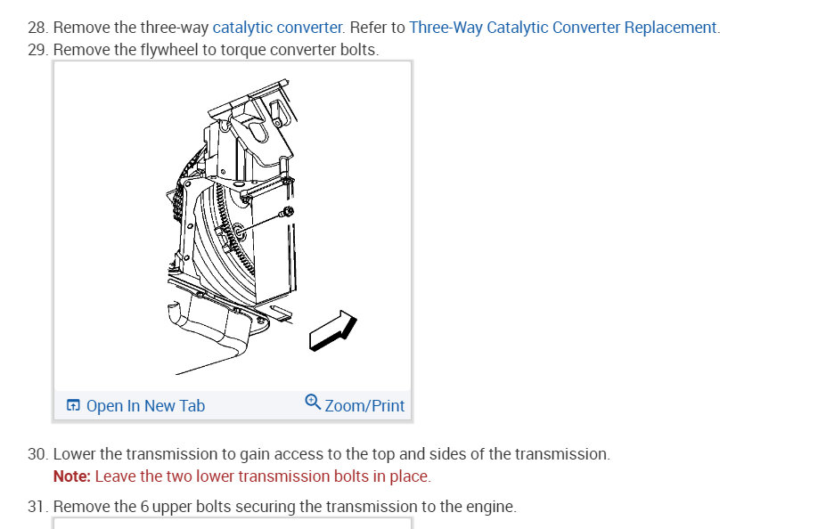

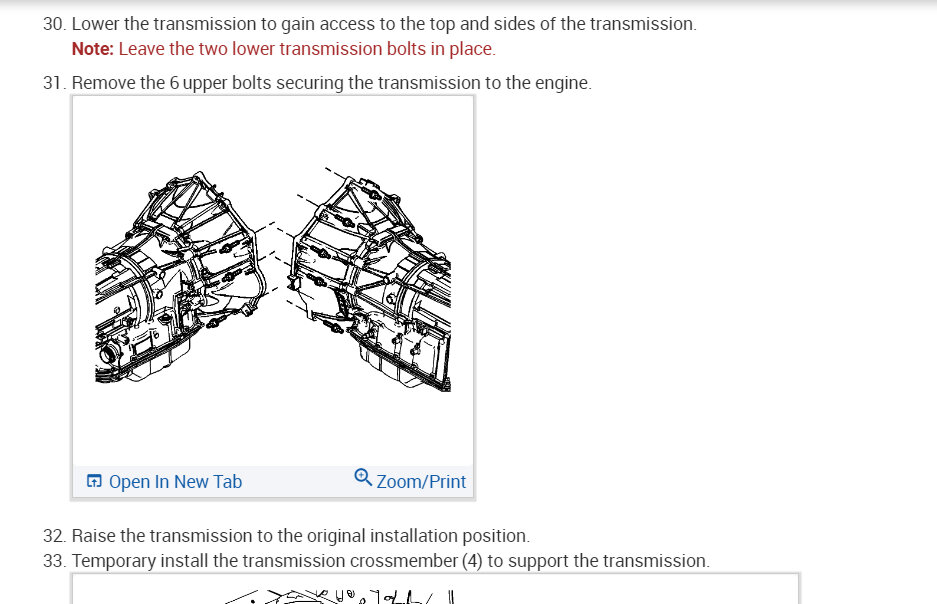

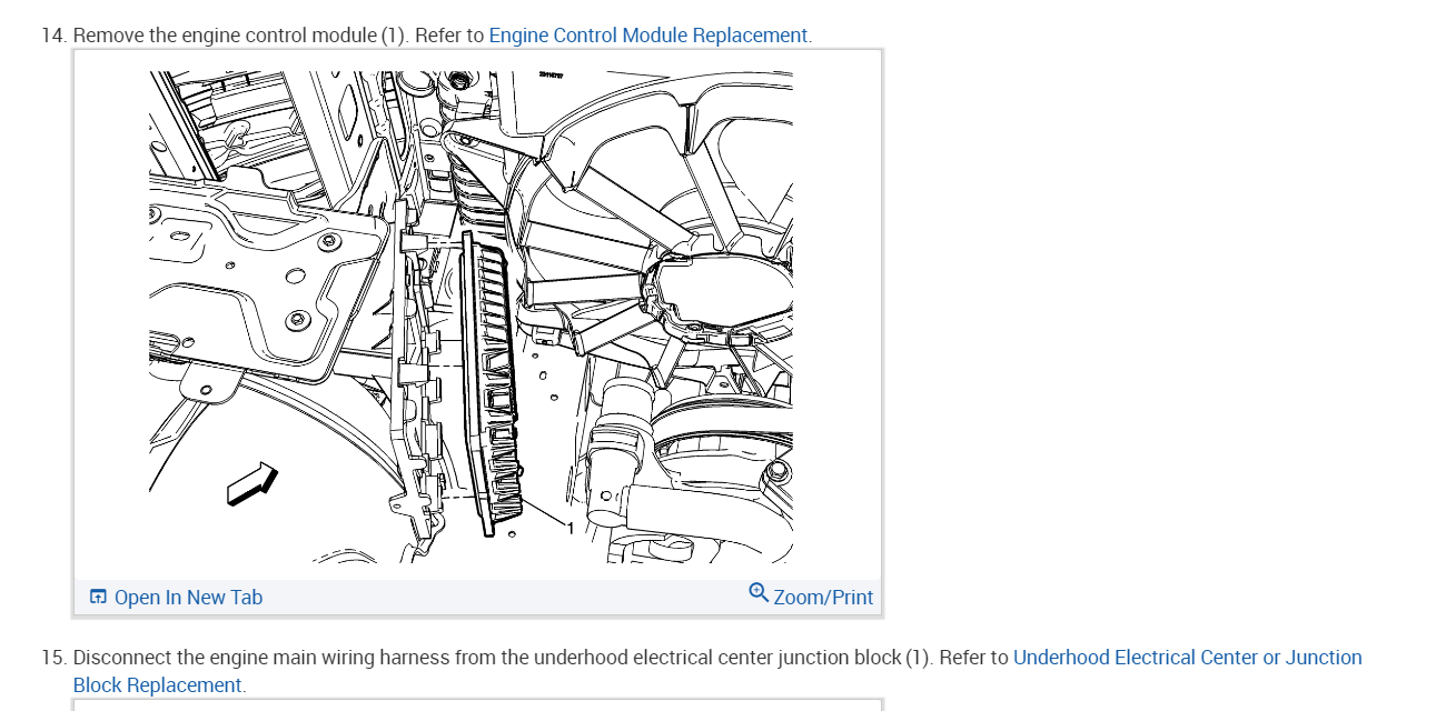

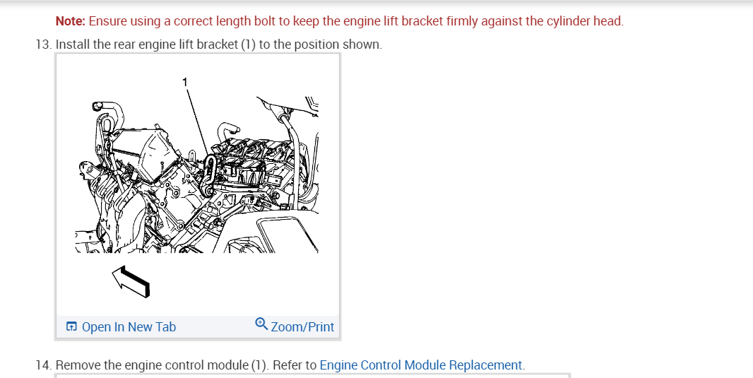

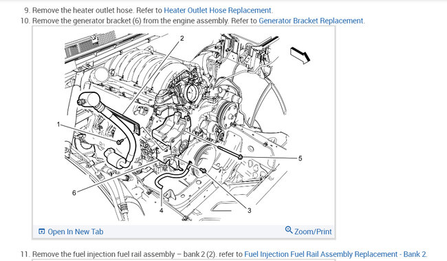

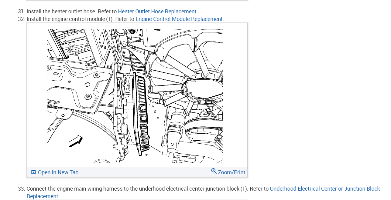

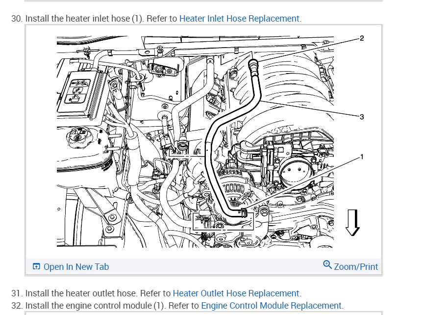

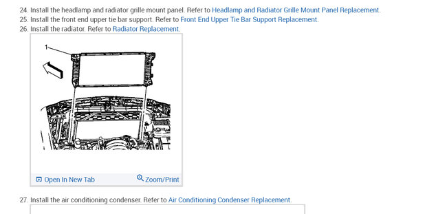

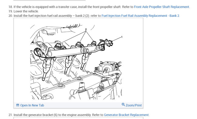

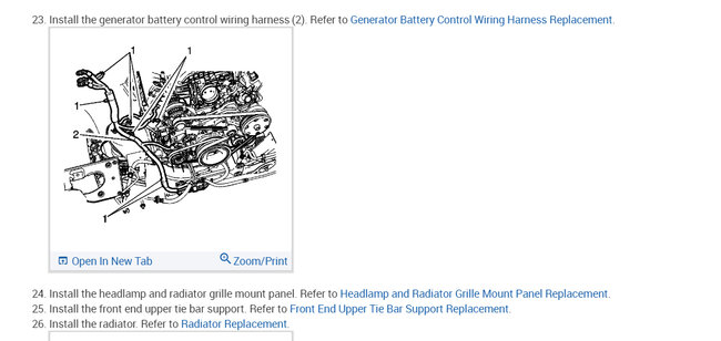

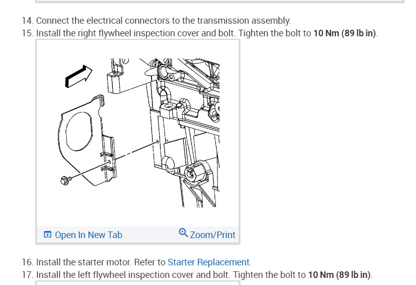

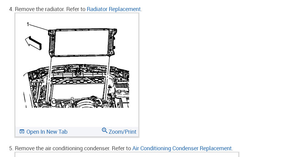

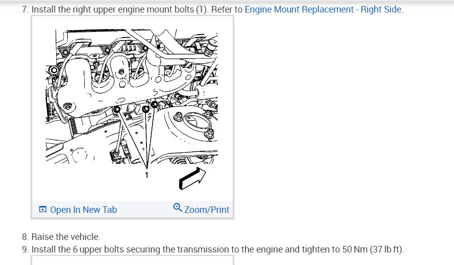

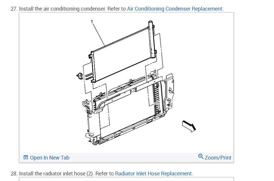

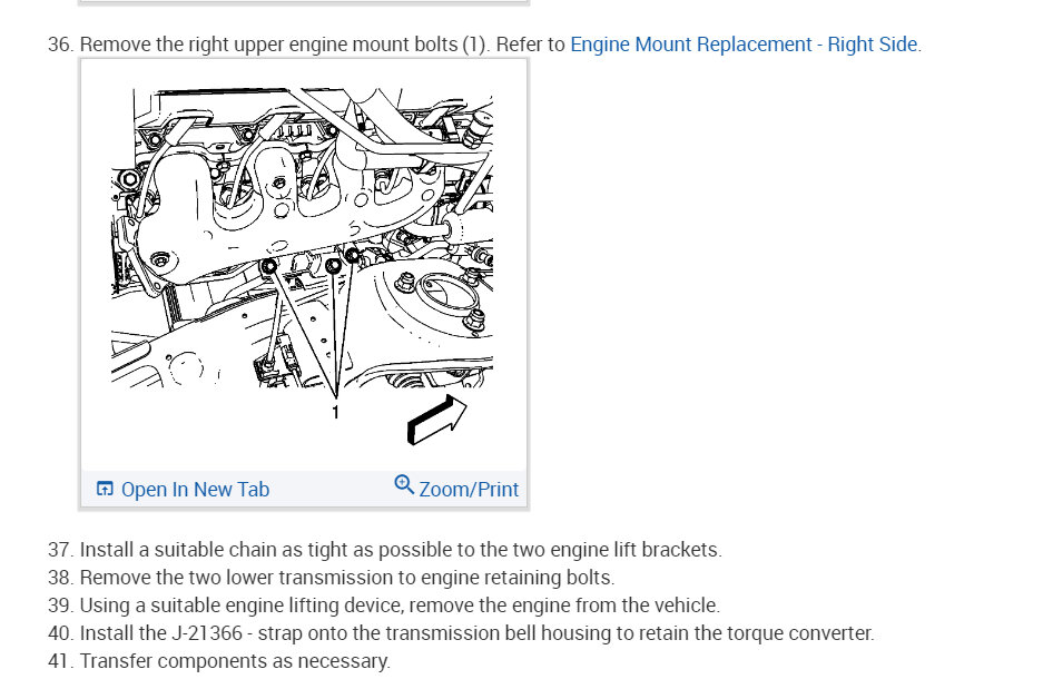

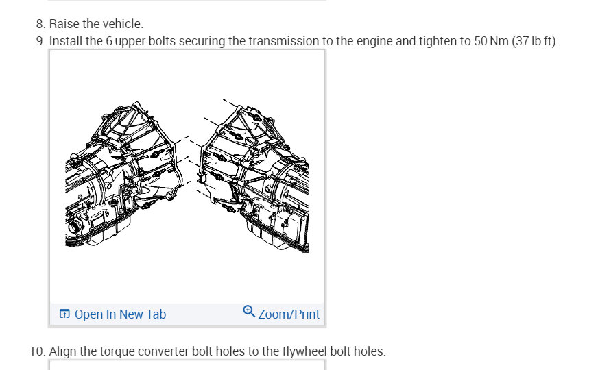

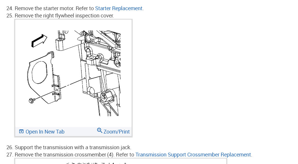

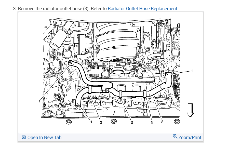

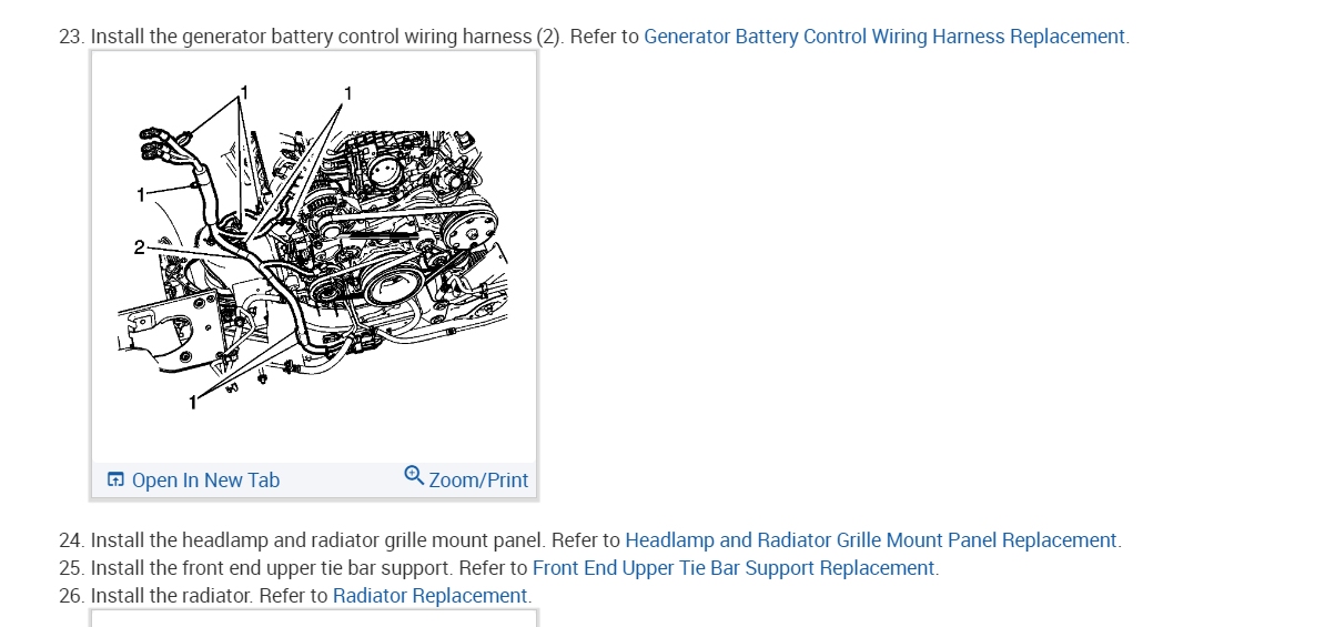

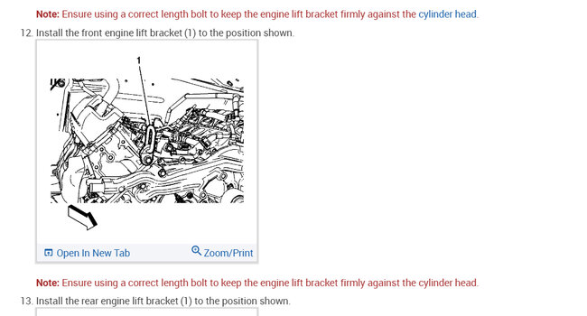

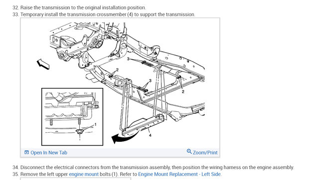

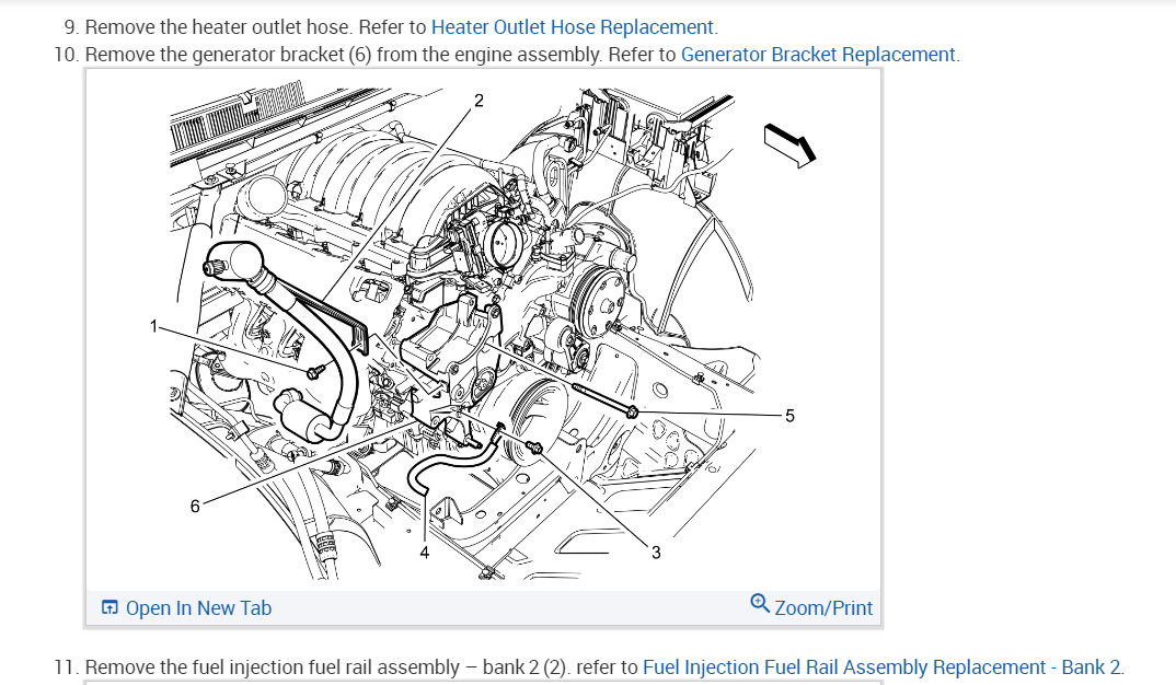

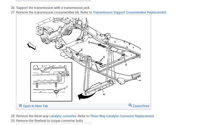

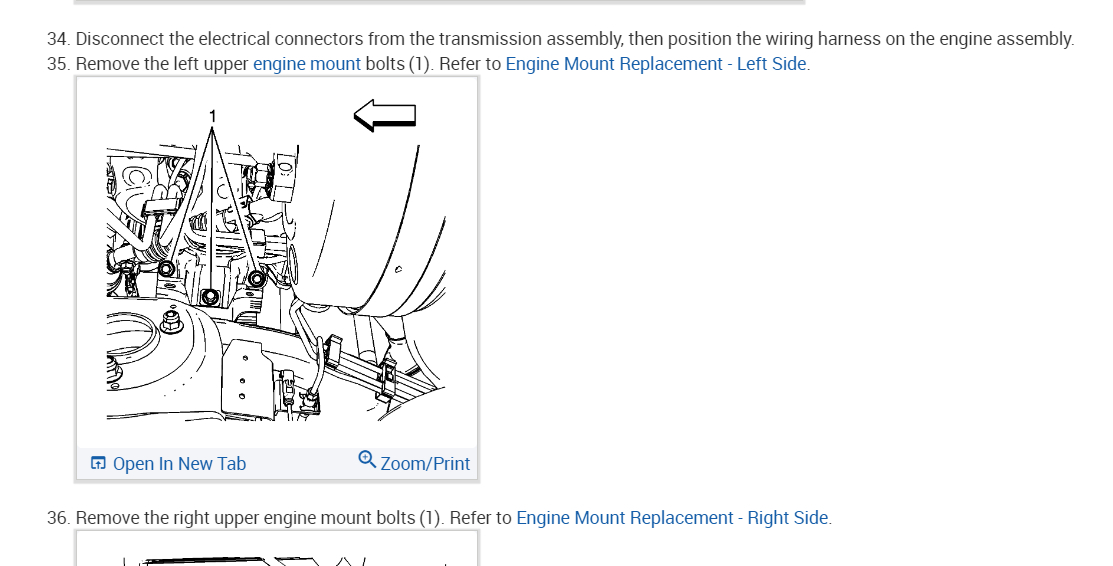

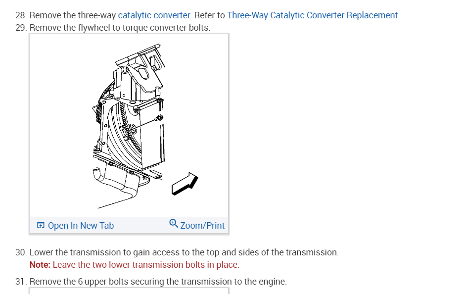

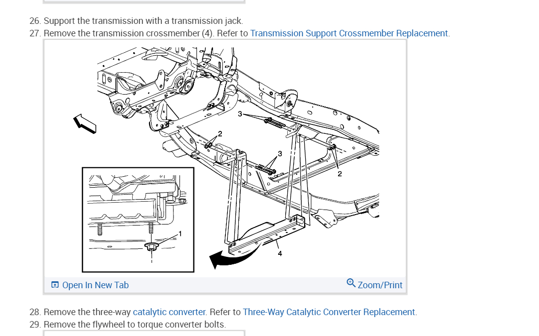

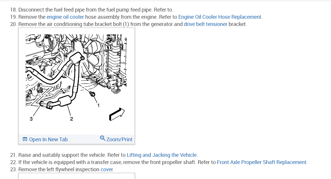

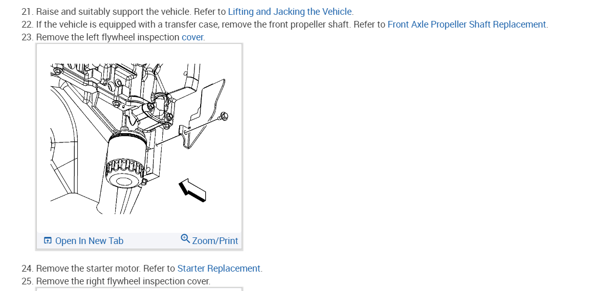

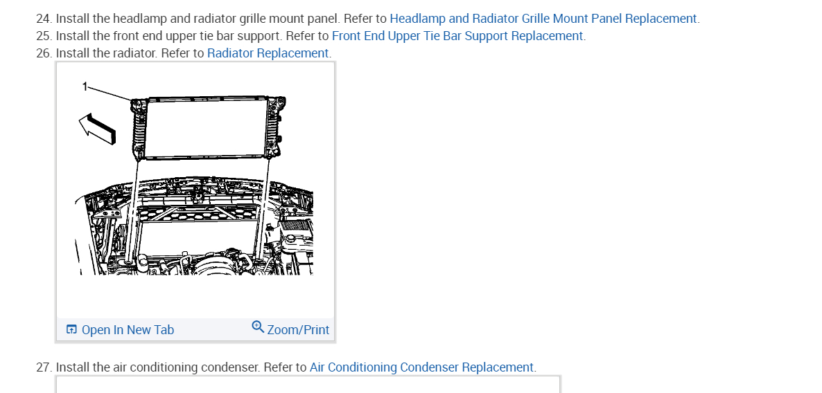

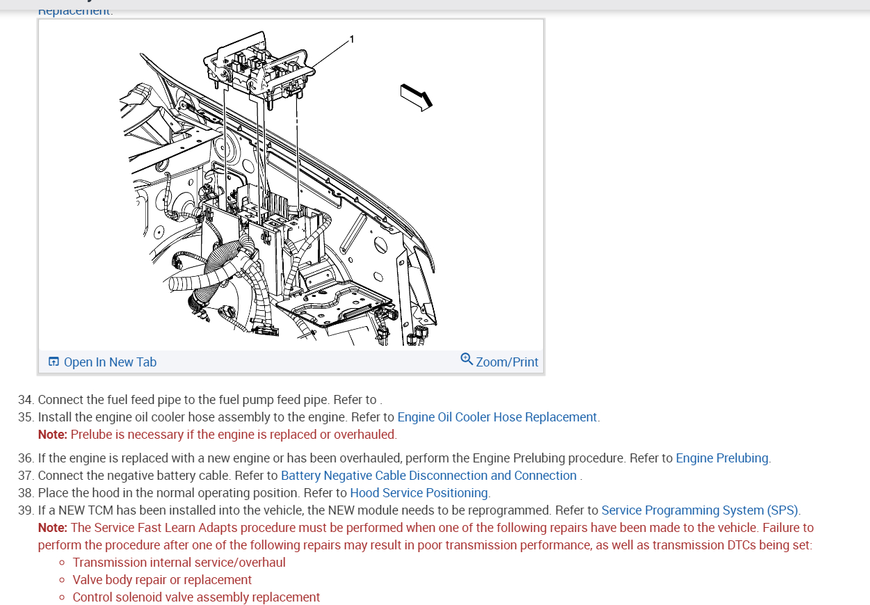

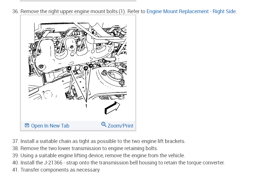

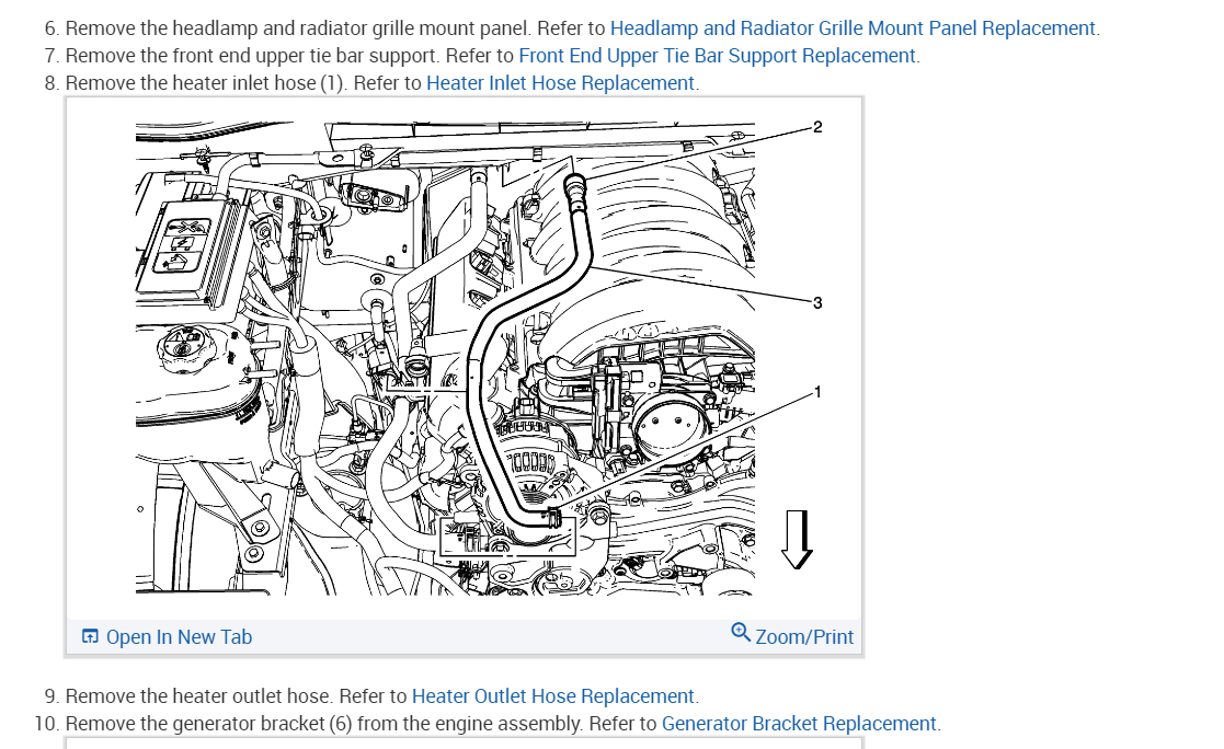

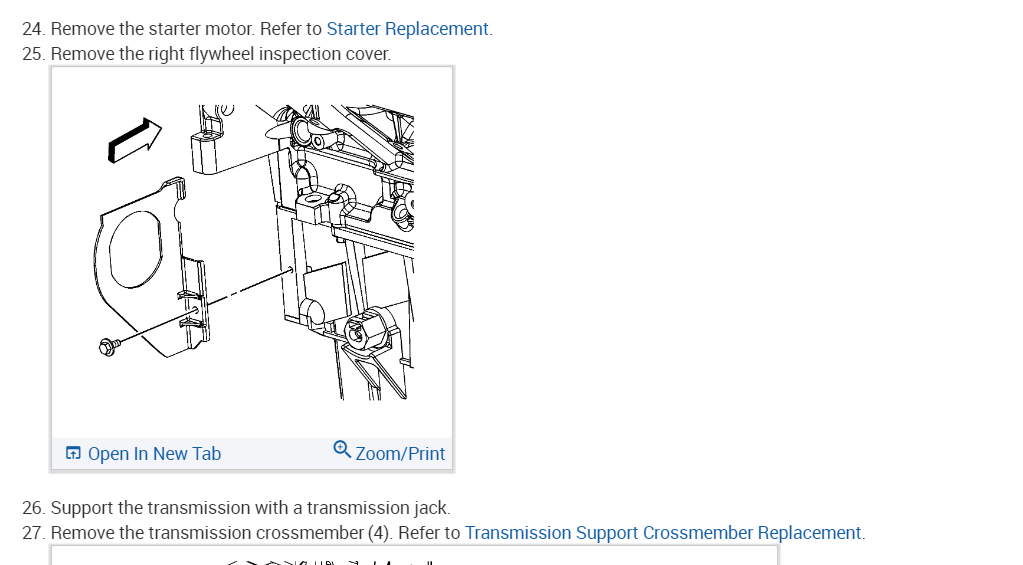

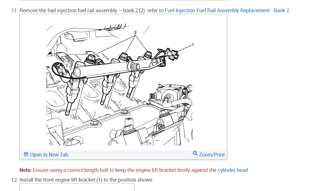

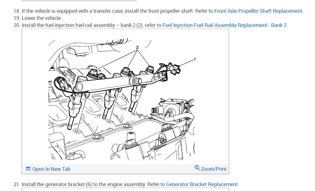

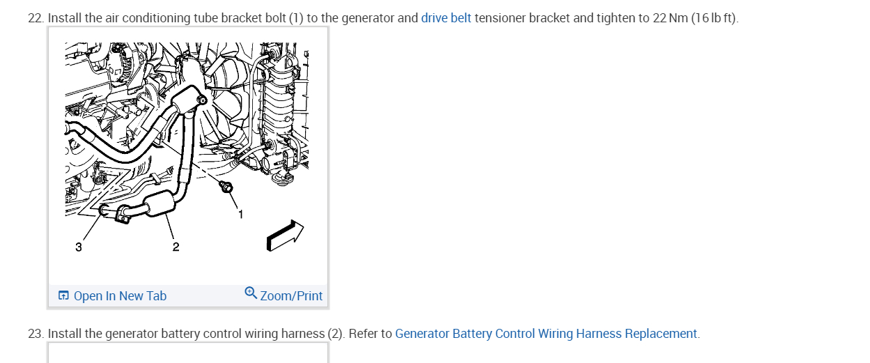

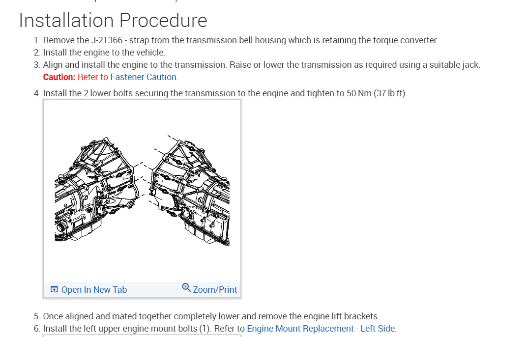

Hi. I have a 2015 Chevrolet Silverado with a V6 4.3 liter engine that needs to be replaced. It has 335,000 km and both lifters and bearings are bad. I’m looking at replacing it with a 4.3 litre out of a 2016 Chev Silverado but I can’t find a procedure. Do you have a step-by-step procedure for changing a 2015 Silverado 4.3 engine? Is it easier to pull the engine and transmission together or is that more difficult? The truck is 4x4. Thank you for your help. It’s very appreciated.
Nov 27, 2022 at 10:35 PM
  • 55,006 POSTS
Yep, you should start by draining the coolant and disconnecting the battery. The AC system will need to be vacuumed down and recharged. This video as well will show you how:
https://youtu.be/4EqdrBVb0sY
Also, if the torque converter slides out of the transmission it will need to be reinstalled or you will damage the front pump and the transmission will not work. This video will show you how.
https://youtu.be/ZC7xHVMKLRw

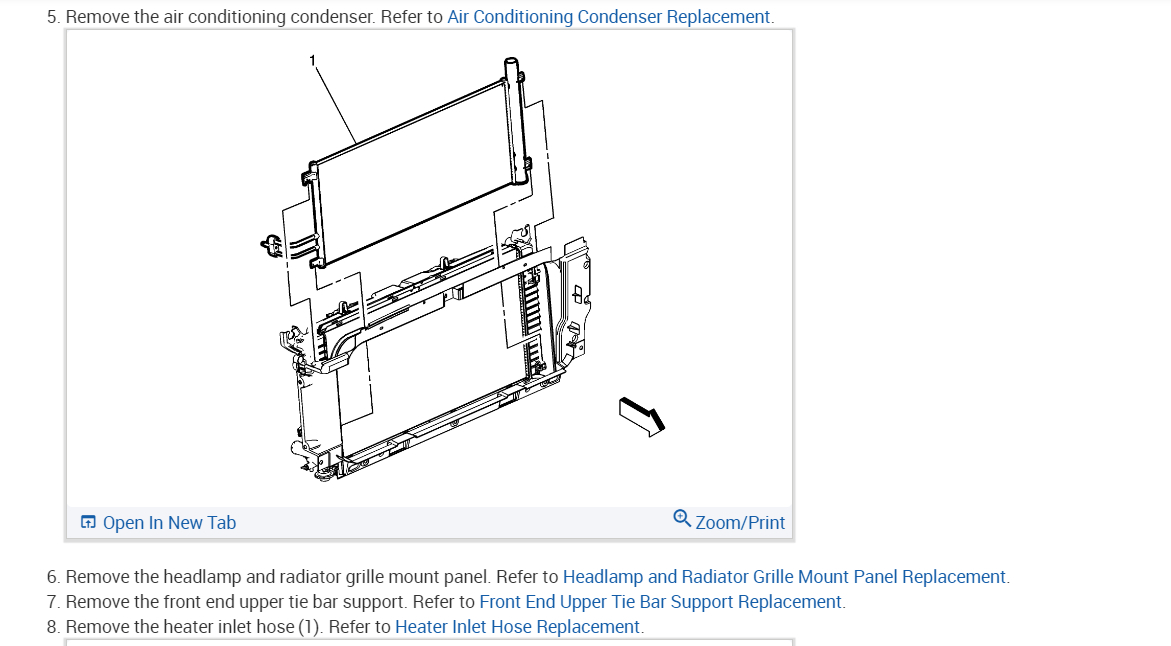

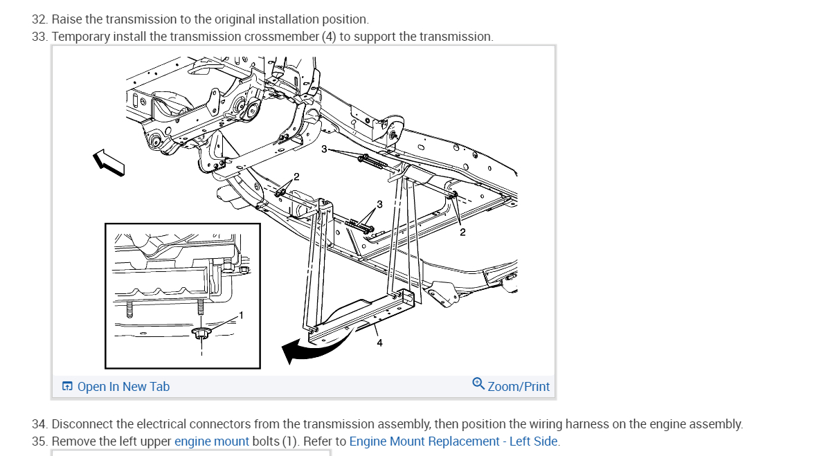

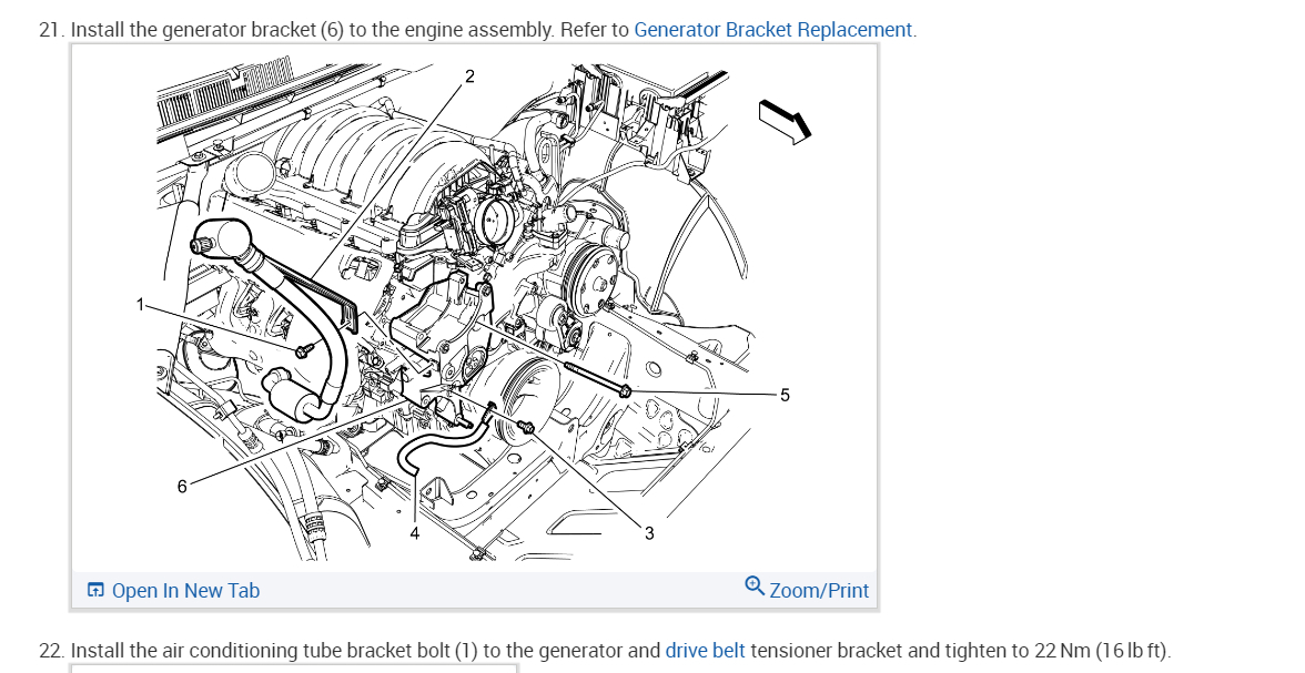

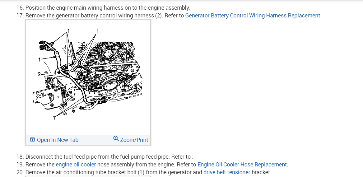

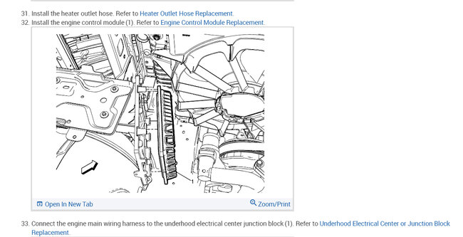

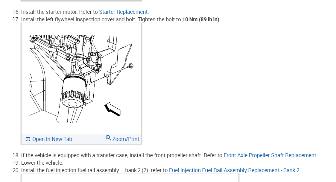

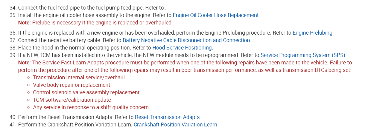

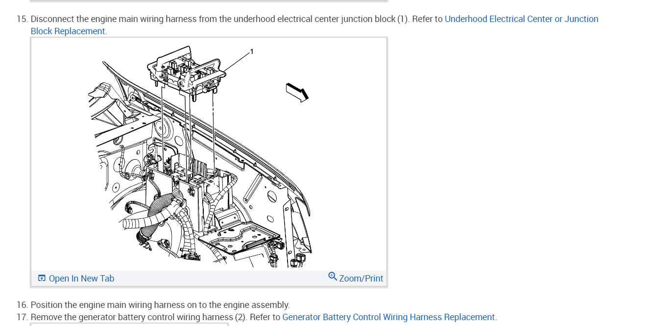

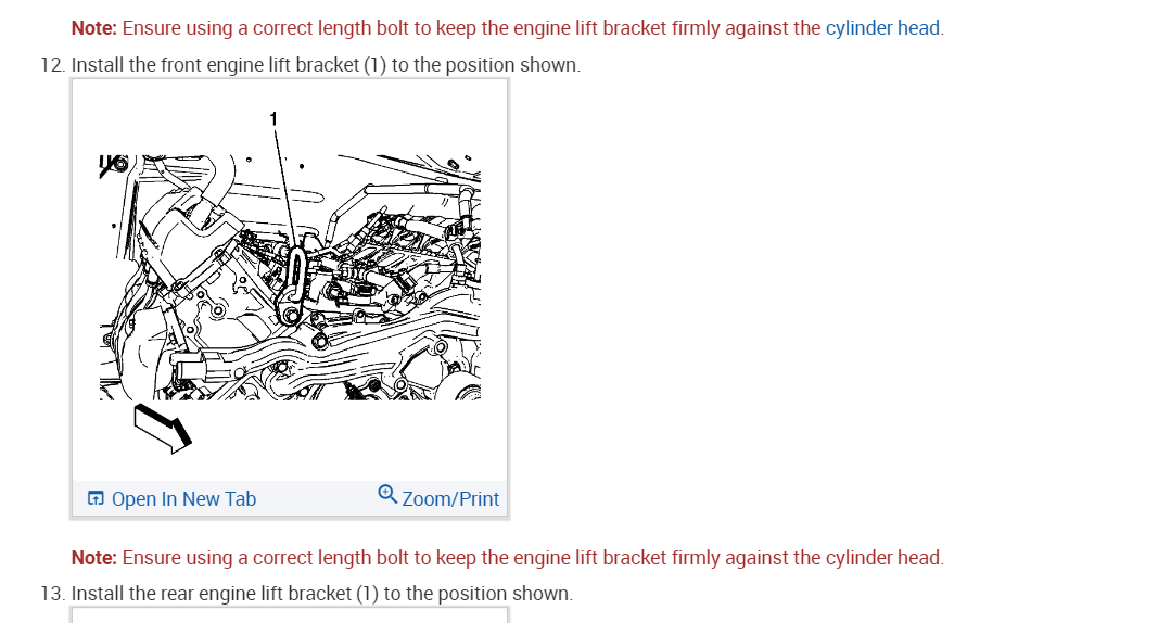

Here are the step-by-step engine removal and installation instructions including torque specs in the diagrams below. Check out the images (below). Please let us know if you need anything else to get the problem fixed.
